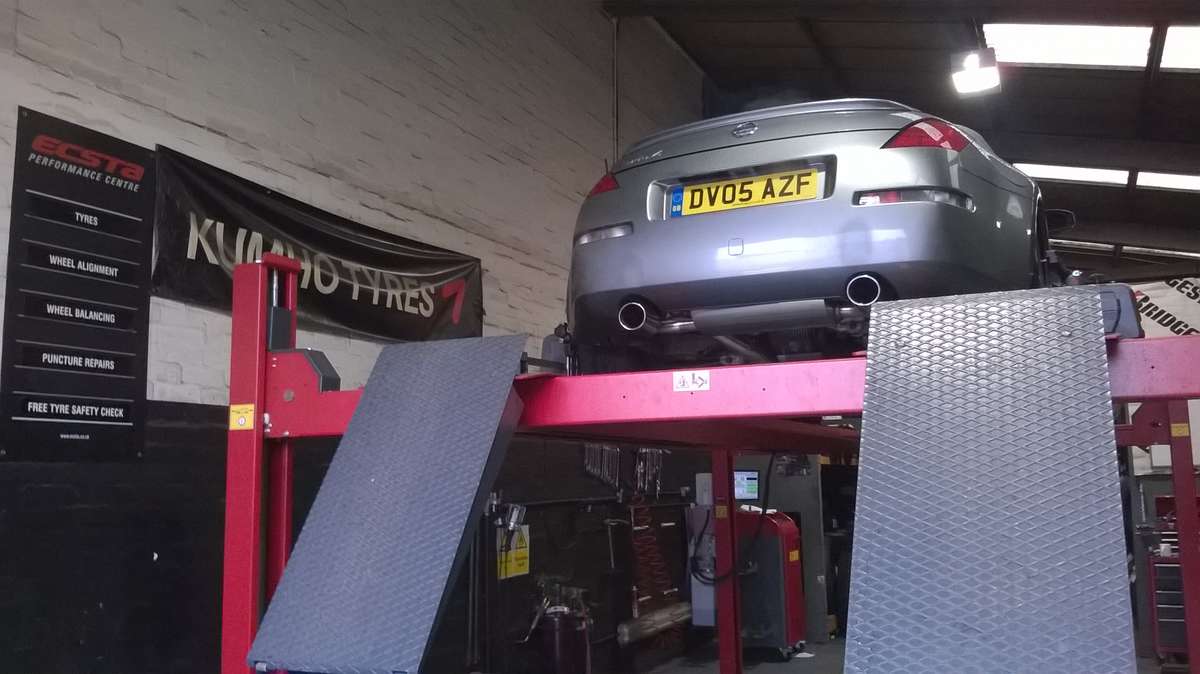

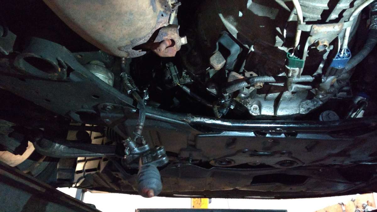

Couple weeks ago I bought a new unused OE clutch slave cylinder and braided line from forum member Dale. Reading up replacements can be a pain to bleed up, so to side step the hassle I booked the car into a garage for repairs. The fitting took 20mins on a 4 poster ramp but he did struggle to then bleed the system. Then after 45mins he got the pedal back in a fashion enough to get gears and drive, but the last inch would kick up after each use.
Mechanic then said that's the best I can do for now and it'll get better on the way home. Thought great I've heard that before, hell I've said that myself in the past lol that same evening went out to get fuel, started it up and no gears!!! Great. Had our brother round that same evening to help bleed the system ourselves. After an hour trying to do the job on axle stands the pedal was no good. The line down to the slave cylinder was good, but I couldn't seem to extract the air from the cylinder itself.
Called it a night and then didn't use the car for a week. Planned road trip for the Easter bank holiday meant I couldn't take the 350z, so made use of the brother in law's RX8 to Aberystwyth - surprisingly did 340 miles to a tank!!!
Came back after a fab time and began to search around for tips on how to bleed the system. Then had the idea that if I'm struggling mainly with the slave itself, why not prime the cylinder prior to fitting? So tried this, offered it up and it worked first time. Great pedal straight away, the line is good and now the cylinder too.
It's been 4 days now and still working good.

I'd recommend they bleed the system as normal, if there's any struggle remove and prime the cylinder. I looked high and low for bleeding tips, nothing came up.
Definitely get a braided line too if not already planning too. The clutch pedal feel was my biggest gripe with my car, irregular and after a long drive or stop/start traffic it would get worst. Now it's sooooo nice and smooth. Really has improved the drive of the car.
