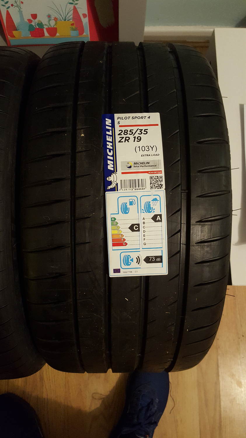

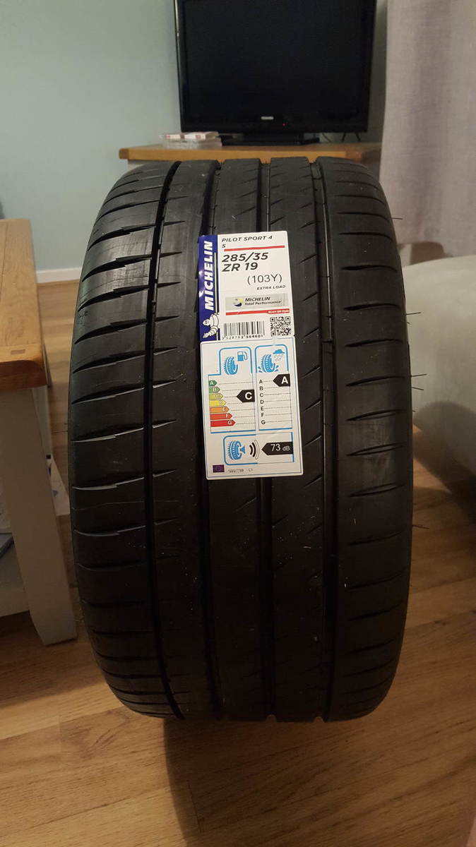

nissanman312 Posted October 6, 2017 Author Posted October 6, 2017 (edited) So no new mods to report But I did get some of the latest greatest tyres today mps4s I went with 255/35/19 fronts and 285/35/19 rears as advised by dan to get near to stock tolerance and be able to run the ps4s From all the reviews I have watched/read mpss Is close to mps4 on dry grip but leagues apart when it comes to wet grip! So that sealed the deal for me Edited October 6, 2017 by nissanman312 1 Quote
Stutopia Posted October 6, 2017 Posted October 6, 2017 Nice choice, might finally tame that back end Quote
davey_83 Posted October 6, 2017 Posted October 6, 2017 Crazy that road sports cars have these on the front axle!!! Madness Quote
nissanman312 Posted October 6, 2017 Author Posted October 6, 2017 38 minutes ago, SuperStu said: Nice choice, might finally tame that back end Let's hope so mate Quote
