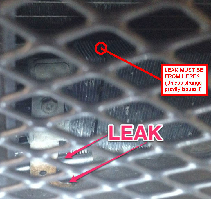

Went to do the MOT today and get the Road Tax done, car passed with no problems, but we found some oil / power steering fluid leaking from the little radiator at the front. The garage did not have enough time to look at it today as they've closed 12:00, but is this something common, maybe caused by corriosion?
I've noticed the fluid level dropped down a bit, I guess it's related to that. I'll try to take a picture of the leak and post here in the next minutes.

Hi Colin,
I've checked, it's definetelly coming from the radiator, everything above it's dry...
Will check again when I will be replacing it tomorrow.
Thanks!
Given that is pic taken from under the car and looking at the staining, the crack must be at the top then - see pic
- or is the leak dropping onto those cooling fins from somewhere above?
