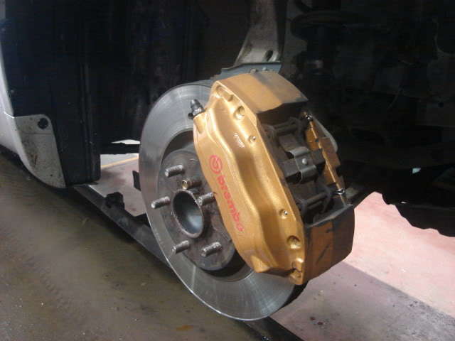

Remove the front wheel. (21mm Socket and a torque setting of 108Nm, I wrap the socket in masking tape to save it from marking the alloy inside the nut holes).
Removing the pads

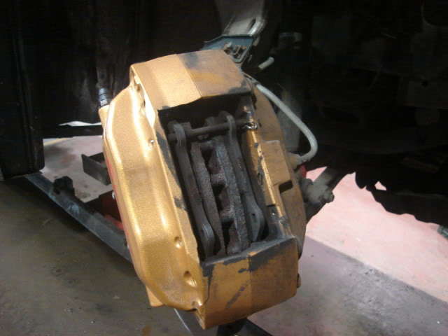

Locate the securing K pins on the pads retainer pins...
With the K pins removed, get a punch or correct size item and remove the lower pad retainer pin..The anti vibration spring will flick out so go careful...
Now open the bonnet and remove the brake fluid reservoir cap, this will aid when you push the pistons back.
Ok, your caliper should now have now parts other than the pads left in it...I used a screw driver to push the pads back a little then leaved the pads out...remember there may be a lip round the edge of the disk and you have to get the pads over this..

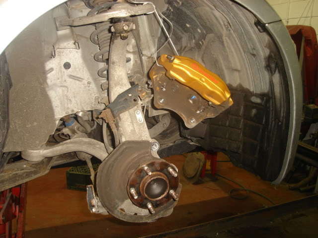

Removing the Brembo caliper.

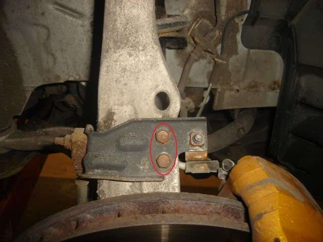

With the pads out the caliper, the disk should be lose on the hub...Just whip the two rear 22mm bolts out to remove the caliper. (torque 152Nm) alex13.jpg.8284d90699a59cec67ec2bc2bf33337e.jpg
I also removed the brake line bracket bolts to make hanging the calliper easier...two 12mm bolts..
