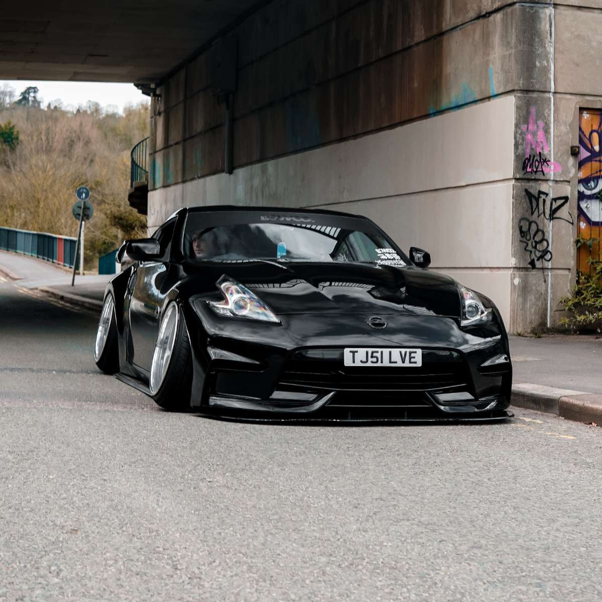

CalvinPomfret Posted March 23, 2021 Posted March 23, 2021 Hey Everyone, Been thinking for a while about relocating my number plate from the stock plate holder, to somewhere else which is detachable (only for photos - it looks way cleaner). I’ve seen a few suggestions online: - Magnetic Plates - Relocating to a Tow-Bar Bracket Wondered if any of you have done these or have any other suggestions of where to place it? Pics would be a huge help 😬 Cheers, Calv Quote

Silverthorn Posted March 24, 2021 Posted March 24, 2021 @CalvinPomfret This is the only photo I have of the backside of the bumper. The tape was only a temporary measure as i had previously superglued the magnets on but over time they began to fall off. I've since bonded them on with epoxy and have had no issues since. I also have a slightly smaller than usual import plate on the front as I found it fit the bumper better. A typical UK plate is 520mm x 111mm, whereas mine is 408mm x 87mm. 1 Quote
CalvinPomfret Posted March 24, 2021 Author Posted March 24, 2021 23 minutes ago, Silverthorn said: @CalvinPomfret This is the only photo I have of the backside of the bumper. The tape was only a temporary measure as i had previously superglued the magnets on but over time they began to fall off. I've since bonded them on with epoxy and have had no issues since. I also have a slightly smaller than usual import plate on the front as I found it fit the bumper better. A typical UK plate is 520mm x 111mm, whereas mine is 408mm x 87mm. Legend for this bro - Z is looking clean as hell! Where’d you get the plate made up? This is defo the avenue I’m going to go down for plate fitment Quote
Silverthorn Posted March 24, 2021 Posted March 24, 2021 (edited) @CalvinPomfret I had the plate made by JDMPlates. They're a little bit pricey (I think i paid about £35 or so for just the front plate in their 3D Gel), but definitely worth it imo. It's the only place I've managed to find that offers Gel Resin plates in non-standard sizes. And cheers! Edited March 24, 2021 by Silverthorn 1 Quote

Silverthorn Posted March 25, 2021 Posted March 25, 2021 (edited) @GranTurismoEra I've used the Neodymium discs, 12mm diameter & 3mm thick. I have about 12 of these on the plate and the same on the backside of the bumper. And yes, Epoxy Resin to secure them. Edited March 25, 2021 by Silverthorn 1 Quote
