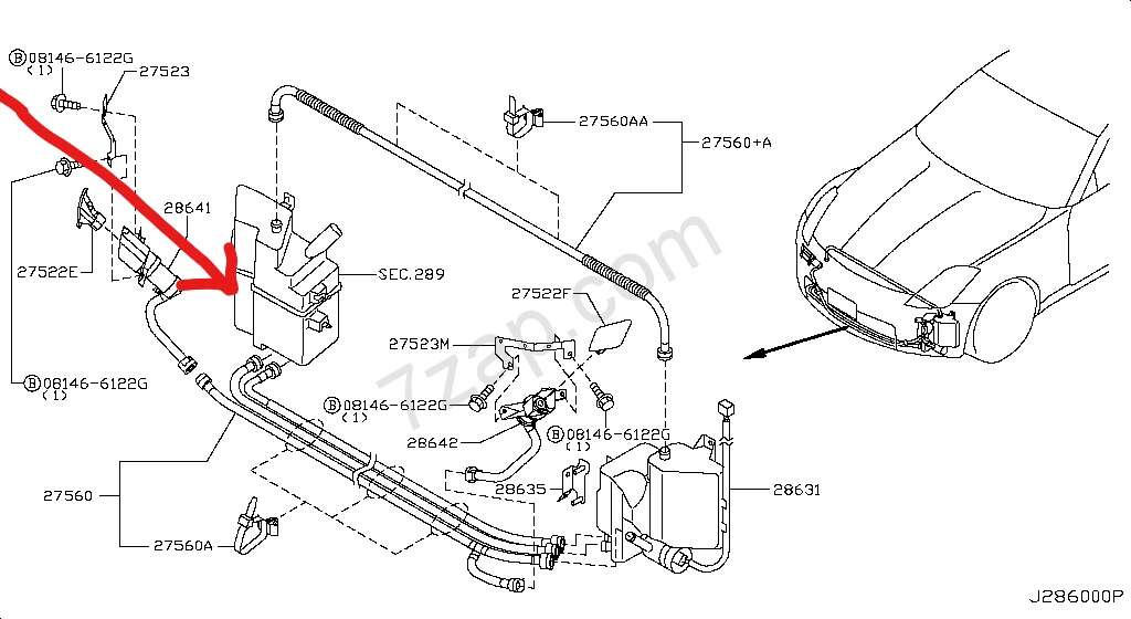

KCook Posted June 11, 2020 Author Posted June 11, 2020 1 hour ago, ZMANALEX said: Jee whizz thanks for this....my son (marine mechanic apprentice) will love this.... Is part 28641 and 27522E the headlamp washer unit.....? Quote
KCook Posted June 11, 2020 Author Posted June 11, 2020 so...for this washer malarky issue....i get there are 2 reservoirs and one filler cap.... My windscreen wipers and washer fluid are working fine..... My rear wiper arm is fine...but no washer fluid pumped Headlamp washers dead as a dodo Are there two pumps considering that the windscreen washers are fine ?...if so what pump does the headlamps and rear washer...? (I did say on my intro I was a no mechanical wizard...) Quote
ZMANALEX Posted June 11, 2020 Posted June 11, 2020 The front windscreen pump is in the O/S reservoir. The rear windscreen pump is in the O/S reservoir The headlamp washer pump is in the N/S reservoir. First thing to do is check your fuses etc and then you will have to get your multi meter out and check for feed to the pumps. there are 3 fuse boxes: 1 is inside the O/S/F footwell. 1 is beside the battery 1 is within the IPDM unit under the scuttle on the N/S/F behind the battery. Easier to check the feeds to the pumps with the bumper off. 1 Quote
ZMANALEX Posted June 11, 2020 Posted June 11, 2020 The 2 x windscreen pumps are on the rear of this reservoir at the bottom: Quote
