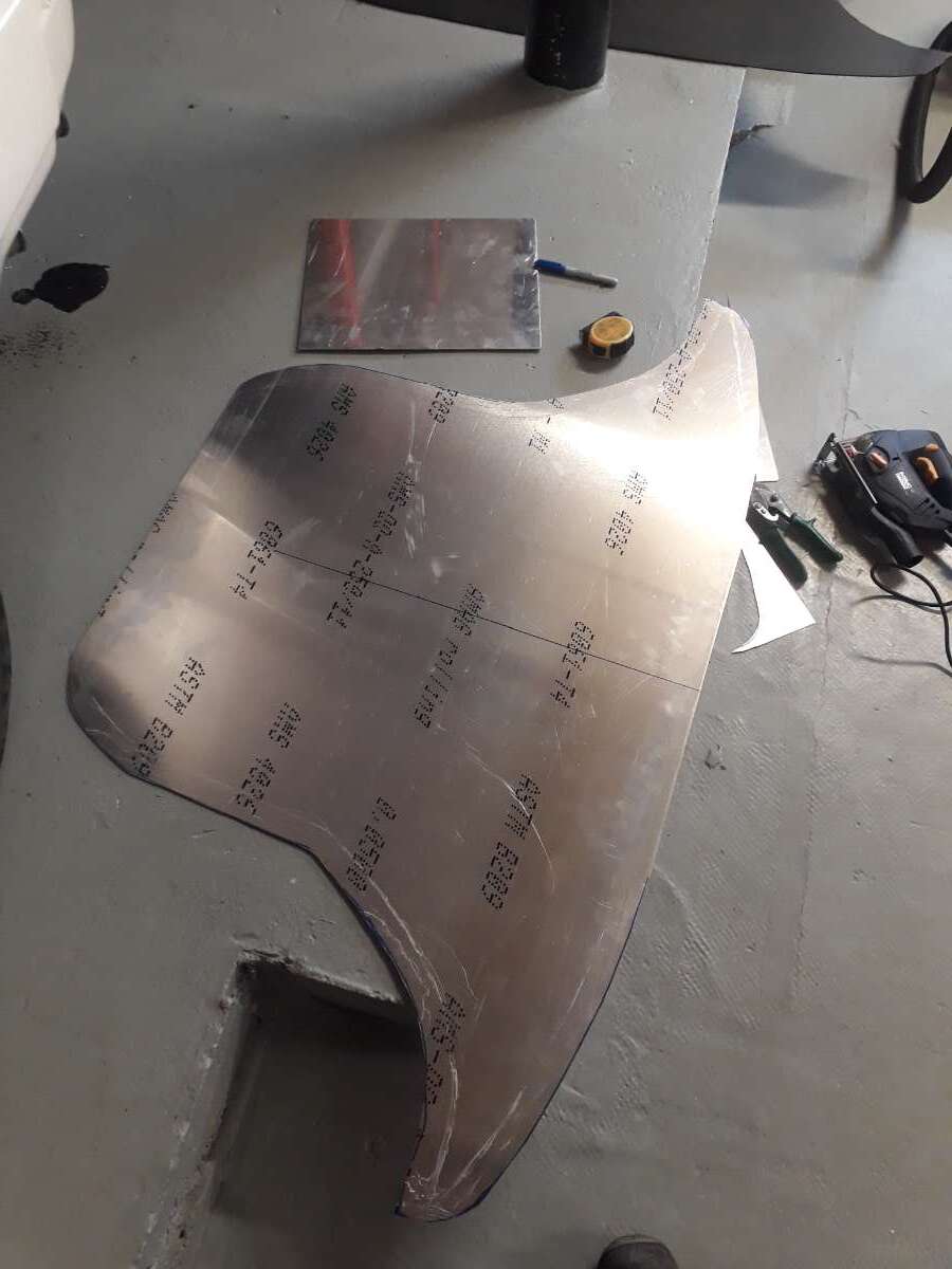

Got my transmission cooler on the low pressure return from the rack, bled it out and just need to mod my bash guard/undertray as I've lost some fixings, so going to use stainless rivnuts to make sure it's nice and solid.
Then it's Mallory : )
