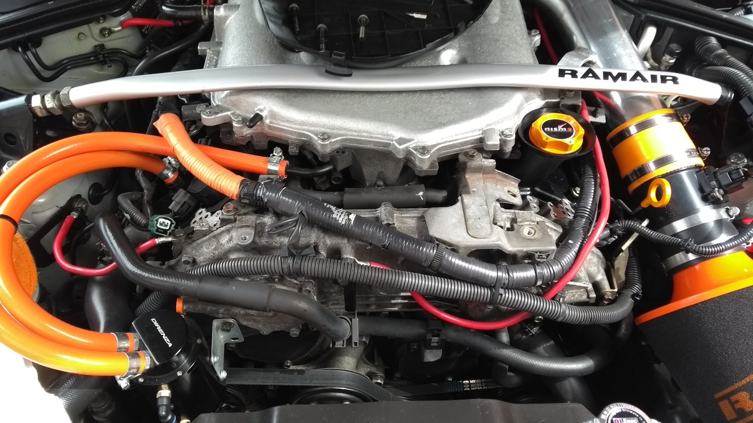

Hi Dave,
quick question about your Oil catch can install.
did you have to make up a specific braket to fit it where it is, and if you did, what bolt did you fix it to.....great install by the way, love the orange pipework!!

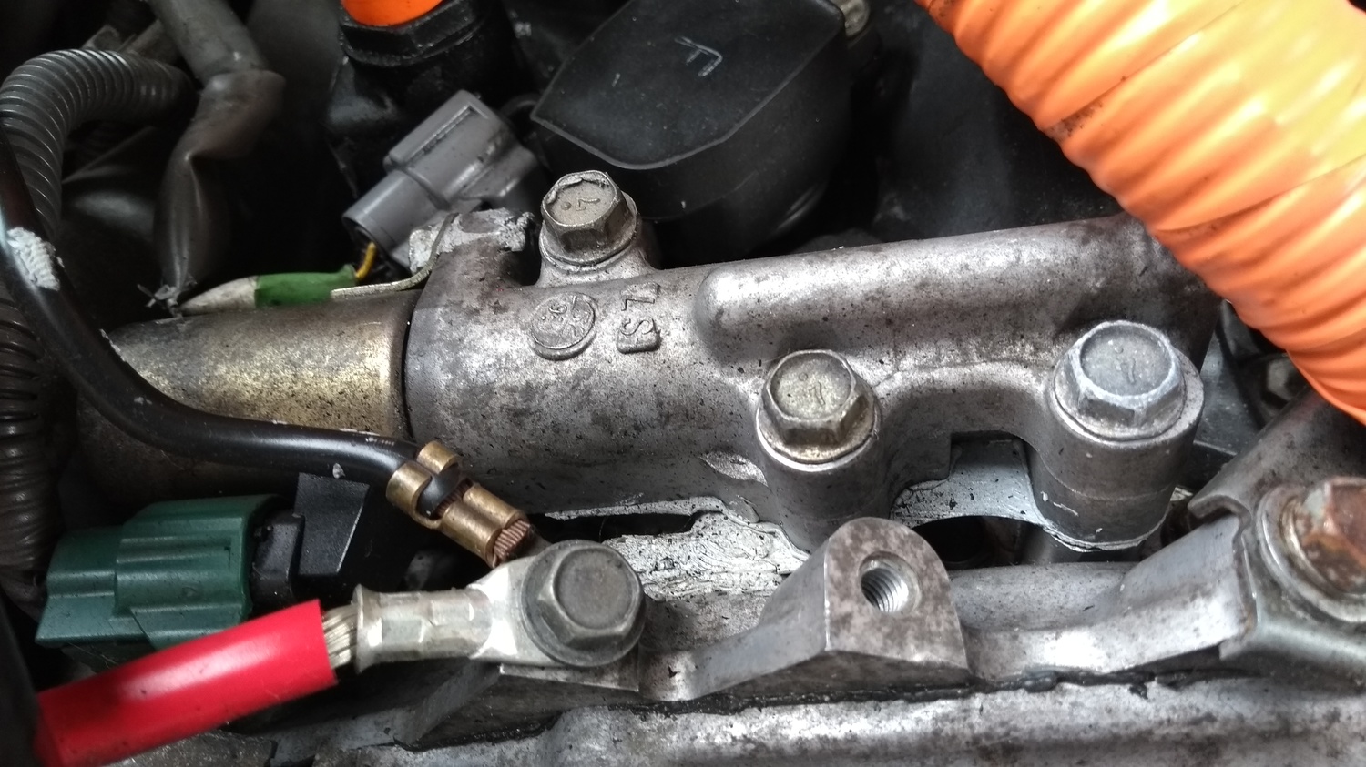

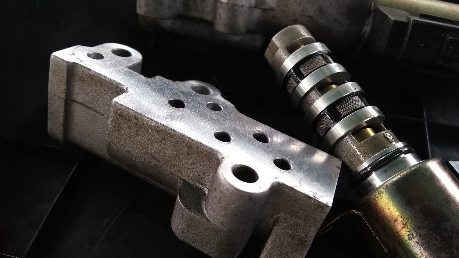

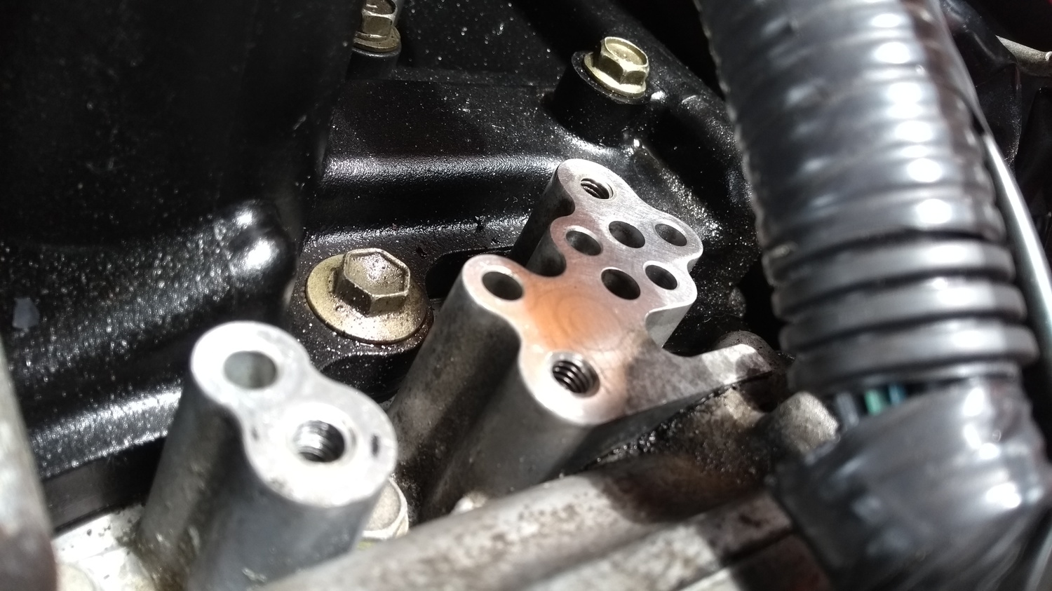

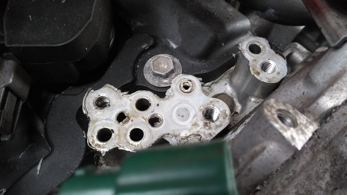

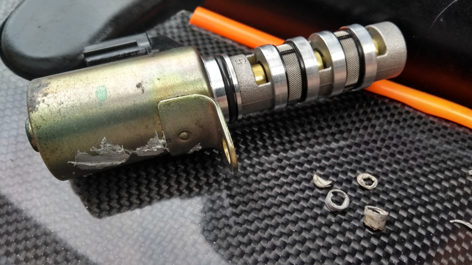

Time for some well needed maintenance, in relation to engine health. From day one of ownership very nearly 2 years ago, it's always had a slight hesitation on idle once warm and when rolling on/off light throttle again a hesitation.
Through swapping out intakes I've changed the MAF, no difference at all. Cleaned out and freed up the PCB valve as good practice still no difference. On the the VVT solenoids and after almost 80k, couldn't do any harm with a freshen up. From here il let the pictures do the talking :dry:
Thought ok, that's not meant to look like this. Definitely a worth while investigation as no doubt the partially block solenoid ports will be having an adverse effect on not only engine smooth running, efficiency but performance also.
Cleaned and tested both solenoids, working at least from what I can gather.
Clean up pictures, note also some sealant inside bank 1 solenoid too ffs. As you can imagine the engine feels noticeably better for it and the idle is now bang on!!!! Not driven it a great deal, but the light throttle matter in thr higher gears is nowhere to be seen either - result.

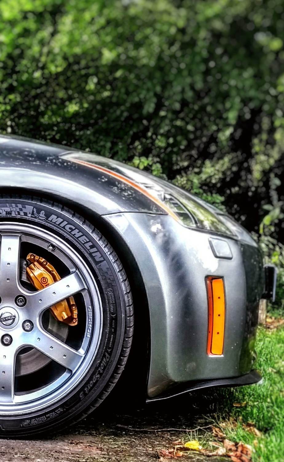

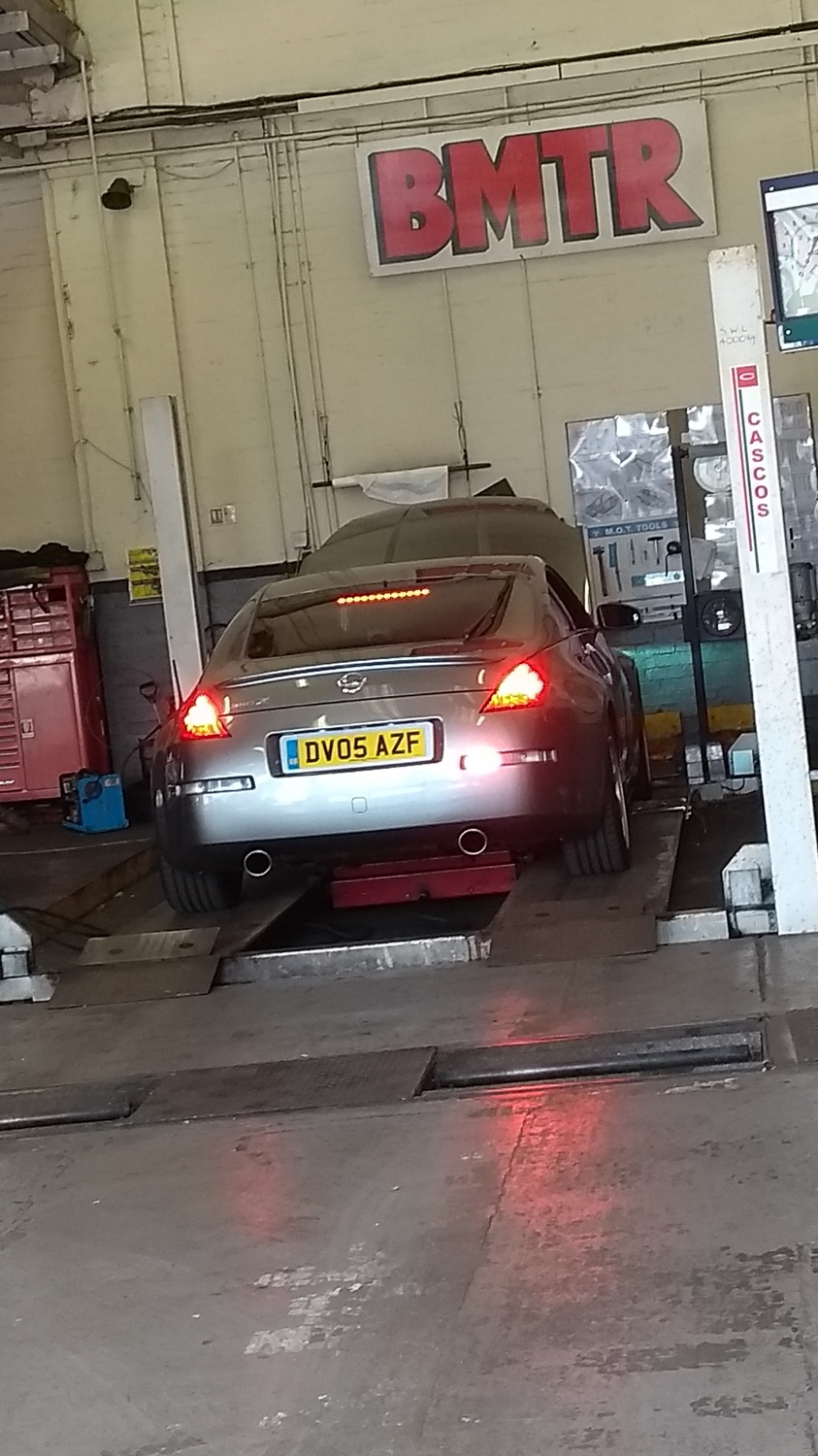

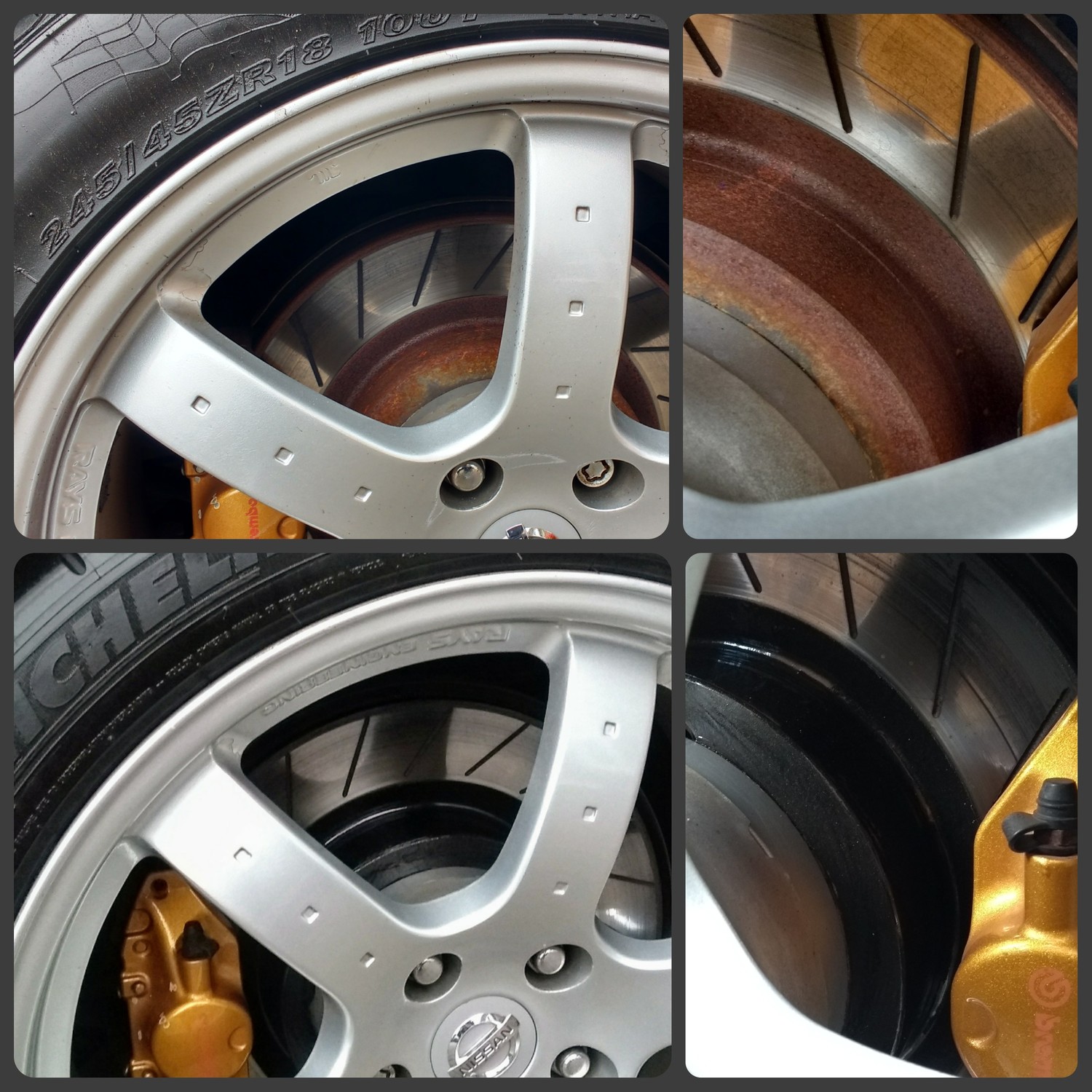

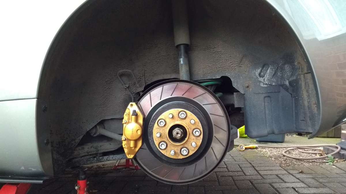

That time of year again for its MOT, booked the day before Japanese Performance Show so wanted to tart up some rust, lights and levels check the norm really.
W brace and discs hubs painted with black hammerite. Should have done the brakes yonks ago, such simple yet effective task.
Was about the right time to switch out my Nexen N8000 rears, for some Michelin Pilot Super Sports also.
MOT straight PASS then layer home for a couple hours of pre car show grooming.

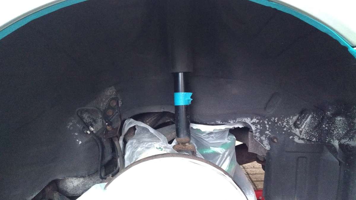

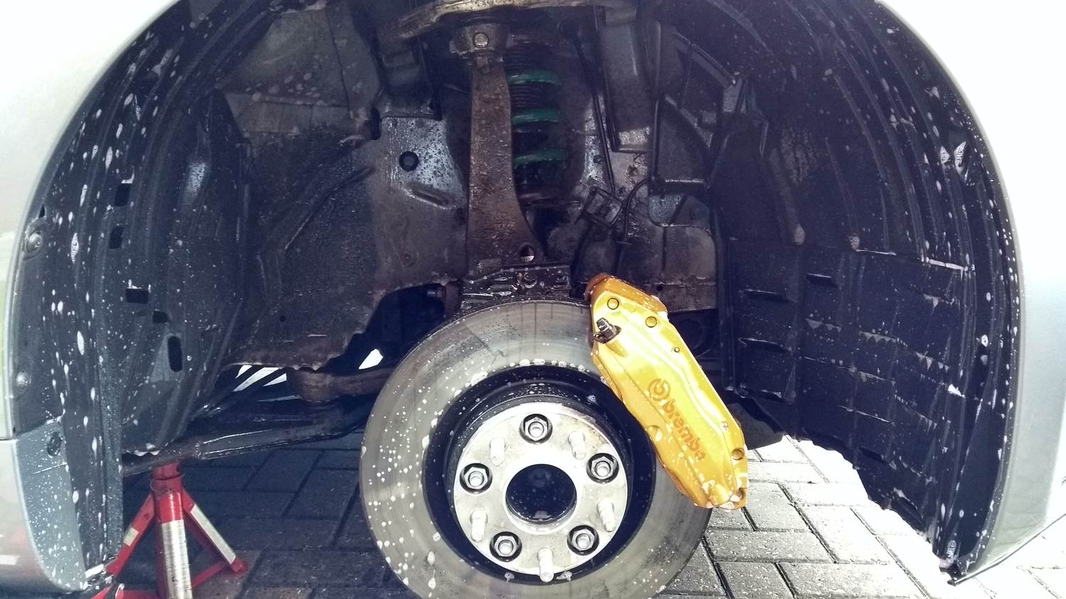

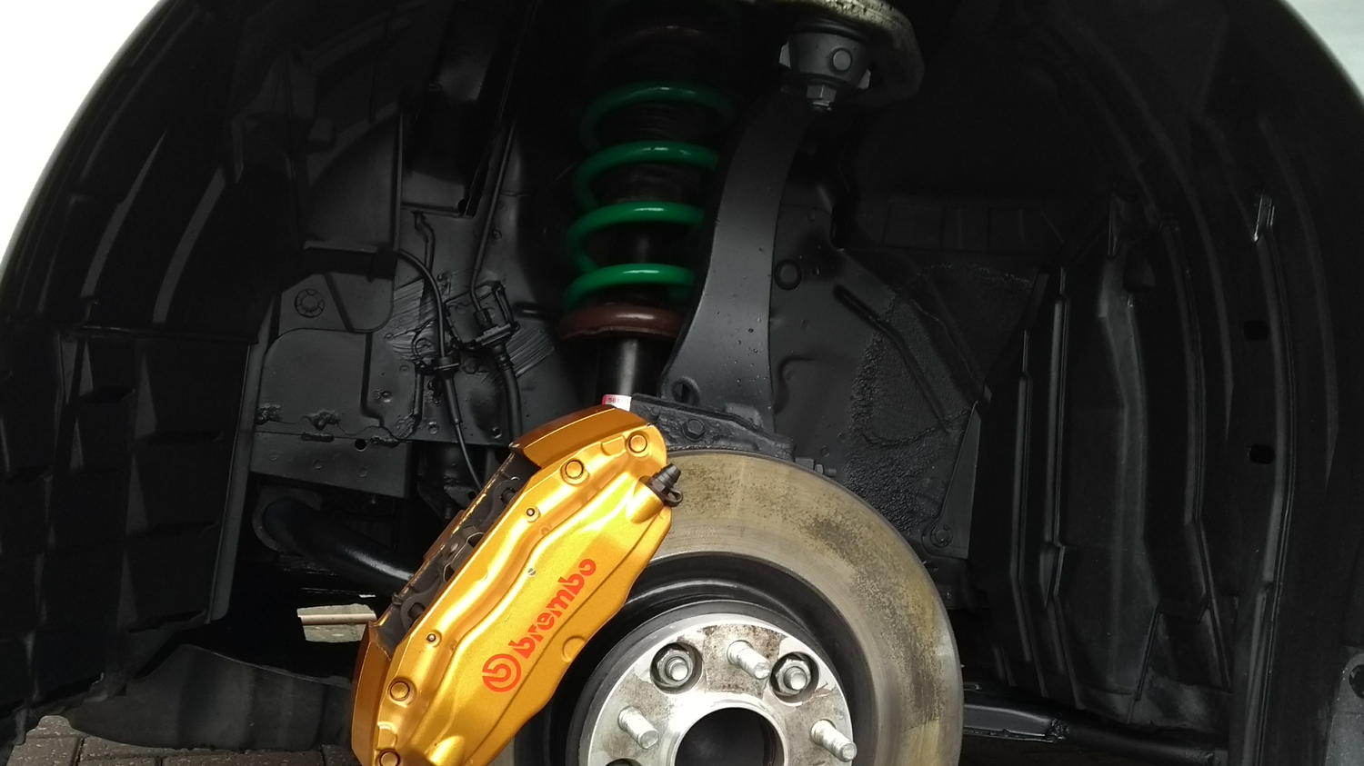

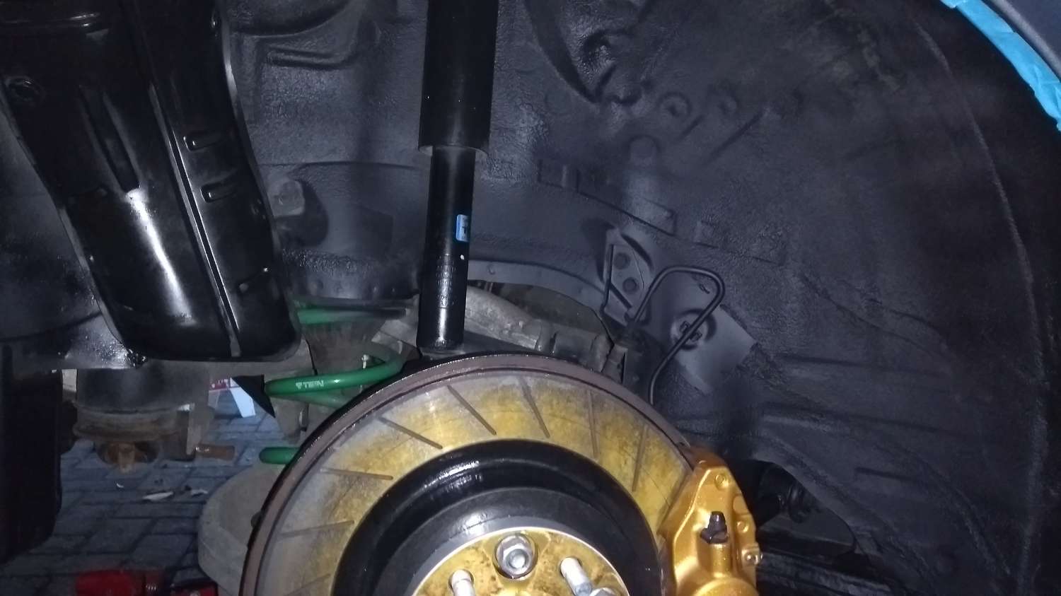

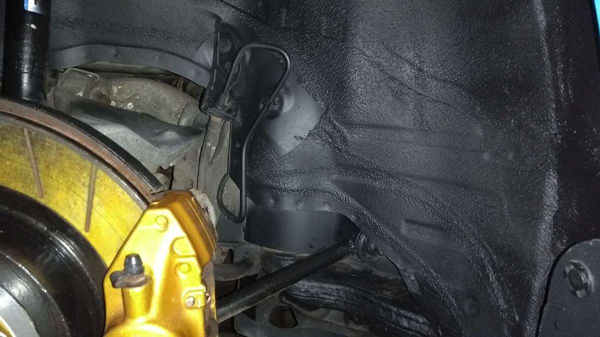

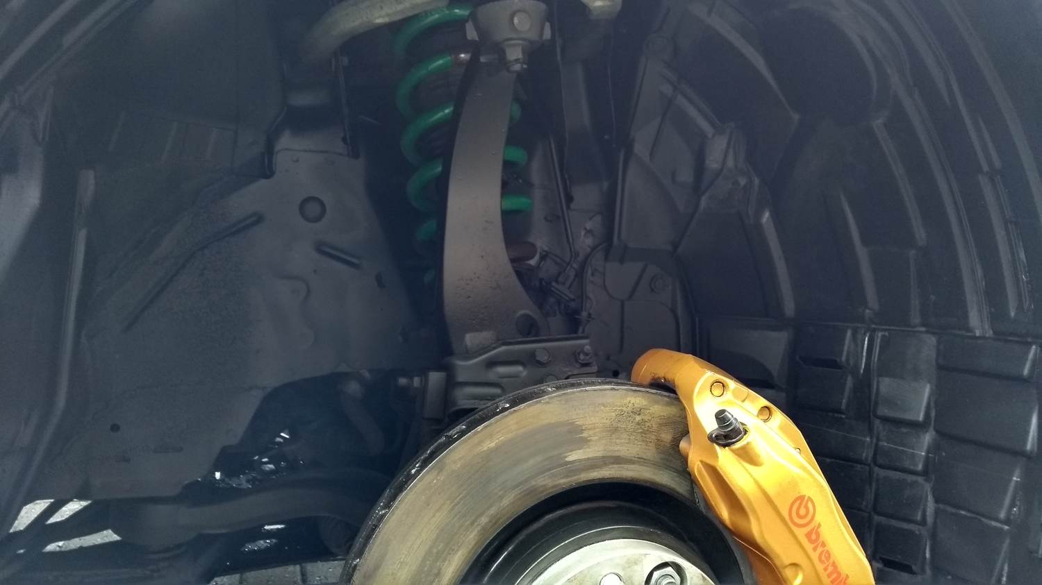

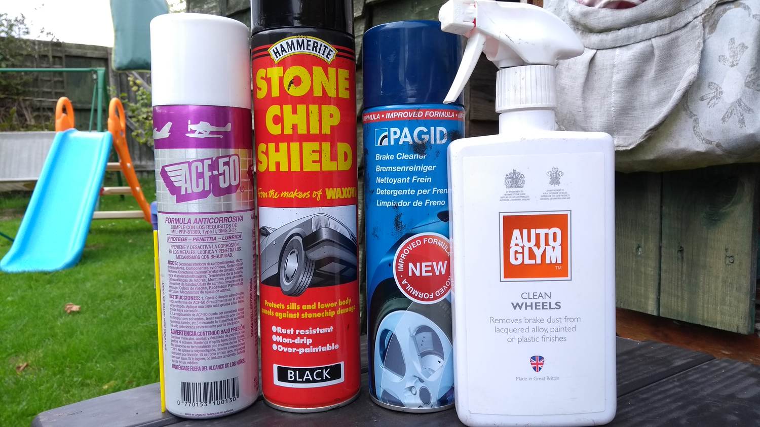

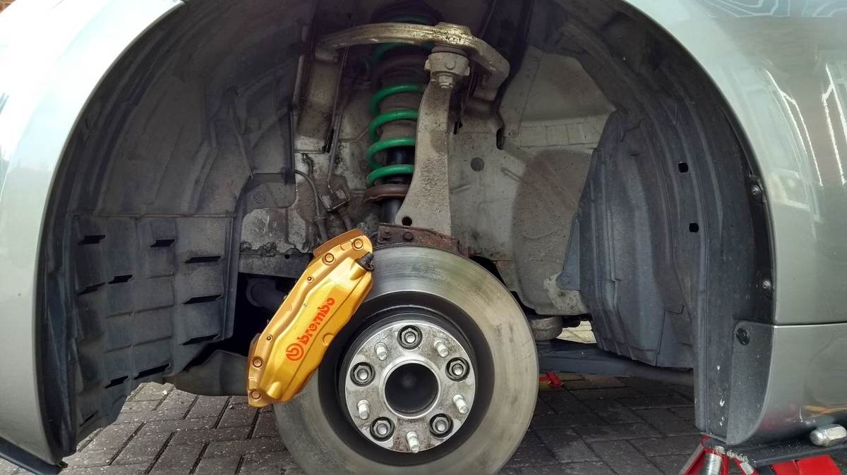

Following on from the winter prep thread, today I tackled the front wheel arches. Chassis wise there's a lack of underseal from factory and I'd be looking to address the matter.
Used a combination of Bilberry and AG wheel cleaners, Daisy APC, various scrubbing brushes, mf towels, Hammerite stone chip, brake cleaner and ACF50.
IMG_20171006_122827654_BURST000_COVER_TOP.thumb.jpg.1615badc3d0ecda58cef7203cc18a572.jpg
Also did the wheels while they were off and like a pro didn't take the all important after picture, huff.
Weekend gone also treated her to a new coat of Soft99 Kiwami ready for the harsher months. Next up the rear arches and subframe.

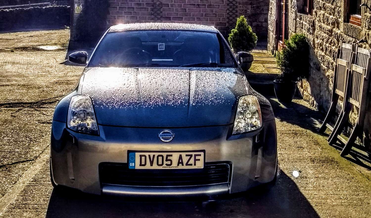

Had a weekend away just me and the Mrs to South Wingfield near the Peak District, few Zed pics needed as per.
Stayed at Park Farm B&B and woke up to a stunning view, wee bit different to what we get in Birmingham.

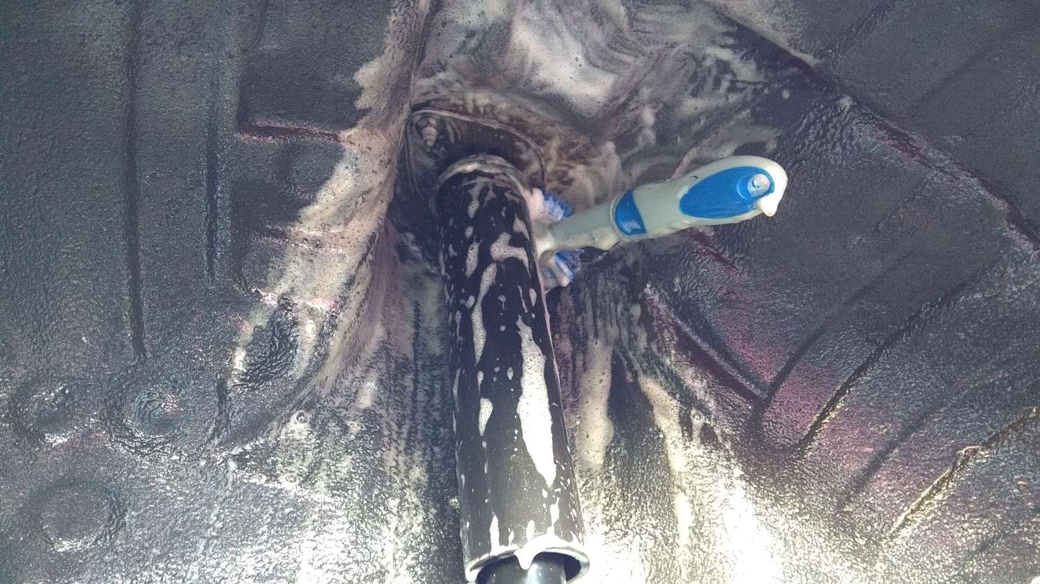

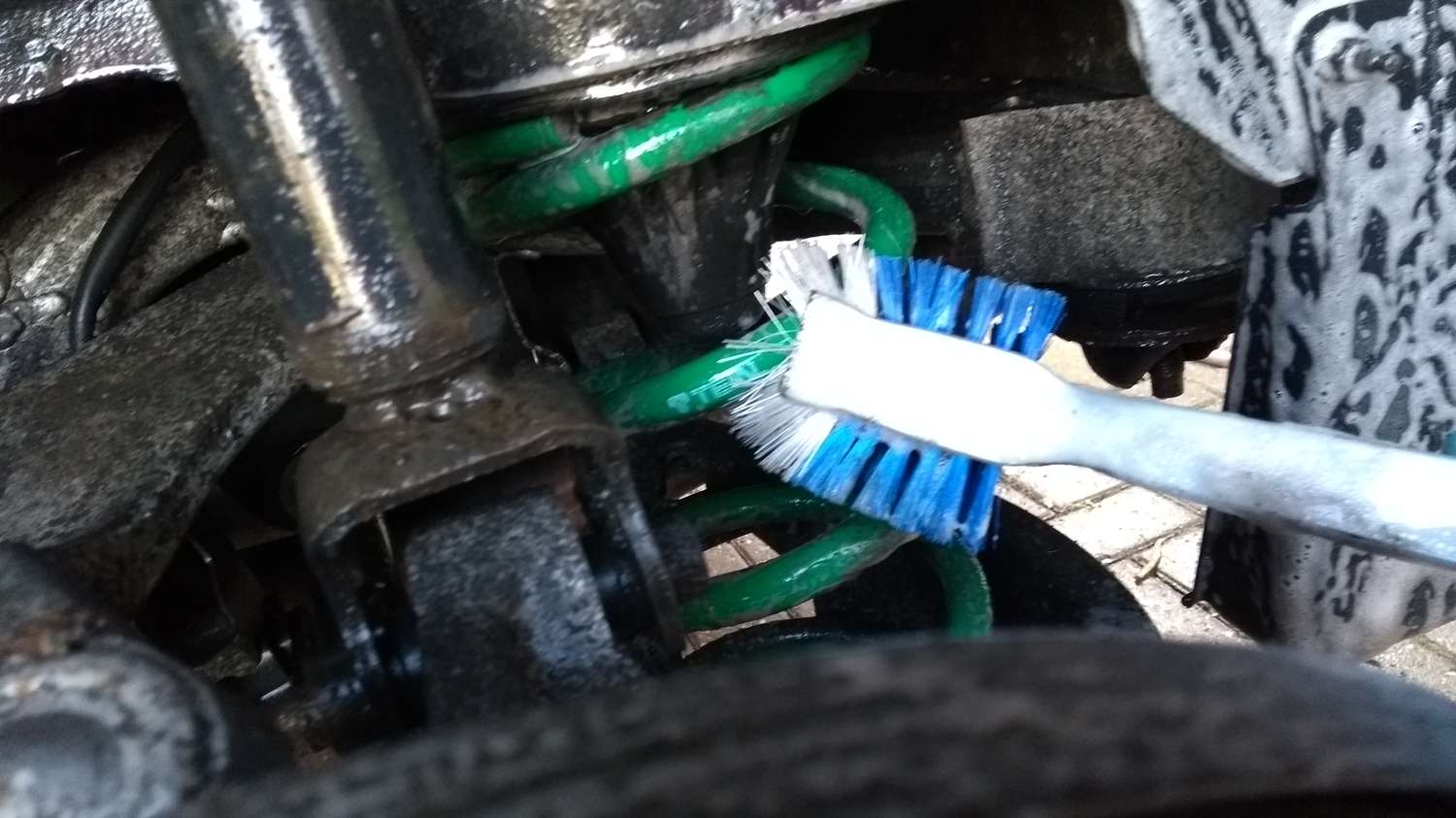

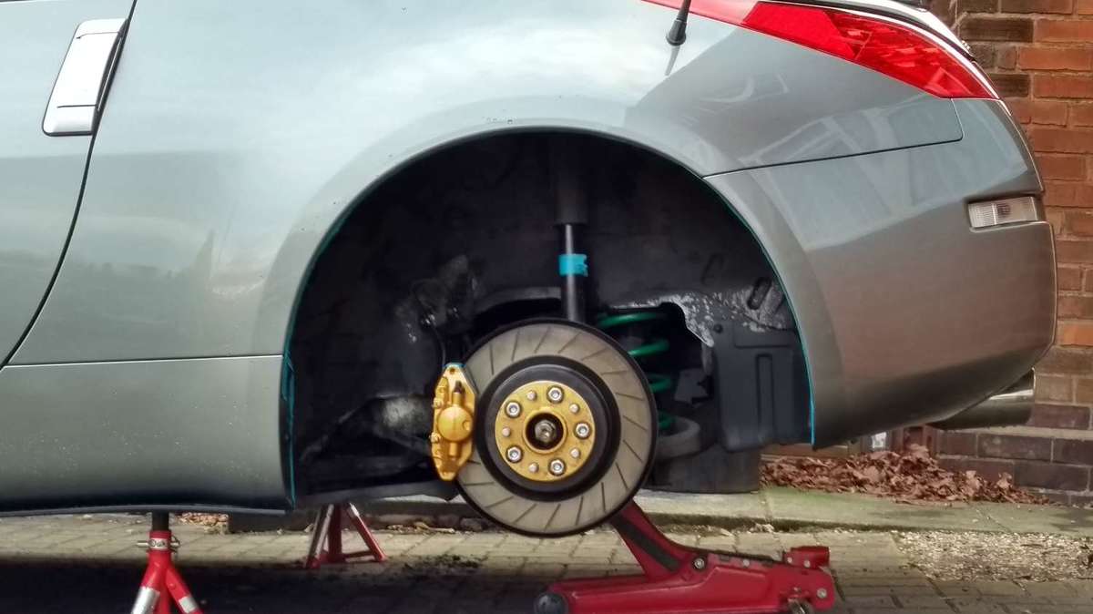

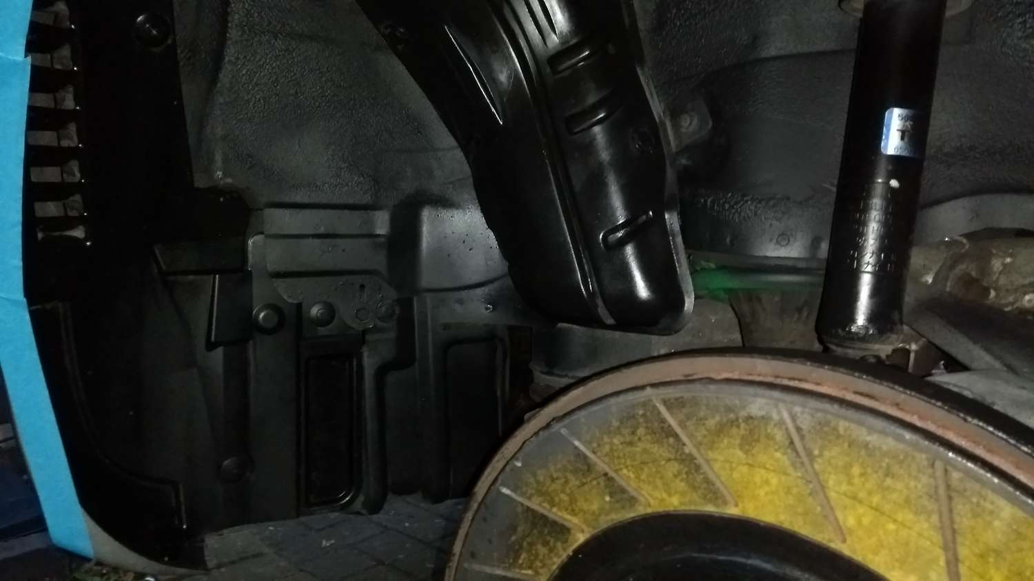

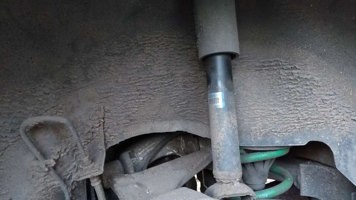

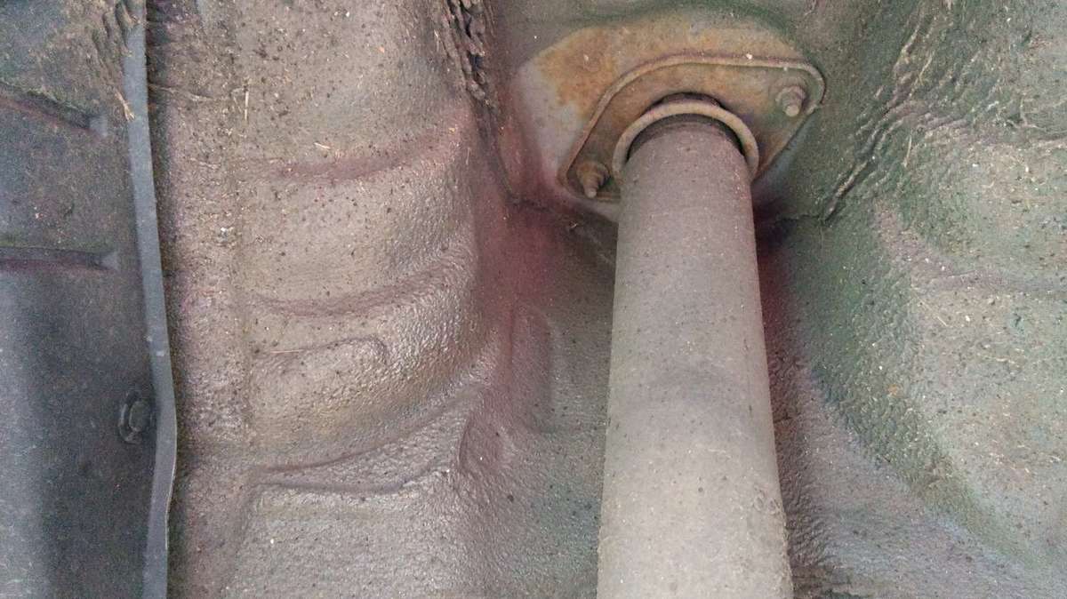

More winter prep, not as thorough job as the front arches as most of the factory underseal was still holding up well.
Daisy 50:50 APC
Autoglym wheel cleaner for alloy suspension
Agitate with stiff nylon brush
Rinse and repeat
Left to dry naturally
Hammerite stone chip applied
Plastics dress with Chemical Guys new trim gel
ACF50 bushes, brake lines and suspension
Before:
IMG_20171117_131233547_BURST000_COVER_TOP.thumb.jpg.1e748f08e84b19c9dc98017e7f3d960f.jpg
Yuk!!
IMG_20171117_134606794_BURST000_COVER_TOP.thumb.jpg.6ce9c48637465160a8ac71af7443c3eb.jpg
During:
IMG_20171117_132903452_BURST000_COVER_TOP.thumb.jpg.26060b5d9c22572ed7bc8c1bd7822f22.jpg
Rinsed and left to dry

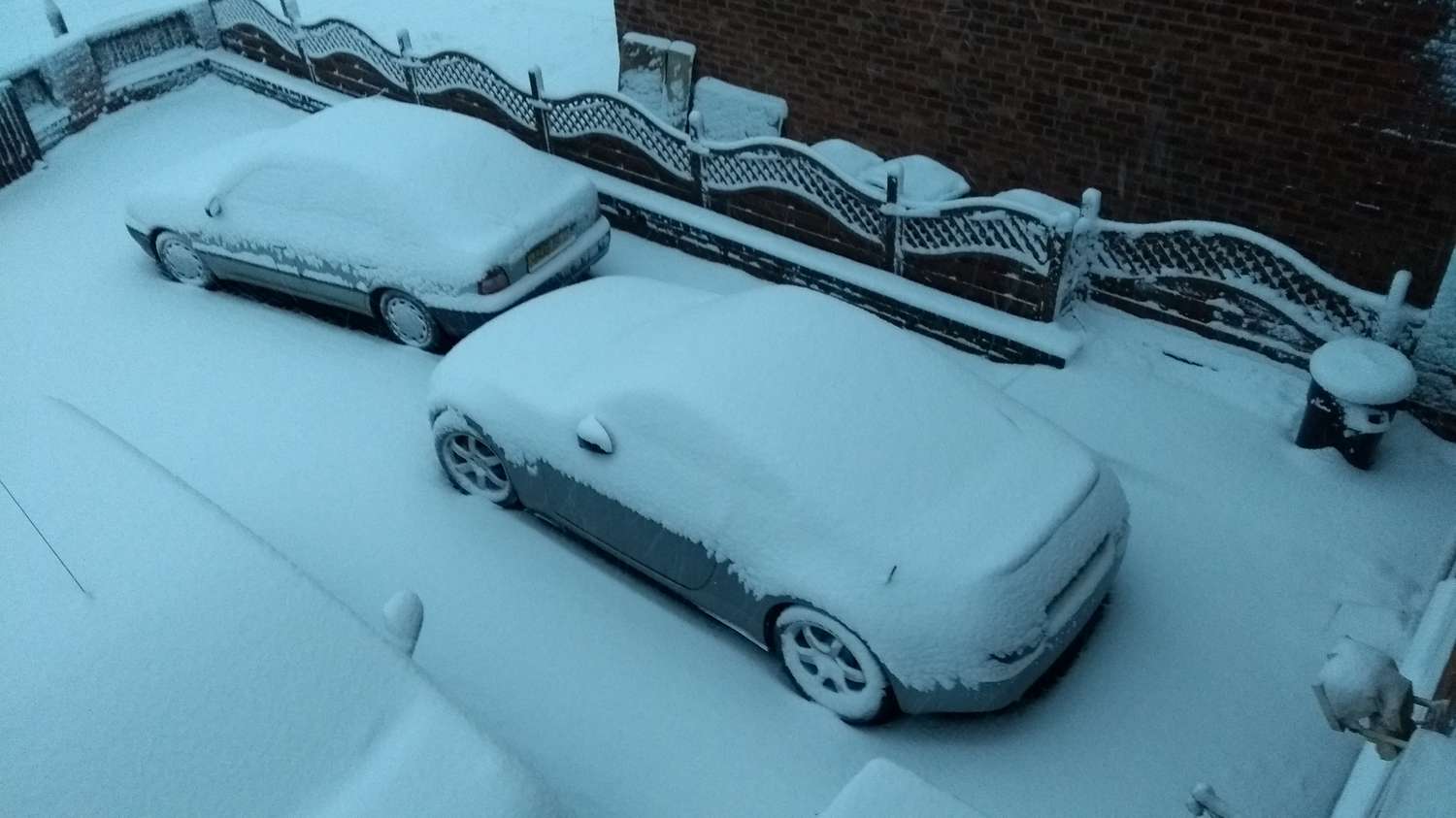

Nothing in the way of modifications, more so keeping her clean and tidy through the winter as best as can be with being parked outside.
Needless to say after two weeks being parked up and half this time being under snow, come thursday gone she wouldn't start. Thought ok, break out the portable battery booster *Suaoki U2 and epic fail!!! Arghhhh later that evening the trusty 92' Sunny to the rescue. Jump leads connected, wait a minute and the VQ35 burst into life. The next day meant long way to work allowed for some much needed charge, however I can't help but think the adverse effect dropping below 9v would of had. Hopefully nothing much as the battery didn't go completely flat at least.
