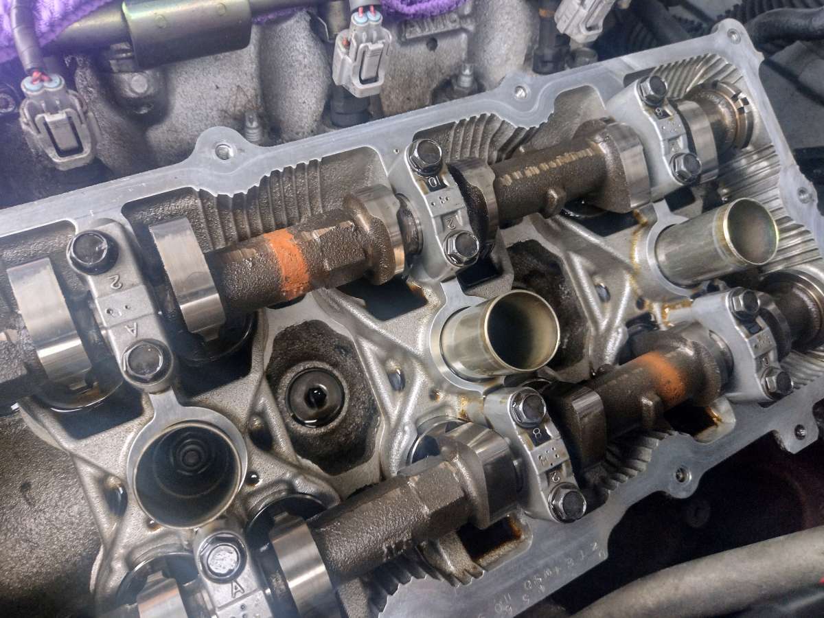

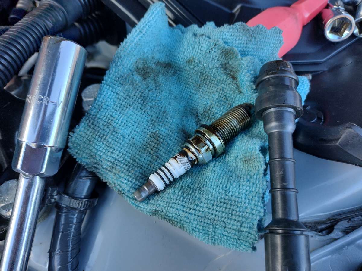

Cheers pal, yeah it sounds like nothing else so so pleased with the noise. Sadly she's at bit poorly causing smokey tips, the dreaded spark plug gasket gone - new valve covers please.

Surfaces all cleaned up
Hopefully no more oily tips 👍

Minor update - seems just about everything takes an age to arrive from overseas. The side that wasn't leaking was found to be in worse condition and instead of previously being replaced, was sealed up.
Passenger side
Drivers side

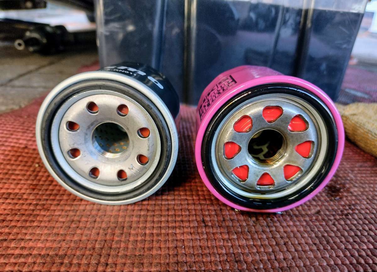

Annual service time, P2 due however as I have a reusable multilayer foam panel filter, a quick shake n vac was all that's needed. Wipers rotated and tyre pressures checked.

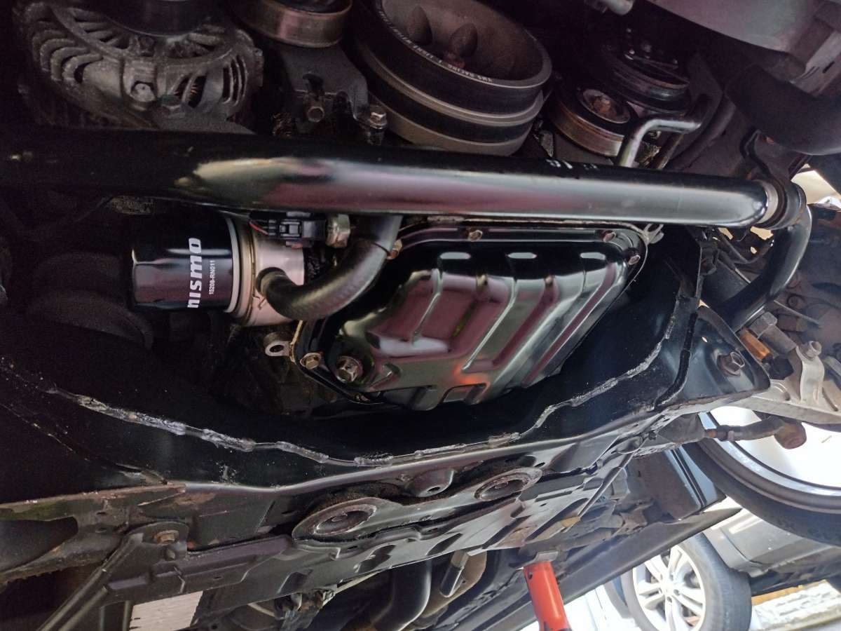

Having replaced the valve covers recently, I was shocked to see the amount of oil which remains in the heads regardless of whether the sump plug was in or out. Effectively there's always a handover of 12 month old oil that'll contaminate the new and continue for another stint.
I had the idea to carry out a flushing oil change and as I was going from Castrol Edge back to Millers Trident, I wanted a minimal handover.
New oil put in and ran for 20mins before draining. Oil filter removed and drained also.
Nismo vs HKS Hybrid
Flushing oil on the left, 12 month old oil on the right. To think that flushing oil I'd have asked to look after my engine for the next 12 months 😳
Fresh oil poured in for the second time, ran for a couple minutes and I've never seen the dip stick so clean. If you've never done it, for the price of a tub of oil do it - she's worth it

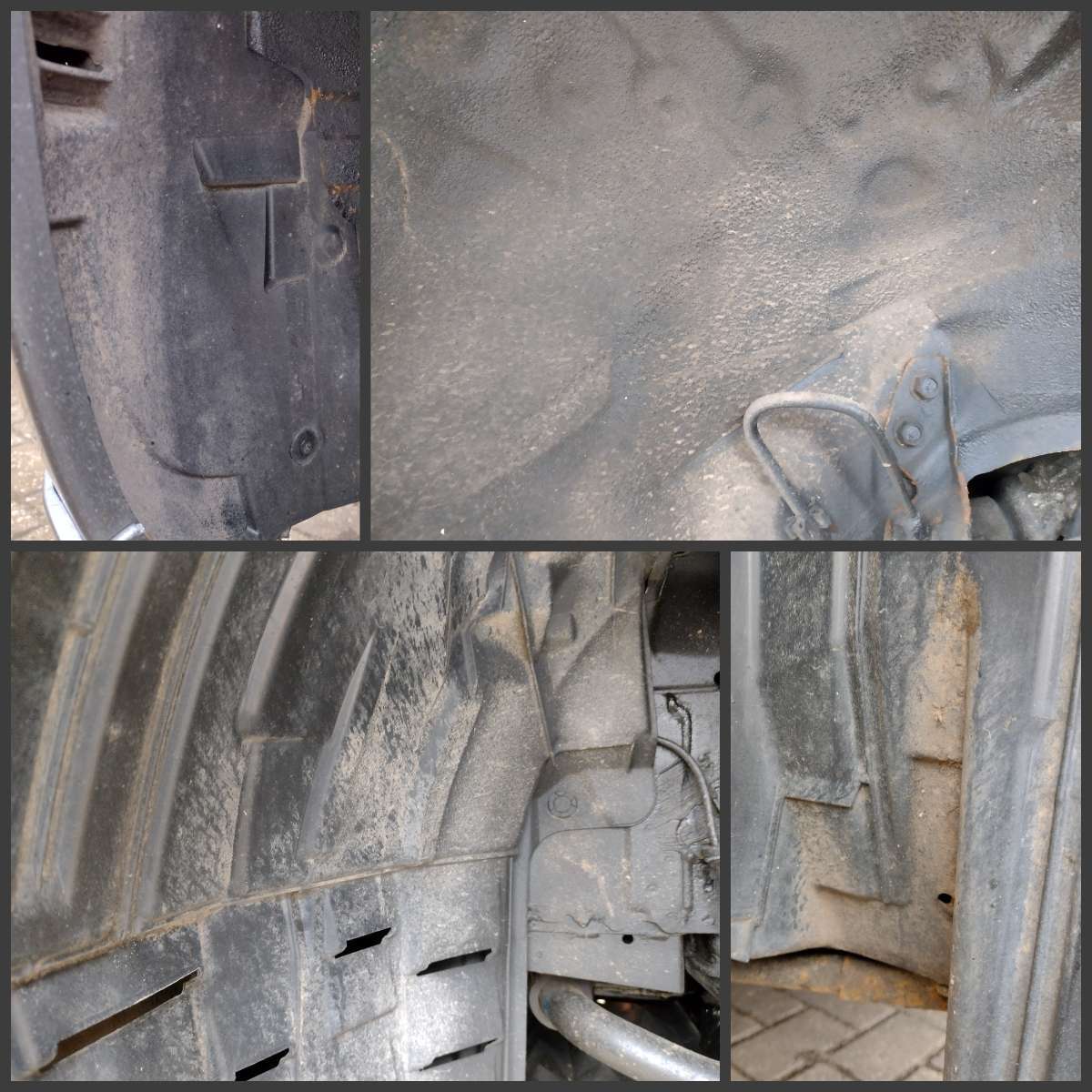

Annual Winter decontamination wheels off wash
Up on axle stands, wheels off for a thorough clean front and back.

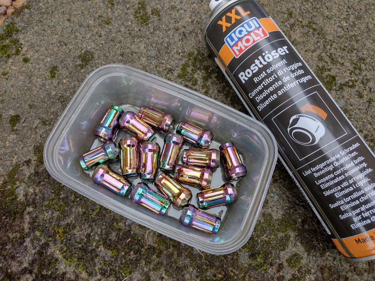

Lugs nuts left to soak in Liqui Moly Rostlöser
Before of the grime
Had a sneak at the coilovers
Various detailing brushes with Bilt Hamber Touchless 5:1
All the suspension nooks and crannies had a go over too, before being protected with ACF-50
NSR 50/50
Cleaned, dried and protected
Bodywork after the arches:

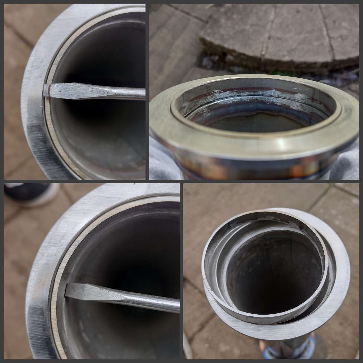

Not sophisticated enough to have a button to make the exhaust louder, have to get the spanners out 😁

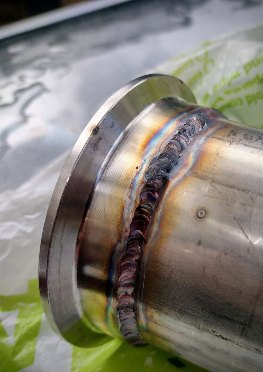

Motordyne XYZ sports cat swapped out for a 3' stainless straight pipe, for that brighter sound.
Longlife pipe I had made up needed some Dremel attention, as the merge on the y pipe has a sleeve. I took a few mm more than what was needed, to allow for heat expansion.
Went out for a drive and to get some fuel ready for Sunday. It might be due to me not having driven her for 3 weeks or the night air, bit she does feel noticeably livelier beyond 4000rpm. Sounds even more AMAZING now too.

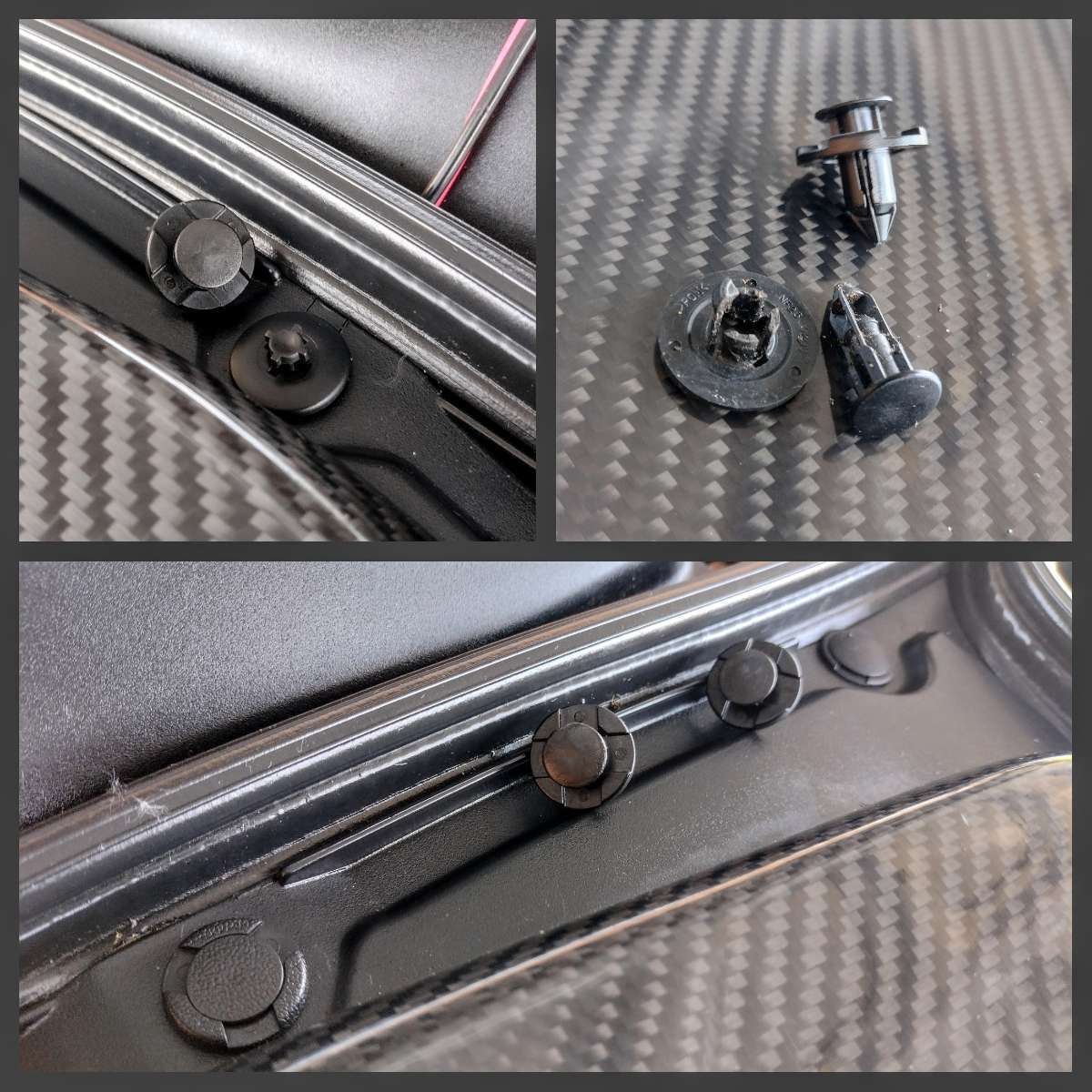

More teeny changes, had a few broken/odd clips around the scuttle that wanted changing out for the correct ones Nissan use.

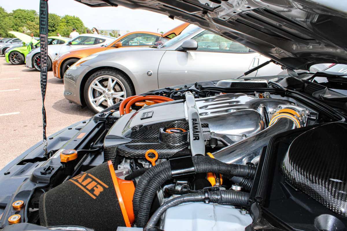

Engine bay cleaned ahead of the anniversary event in Gaydon.
