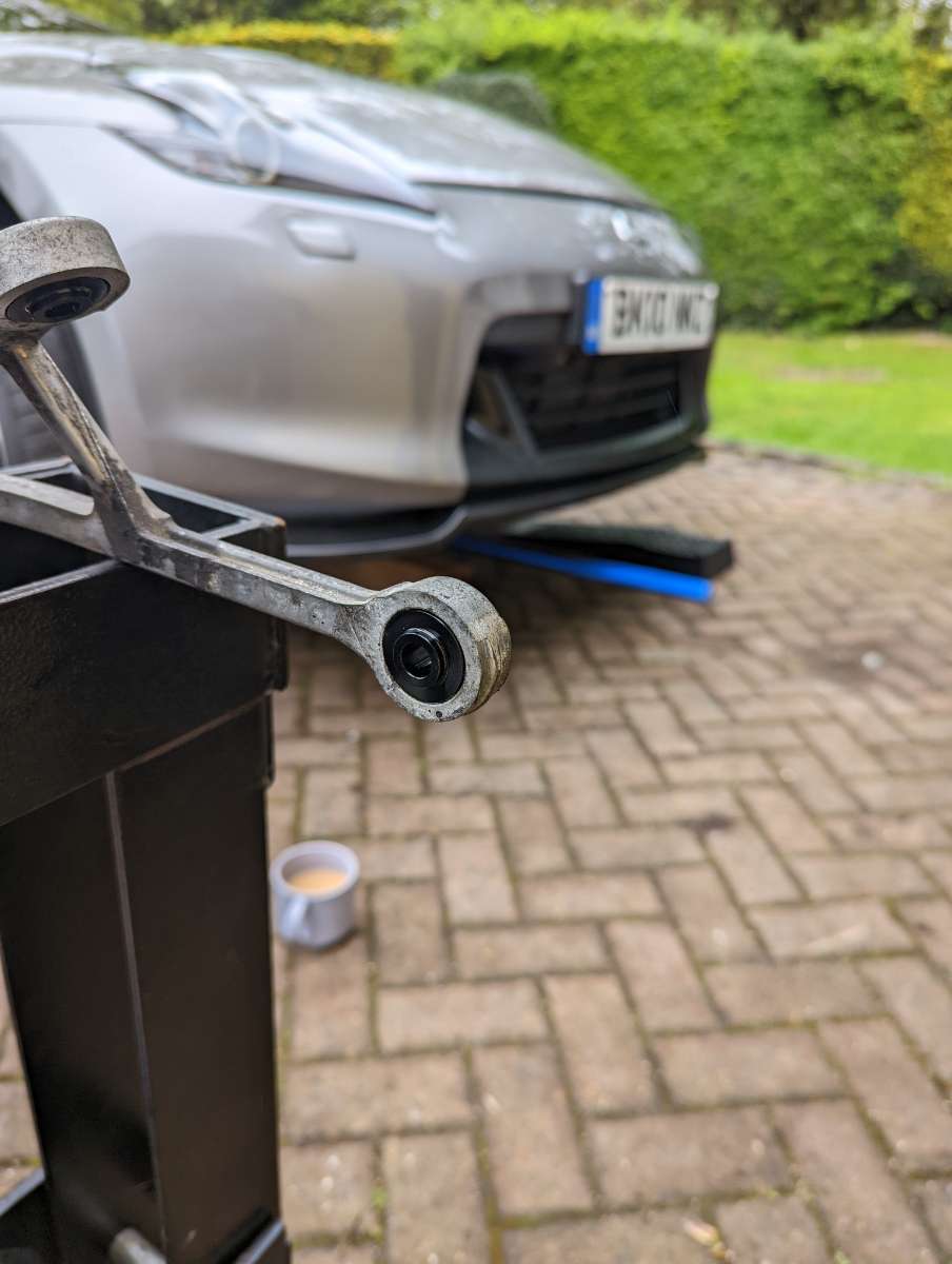

So feeling 2nd to 3rd being a little bit awkward now and then @350Butcher suggested I try these
 https://us.gktech.com/z33-350z-z34-370z-solid-transmission-tripod-mounts-set-of-4
so he very kindly fitted them for me at the weekend along with the stiffer shift springs these guys do
the result is a much sharper and more positive shift! a real nice little mod

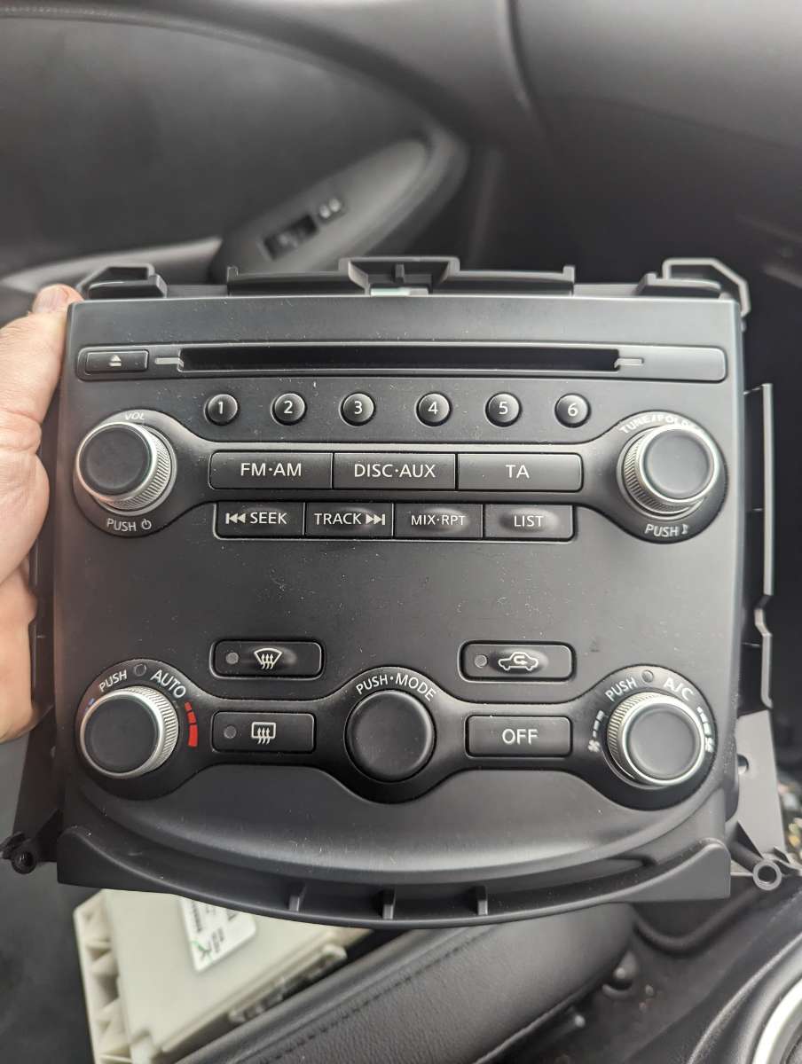

We also replaced the radio control panel as my volume had packed up.
and swapped out the AC module as my AC has stopped working so thought it could be that.
unfortunately that doesn't seem to be the problem so the AC fix needs further investigation.

Always a pleasure.............and once again we've provided top quality photos of the job to assist the forum!!
Seriously though really nice mods done together, tightens up the shift loads and there are no negatives at all
Parts installed
https://au.gktech.com/z33-350z-z34-370z-solid-gearbox-tripod-mounts-set-of-4
and (we installed the harder of the spring options)
https://au.gktech.com/350z-370z-transmission-shifter-return-spring-kit

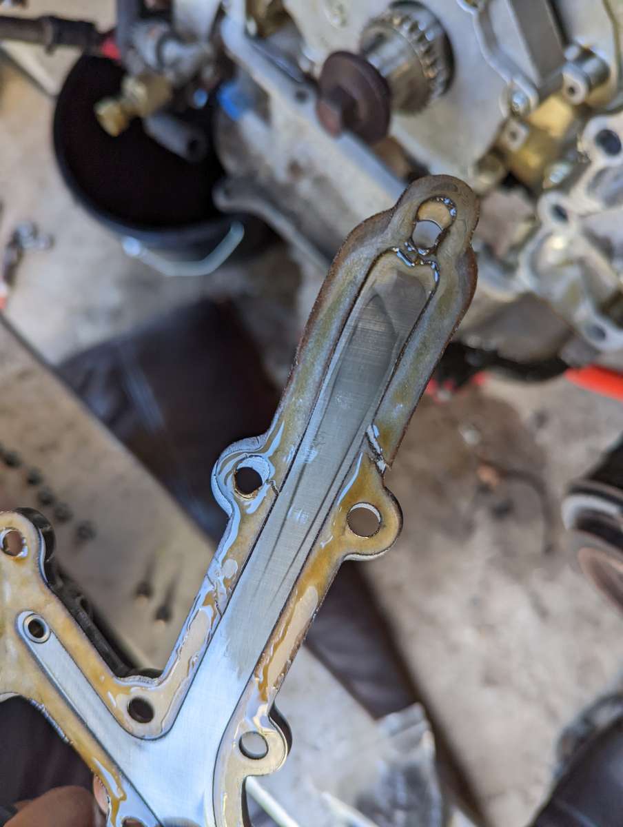

Attacking the gallery gaskets this weekend with @350Butcher
I've been monitoring oil pressure which has been fine but decided to dive in and get them done for peace of mind as we're going back to the Dyno at Litchfield 😁 the supercharger has left for vortech today to have the si impeller installed which should net a little more boost without actually spinning the charger faster.

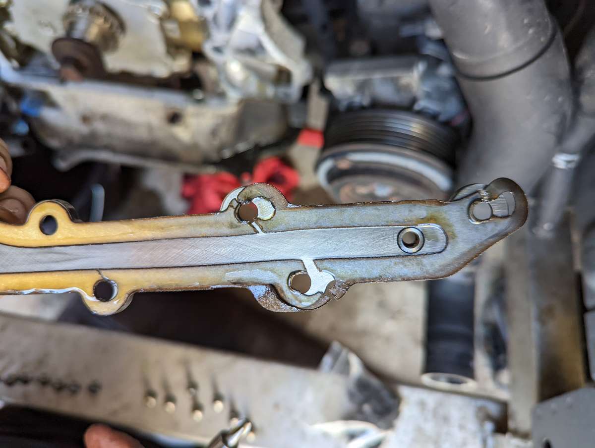

I think it's safe to say I dodged a bullet here and decided to do this just at the right time the big gallery gasket was gone the small one was ok
 again massive thanks to @350Butcher for his skills on the tools super methodical with the way he goes about things much like myself🤣
I'm glad we caught it in time! Now the wait for parts to arrive and the charger to come back
Edited by nissanman312
  • Like 4
Yeah was a good job done that! Not sure how many miles it would've worked out to be till they were fully gone and serious pressure issues resulted but safe to say they were well and truly on their way out and needed swapping out asap................which was good to see really after all that spannering just to inspect them!!

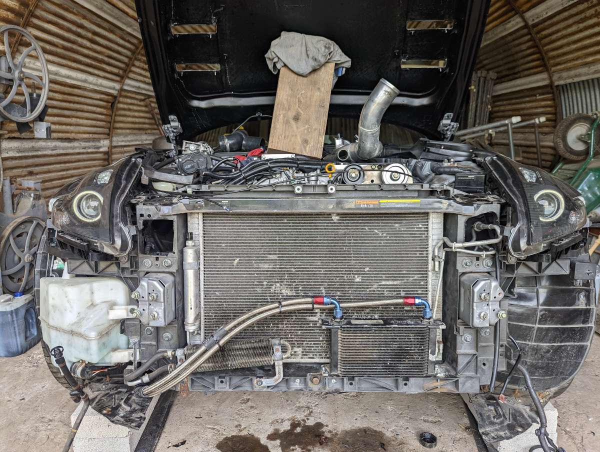

Few more bits done today in the barn
New engine mounts in ...that's easier when you can get at them from the front 😬
And started to get the car back together
Not much left to do now and then it's fill with fluids and run it up
I want to go with a better rad but need one that has AC
CSF are known to fail and not to keen on mishimoto
So options are hpi ran by these guys https://dsportmag.com/the-cars/features/revyou-supercharged-nissan-370z/
Or go with a custom set up but that gets costly and time consuming
Hopefully the charger will be back soon and can get some mapping done

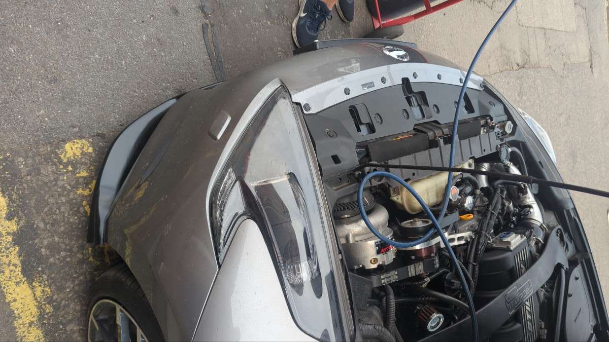

So who's ready for some forged engine build content?
Because It would seems the bleeding issue was a red herring and actually there was was bigger issues on the horizon.
I only got two days into the European tour and things went from bad to worse
What was a suspect bleeding issue turned out to be a suspected head gasket issue as it progressed to pressurising the coolant system and blowing coolant out of the header tank.
It looks like the extra boost pushed it over the edge.
Luckily!
I had some breakdown cover that is going to repatriat the car and covered a hire car and flights home.so we still got to enjoy most of the hotels and routes we had planned all be it in a fiesta 😂
So it's time to break it or fix it so I think I'm going to fix it and fix it proper this time so with @350Butcher excellent engine building skills the z is getting a bullet proof motor built for the boost
The stock motor did well to be fair 40k boosted miles and hard use a few hard euro trips included in that so I've had my use from it.
I could try and just do the head gasket but there's no point once we are that deep in the engine so sod it balls to the wall motor build time it is.
and it will provide you all with some quality winter reading while all your Zs are tucked up in bed for the winter.
The parts list has been compiled and will be ordered soon so grab your popcorn put your feet up and await the engine strip down pictures when the car finally arrives home.
for now here's the obligatory tow truck picture.😜
