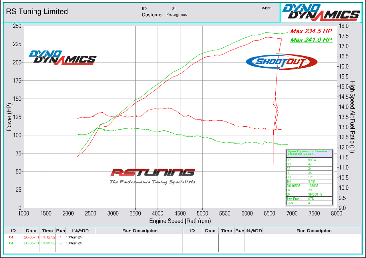

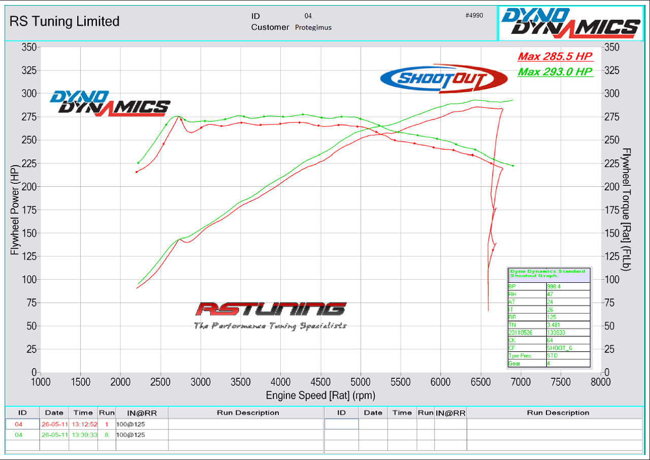

RS Tuning sorted my Z today with UpRev by Paul and nismo brake lines by Andy - thanks guys, it was good to meet you and interesting to see and hear about all the projects.
As pretty much everyone has posted the result of the UpRev is a car that is much more responsive, much cleaner acceleration from low RPM (especially noticeable on 2nd gear pullaways from ~1500RPM), stronger pull throughout the rev range and it even changes the character of the exhaust note to be more aggressive when you put your foot down!
My only regret is not having it done much earlier, or should I say it not being this way from the factory!
We were all interested to see how the Kinetix SSV was performing, Paul hadn't seen one before and as with nearly all plenums forum opinion is divided to say the least.
Tuning runs:
attachment quote has been reached, so no images
Results:
Before: 285.5bhp @ 6400rpm / 265 torque from 2750 - 5000rpm
236whp
After: 293.0bhp @ 6400rpm / 275 torque from 2650 - 5000rpm
241whp
15 lb ft torque gain at 2600rpm tailing off to 10 lb ft throughout
The top end provided by the Kinetix is very clear in comparison to other results on the same dyno, there is no drop off at 6300/6400rpm - it is flat from 6400 to 6800rpm redline, but the real difference is that torque, 275 flat from 2650 - 5000rpm only dropping to 225 at redline, put a smile on both my own and Pauls faces :)
Car was running lean, so at least that comment is true of the Kinetix.
