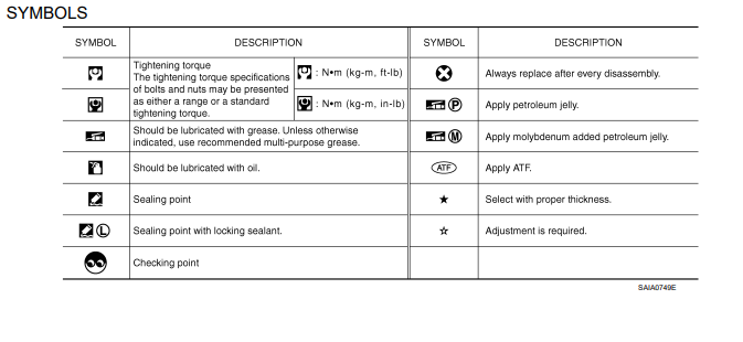

Cosmic73 Posted October 12, 2023 Author Posted October 12, 2023 In the workshop manual there's white spanner and black spanner symbols, does anyone know what the difference is? Quote
ShortPaul Posted October 12, 2023 Posted October 12, 2023 Possibly torque settings I am guessing Quote
Cosmic73 Posted October 16, 2023 Author Posted October 16, 2023 On 12/10/2023 at 22:31, ShortPaul said: Possibly torque settings I am guessing I know they're torque settings, but why are some black on others white? Quote
Ben@TORQEN Posted October 16, 2023 Posted October 16, 2023 On 12/10/2023 at 20:52, Cosmic73 said: In the workshop manual there's white spanner and black spanner symbols, does anyone know what the difference is? 1 Quote
Ben@TORQEN Posted October 16, 2023 Posted October 16, 2023 Inch pounds (black) / Foot pounds (white) for the torque setting Quote
Cosmic73 Posted October 16, 2023 Author Posted October 16, 2023 28 minutes ago, Ben@TORQEN said: Inch pounds (black) / Foot pounds (white) for the torque setting Ah, now i see it, They all have Nm as their primary torque, but their secondary torque (in brackets) can be inch pounds or foot pounds, Thanks for clearing that up 🙂 1 Quote

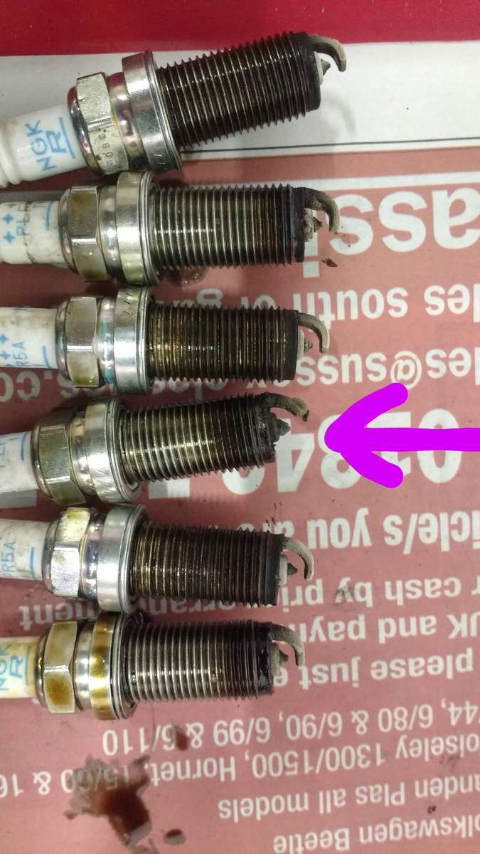

Cosmic73 Posted October 21, 2023 Author Posted October 21, 2023 Finally got to spend as few hours in the office this morning and got really stuck into the engine disassembly. I have to say I'm quite enjoying this project. The workshop manual is clear and easy to follow, the engine is a great design with plenty of room. So far I've removed the wiring harness, air collector and intake manifold. Next will be the rocker covers and timing case. The spark plug from cyl 4 has melted a bit so I'm keeping my fingers crossed it hasn't melted the piston or block because that will be a whole world of pain. In trying to take the PS pump off and there's a hidden bolt at the side of the block I just can't get to. Anyone have any tips? 1 Quote
