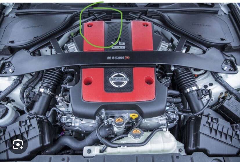

Jimmy94 Posted December 5, 2023 Author Posted December 5, 2023 No problem mate . Here’s what it looks like https://www.z1motorsports.com/intake-mas-and-hoses/nissan/oem-hr-vhr-evap-purge-solenoid-p-11312.html And the attached image shows the general location, sits just tucked under that cover at the back of the engine Quote
RichCox350Z Posted December 5, 2023 Posted December 5, 2023 18 minutes ago, Jimmy94 said: No problem mate . Here’s what it looks like https://www.z1motorsports.com/intake-mas-and-hoses/nissan/oem-hr-vhr-evap-purge-solenoid-p-11312.html And the attached image shows the general location, sits just tucked under that cover at the back of the engine LEGEND! Cheers mate, most appreciated! Rich Quote
