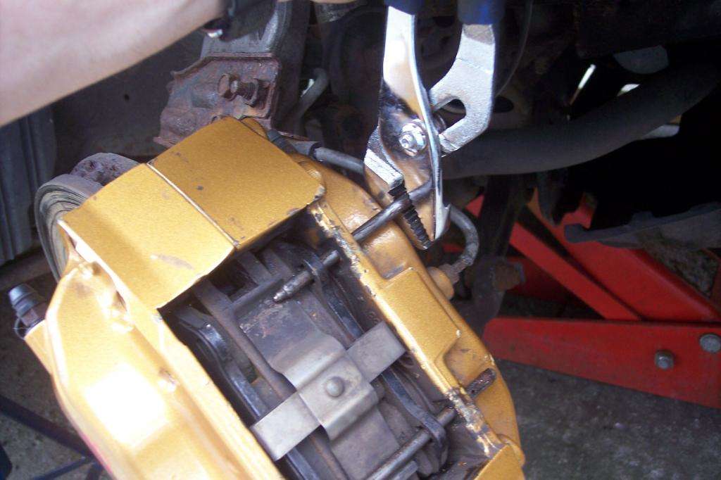

With the spring clips removed use a 4mm punch to tap out the retaining pins.
Pull out the pins completely from the caliper using a pair of pliers and remove the Pad retaining spring.

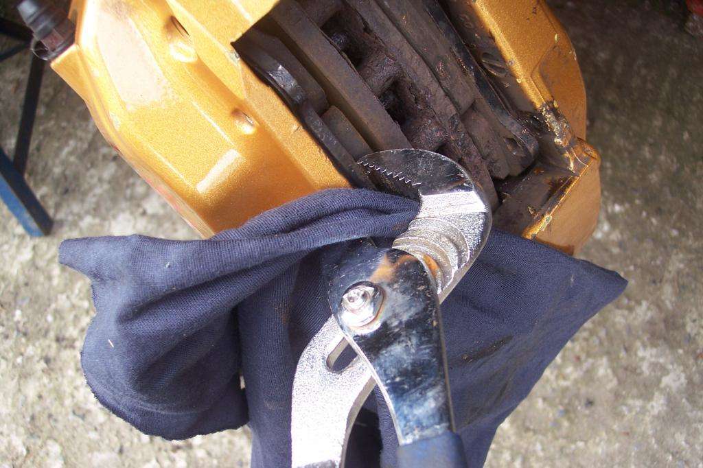

With a pair of pliers and a rag to protect the caliper compress the cylinders back into the calipers which releases the pressure on the pads.

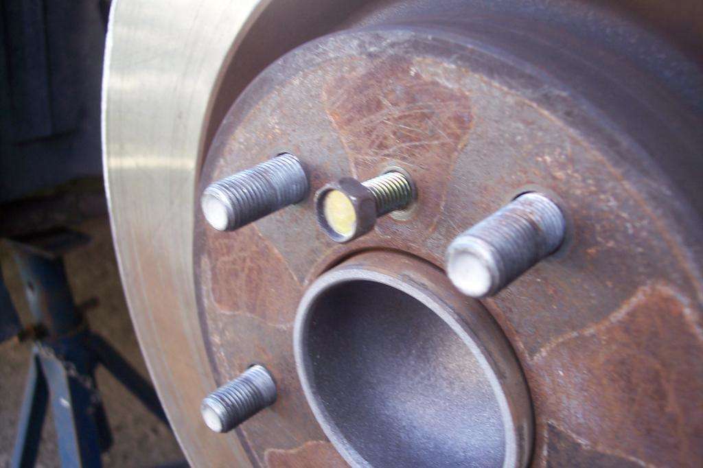

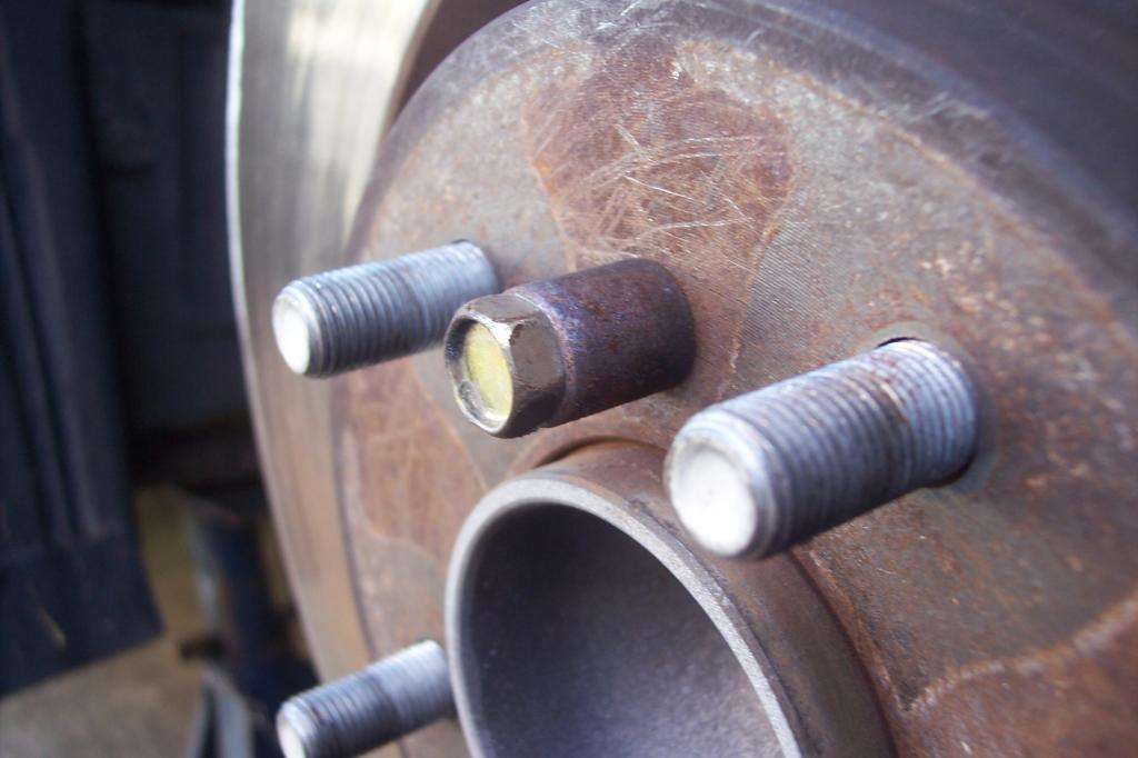

With the caliper out of the way you can now remove the disc itself. The disc should come free without any force. If it is a little tight you can either tap the disc with a hammer between the wheel studs or you can unscrew the jacking bolt, remove the sleeve and re-screw it back in till it come up against the hub forcing it away from hub itself.
