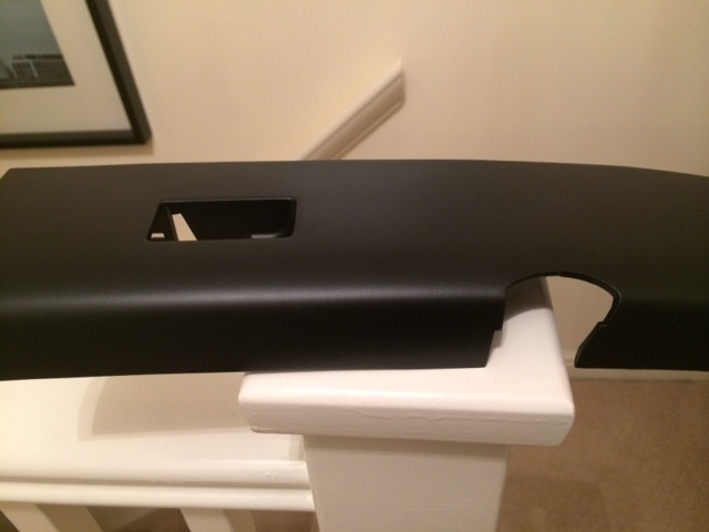

Meeerrrk Posted January 15, 2014 Posted January 15, 2014 Here's a pic of how it came out....feels like a rubber coating, impressive stuff! Sent from my iPhone using Tapatalk Quote

Meeerrrk Posted January 21, 2014 Posted January 21, 2014 I just rubbed it down to get all the old rubberised coating off, took It back to the original primer. I then cleaned it and smoothed it with a fine wet and dry (wet). I did paint it all in one go, although one side of the cut out where your hand goes in was a bit thin, but I made sure on coats 2 & 3 (on the same evening, dries quick) that I gave it enough coverage in that area. One thing I would say is that i think it would be quite easy to make it run if you spray too thick coats, so be careful. It's great stuff though, got mine off eBay. Sent from my iPhone using Tapatalk Quote
chirag1988 Posted January 21, 2014 Posted January 21, 2014 I just rubbed it down to get all the old rubberised coating off, took It back to the original primer. I then cleaned it and smoothed it with a fine wet and dry (wet). I did paint it all in one go, although one side of the cut out where your hand goes in was a bit thin, but I made sure on coats 2 & 3 (on the same evening, dries quick) that I gave it enough coverage in that area. One thing I would say is that i think it would be quite easy to make it run if you spray too thick coats, so be careful. It's great stuff though, got mine off eBay. Sent from my iPhone using Tapatalk Ok thanks mate - I'm guessing you can just wash your hands afterwards as you'll probably end up spraying the hand that's holding it? Quote
Meeerrrk Posted January 21, 2014 Posted January 21, 2014 I just balanced the piece, on some newspaper - it sits quite nicely by itself so you can get to all angles. I did originally hang it but I quickly realised the paint may run easily so sat it on the bench. Sent from my iPhone using Tapatalk Quote
