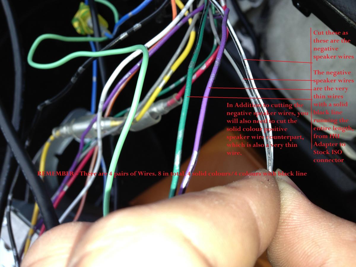

Right, here's just a little more detail on which wires are what and what to do, AFTER the head unit is removed.
Firstly, work out which 8 wires from the Head Unit are the positive and negative wires which connect to speakers and sub. 4 Pairs = 8 wires..... The very thin solid coloured wires (White, Grey, Green, Purple) are positive, and the same coloured counterparts with a solid black line (White with black line, Grey with black line, Green with black line, Purple with black line)

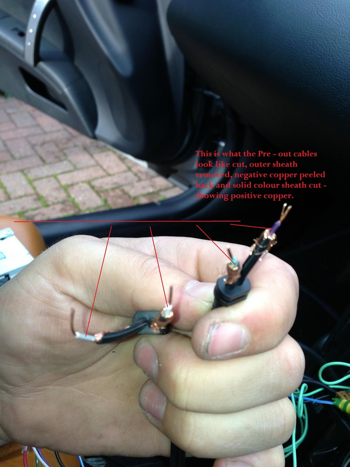

Secondly, grab the 4 pre-out (phono cables as otherwise known) and cut the heads off (cut the adaptors off).
Resulting in cables looking like this;
FINALLY Crimp or solder, solid coloured wires from the Head Unit to solid coloured wires from the Pre-out cables. AND, do exactly the same with the Coloured cable with a black line on them to the bare negative copper wire from the Pre-out cables....... REMEMBER after soldering or crimping to wrap any exposed metal from the completed wires in insulating tape......
