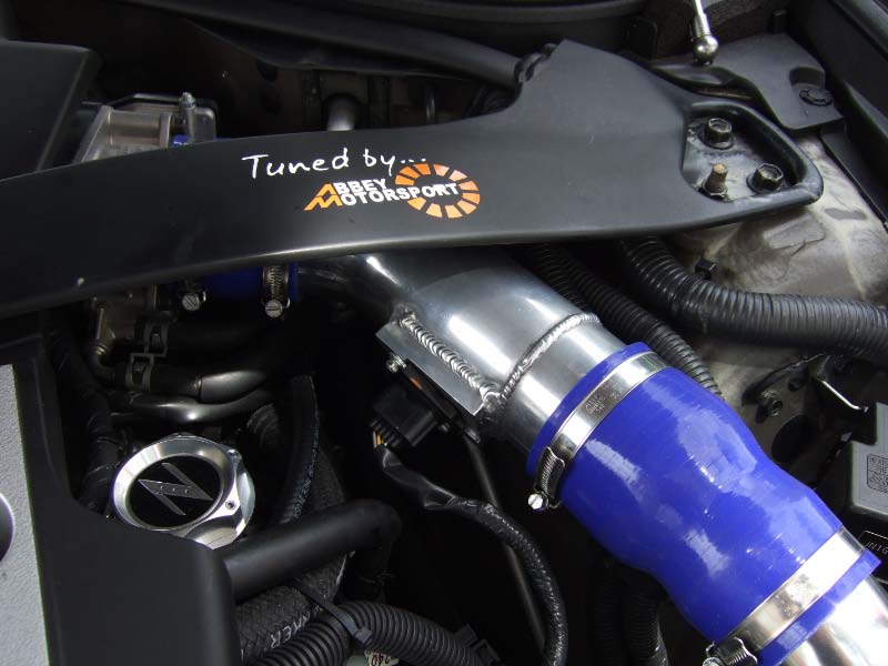

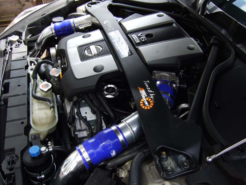

Kev T Posted July 21, 2012 Author Posted July 21, 2012 Ok here we go again with S/c for the last time, ( at least for this mod ) The car went back to Abbey for a few days to have a greddy deep sump fitted which i must say keeps the oil temp. very stable when used with oil cooler, and to have the GT spec braces fitted ( see related post ) while it was there they fitted slightly bigger intake tubes to slow down air flow on boost giving me another 20 RWHP. As you can see from Dyno plot she is now producing 431.5 Rwhp which is about as much as i am going to get from the Stg 1 GTM Supercharger, but to be fair it is more than enough, the car is very fast, picks up instantly in any gear and now after uprev tweaking feels smooth, i am a happy bunny. Quote
