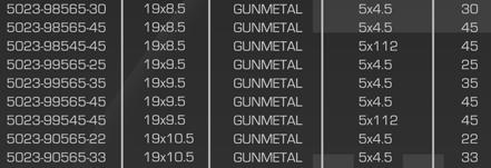

Husky Posted March 23, 2010 Author Posted March 23, 2010 to pick this back up ok so my options for the wheels im looking at are so from this i guess the backs are going to be 19x10.5 offset 22 the fronts 19x9.5 offset 25??? im going to be putting 205's on the back and then the front again is a ?? i want the tyre sidewalls to sit the same on both wheels so i guess i better get my calculator out. Quote

Ian Posted March 23, 2010 Posted March 23, 2010 to pick this back up ok so my options for the wheels im looking at are [attachment=0]wheels sizes.JPG[/attachment] so from this i guess the backs are going to be 19x10.5 offset 22 the fronts 19x9.5 offset 25??? im going to be putting 205's on the back and then the front again is a ?? i want the tyre sidewalls to sit the same on both wheels so i guess i better get my calculator out. Same sizes as mine & I'm running 245/35 & 275/35, Might try and get a 265/295 combo when I need tyres next though Quote
