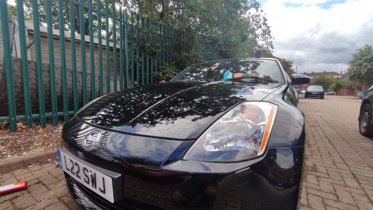

So it begins, like you I've always loved the 350z since I first saw one (sunset orange).
I have seen this 350z parked up on a side street and after two years of sitting I finally managed to speak to the owner and settled on 2.5k for the car, I threw some V Power and jump started it and it seemed well.

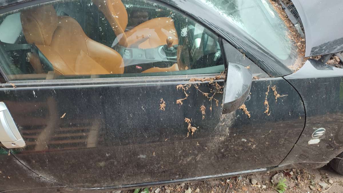

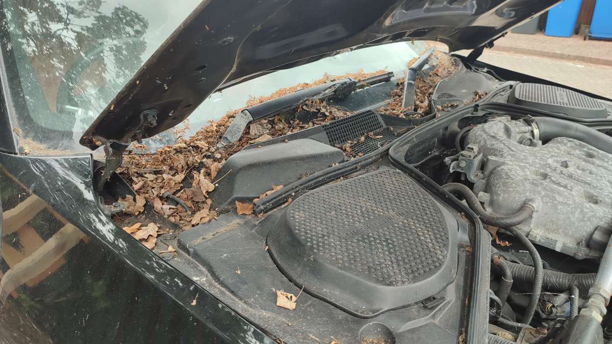

This is after I pumped on tyre up and threw a few twigs aside.

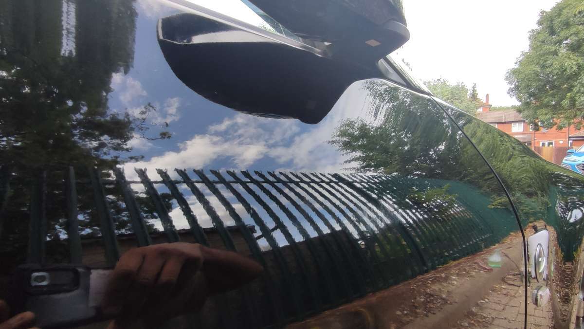

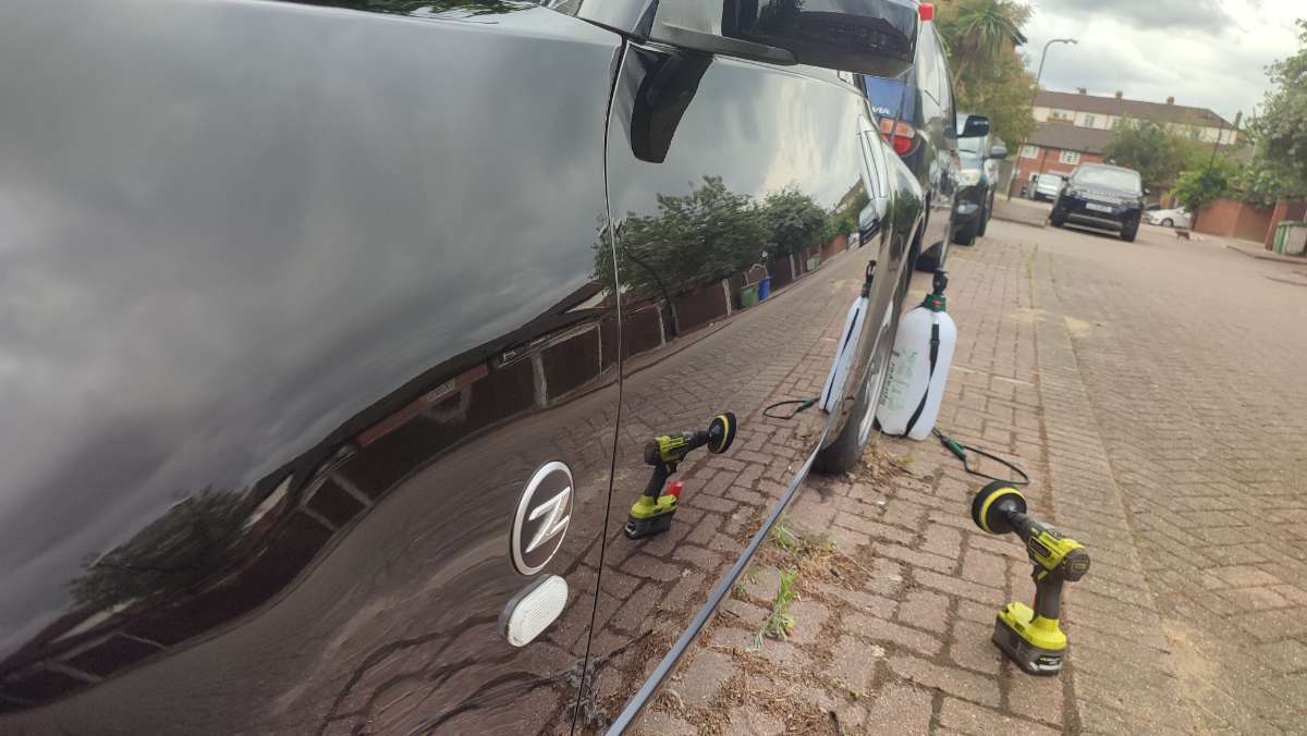

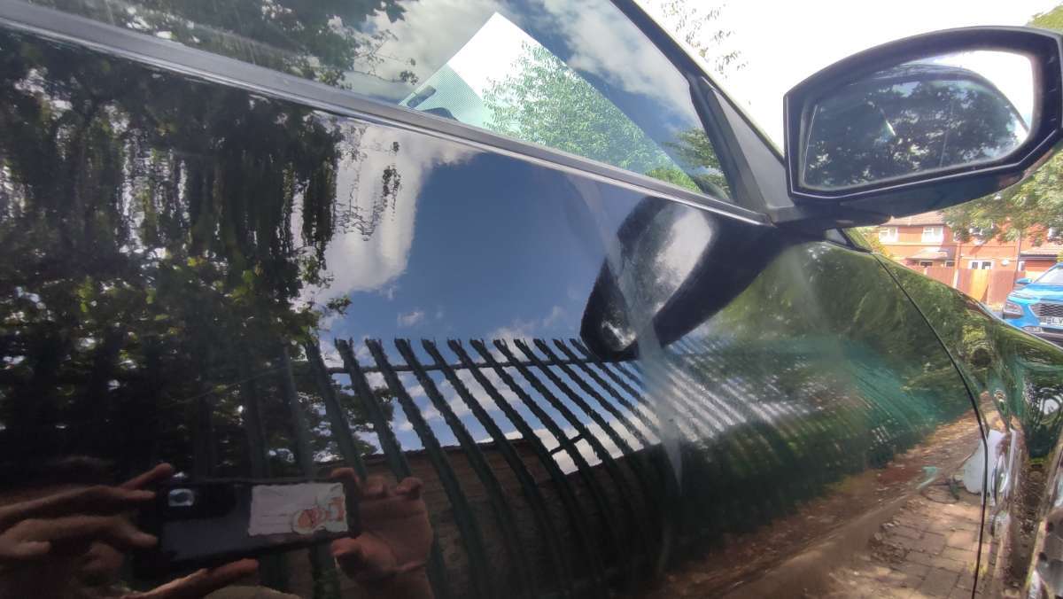

Washed, clayed and T cut the paintwork most of the panels which has come out wellIMG_20230704_113756.jpg.e687739424d911ddc3f361b6f516ac13.jpg

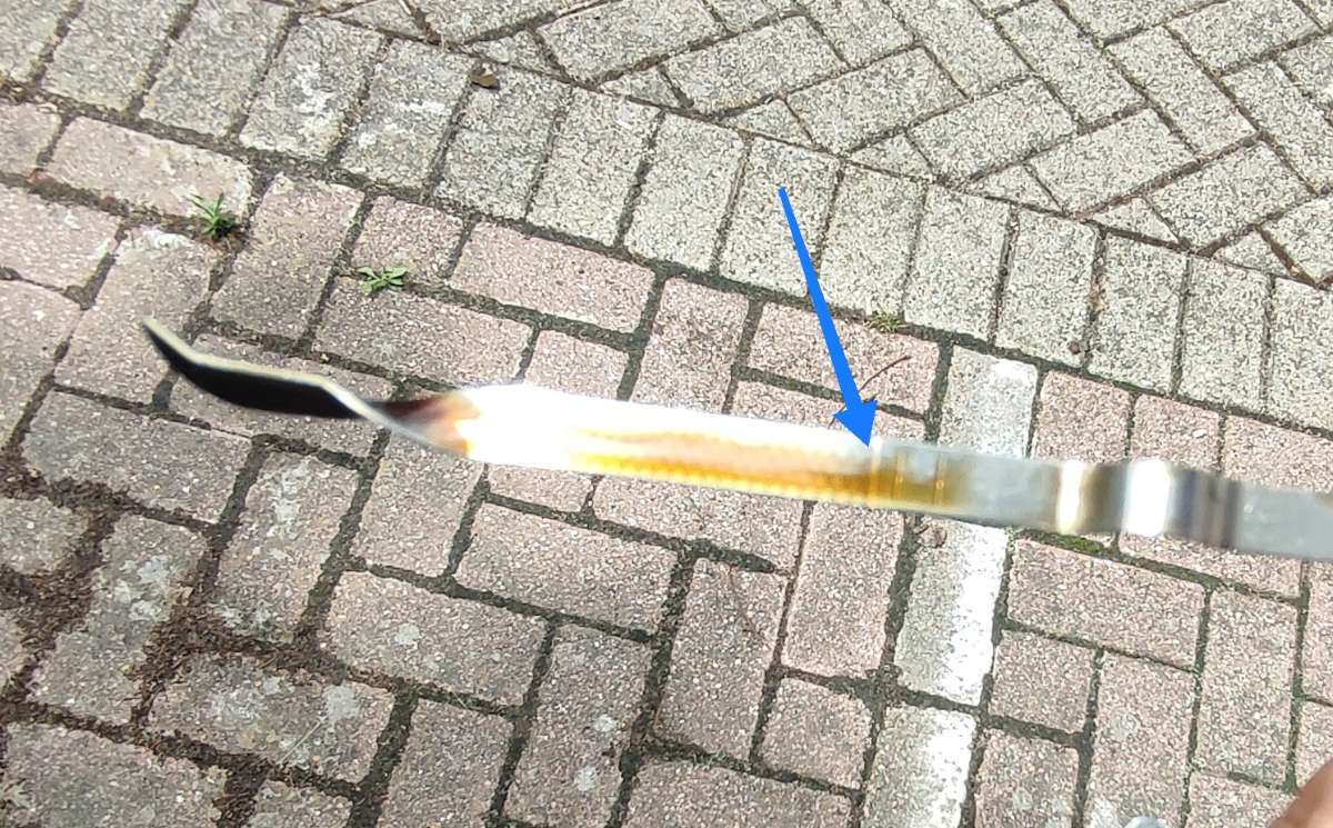

That dipstick is the worse.....So the oil level check on a cold engine and level surface, this is pre oil change. It's  above the H, I assume it should be where the mesh etching ends. Thanks @davey_83 for the suggestion I think it might have a tad too much oil.IMG_20230706_133518.jpg.ce5fdb31279e68bab9e9e3866d4758c1.jpg
  • Like 2
Yeah looks like you have 300-400ml too much oil. I would run the engine till warm, turn off and remove the oil filter/drain the filter. Re fit the oil filter and run for a minute then repeat. This will drain off a few hundred mil and re check level. Fingers crossed for an easy fix.

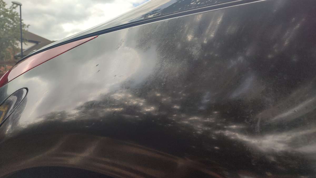

Paint on the car is good underneath all the grime. The rear two quarters paint seems different or less solid and the tree sap and bird poo has etched itself.
Otherwise the paint is coming along nicely with plain old T-Cut and drill pad.

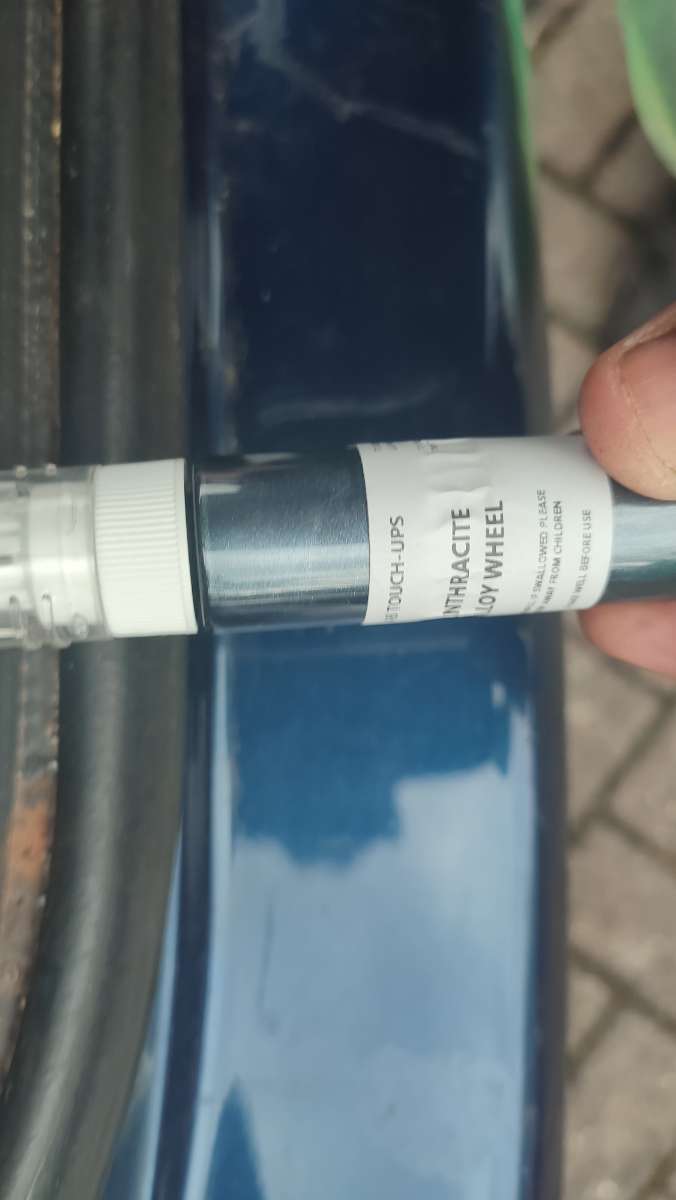

I bought a Anthracite paint pen to cover some of the kurb rash, but it's come out blue so must be issue with paint or they are gunmetal or something.

Got another paint pen for the curbing of the wheels, paint from eBay for Nissan Gunmetal gray was a perfect match. Has helped cover the rash.

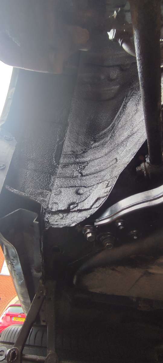

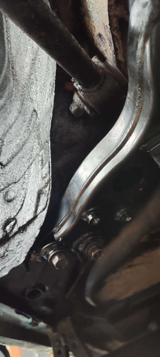

Bought new kidney brackets and hardware and got rid of the slash shield which was an advisory on the last MOT. Brackets were solid still but I wanted to underseal where the brackets and W brace attach to the chassis.
Used Rustins rust remover then treated the areas with rust converter then washed and undersealed the areas under the arch lip, tubs and mounting points
Much nicer now
