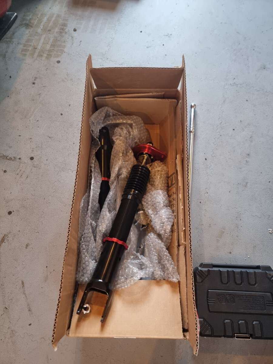

Staying on the rear suspension I managed to pick up some "air lift performance dampers" from Ebay. Apparently they are made in the same factory as Bc racing. And they are 30 point damper adjustable which was what I was after.

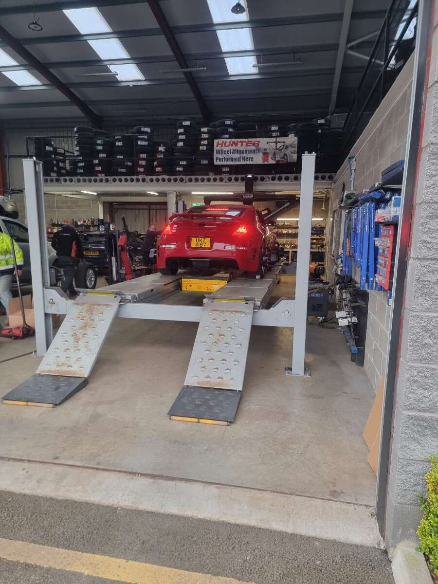

Dampers fitted to the rear. And off for an alignment. The eccentric bolts on the spring buckets/arm were seized however. (Literally the only bolts I didn't replace, typical) so the camber is a little out untill I can get that replaced.
Edited by Dipper
I also took the time get the height right on the rear adjusting the new coilover set up. Front probably needs to come down a little more. But it also meant I was able to get up the ramp to get it aligned a bit more easily. So maybe a blessing.

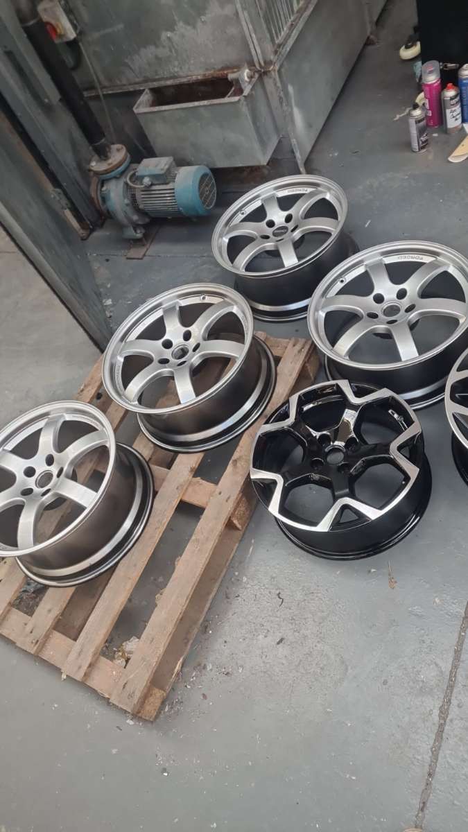

Also the big news. Got the modified and refreshed wheels back. So happy with them. Ultamotive did a great job with them.

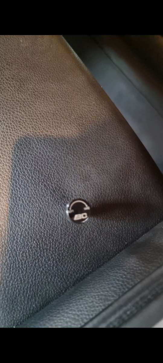

I got annoyed with my Southbend gearknob not sitting straight. Or loosening off the threads when the weather got really hot. So I bit the bullet. Drilled a 3.2mm hole and tapped some m4 threads into the front of it. I'd never actually tapped threads before. But it worked quite well. Just waiting on the correct length grub screw to finish. The protuding one is a place holder to test it works. It Should sit flush and solid once it's all done.
