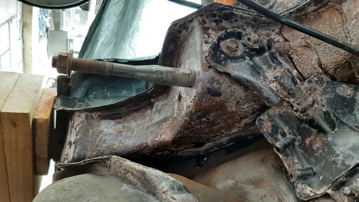

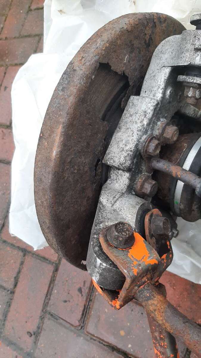

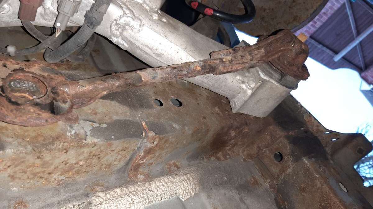

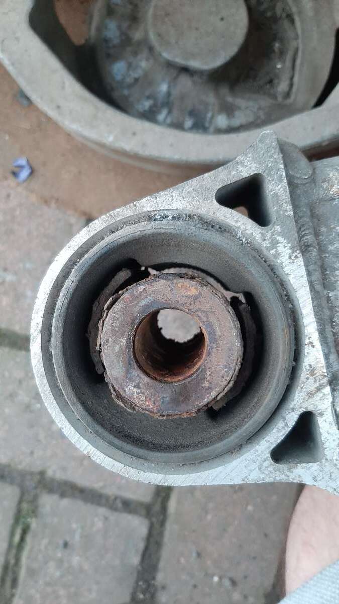

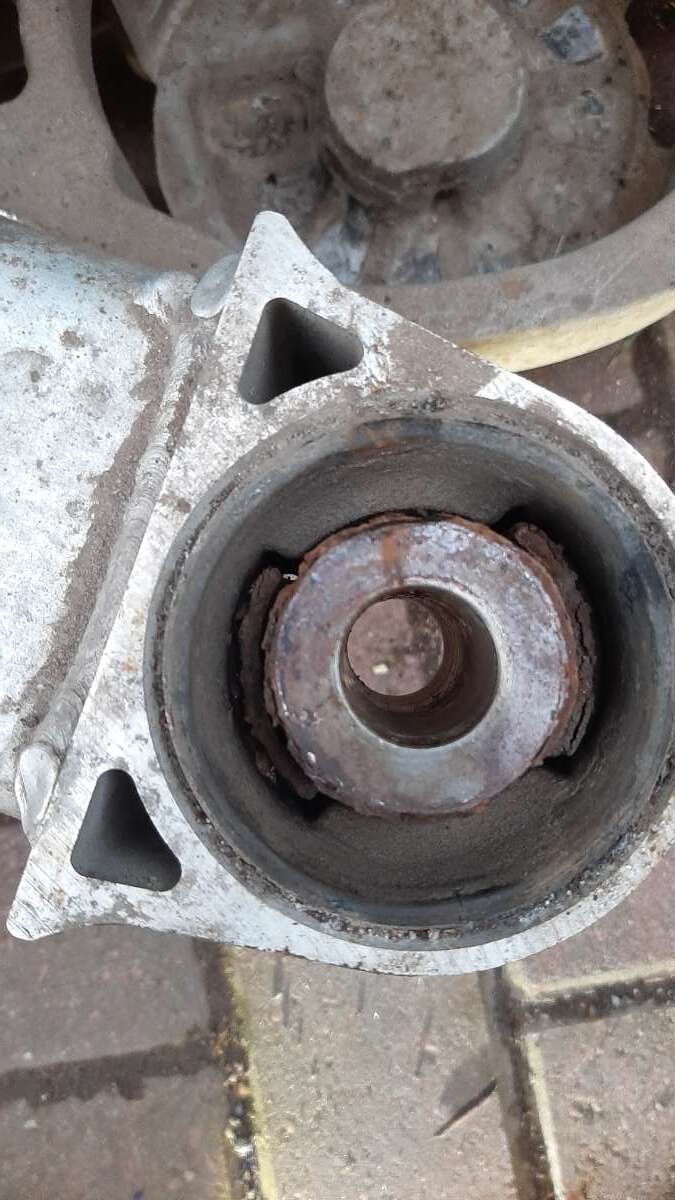

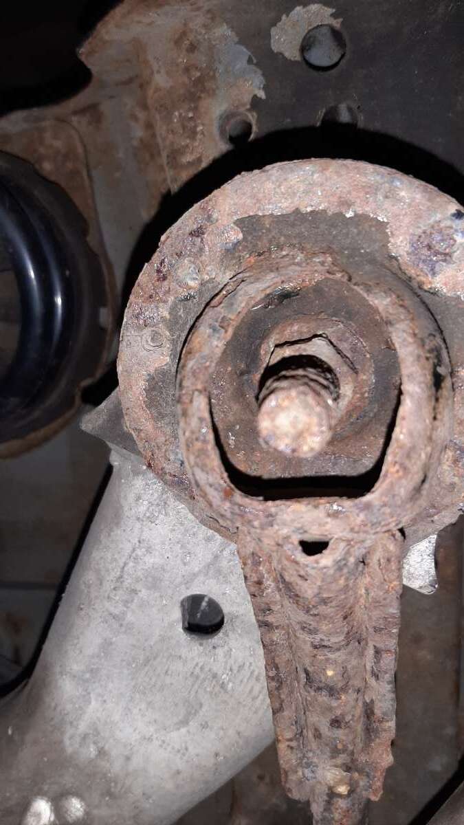

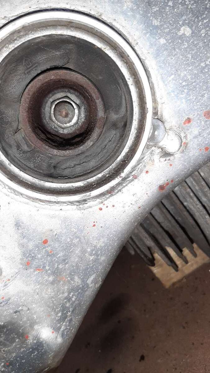

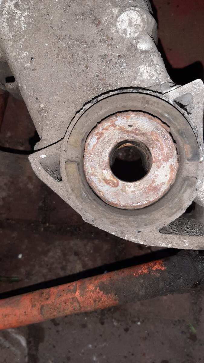

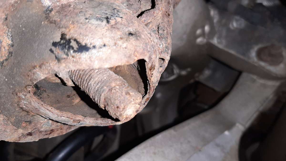

MicktZZZ Posted February 14, 2022 Author Posted February 14, 2022 Well got subframe dropped this weekend, gave it a bit of a pressure wash and then started taking off the ARB and suspension arms as want to clean up and repaint as all pretty corroded, underside of car again quite a bit of surface rust but once treated and undersealed should mean it lasting as long as I keep car, brake dust shields are pretty bad though so thinking to either cut them off or replace, although now off car could be difficult to get the hub nuts off so just cut them off. The subframe and diff bushes dont look too bad but think its worth replacing now, cars at 90k Quote

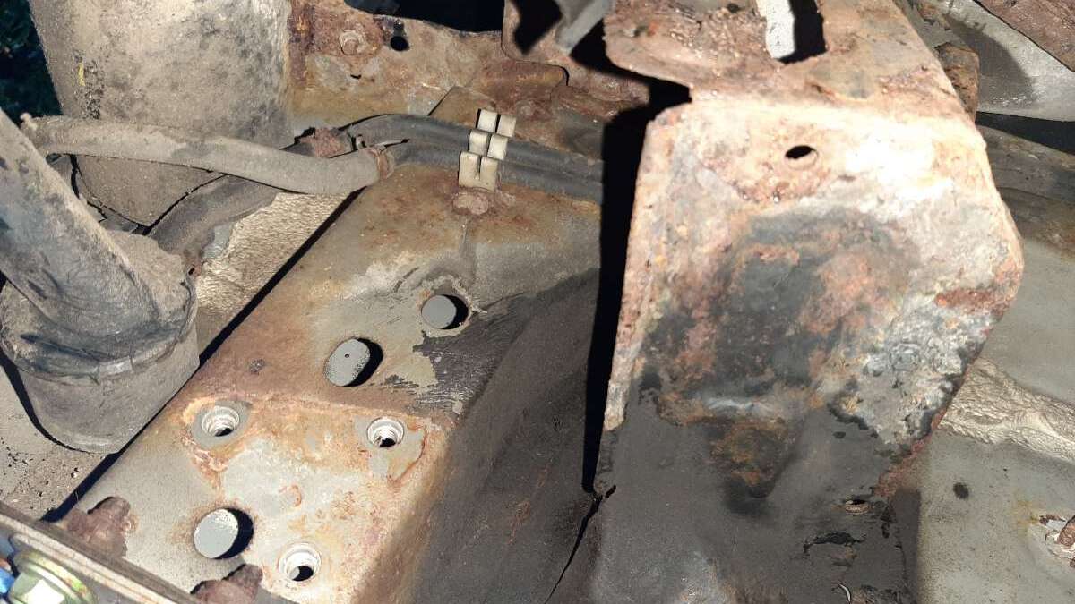

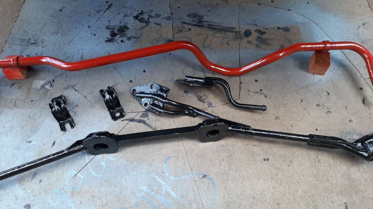

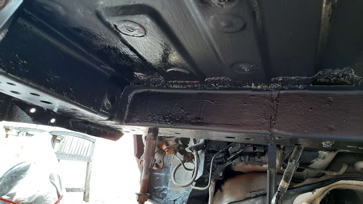

MicktZZZ Posted March 14, 2022 Author Posted March 14, 2022 (edited) Quick update, have cleaned and wire brushed underneath of car with rustbuster kit, seemed to take a while for the rust treatment to take effect probably due to colder temps but it got there in end, and painted with the 2 part epoxy paint looking a lot better and should help prolong the cars life .. I hope Also took opportunity to replace subframe and diff bushes posted another post for this, just be nice for someone to check my work before putting it back together Also replaced adj camber arms and fitted lockout bolts, and adj control arms, and then fitted the ac-delco larger adjustment toe bolts, with front adj arms also to fit so thinking I can now align car properly to then realise cars still on stock springs despite being told its lowered oh 😬 at least I think they are (they measure 12 inch on rear) .. hey ho least its all ready for a drop 🙂 Edited March 14, 2022 by MicktZZZ 4 Quote
