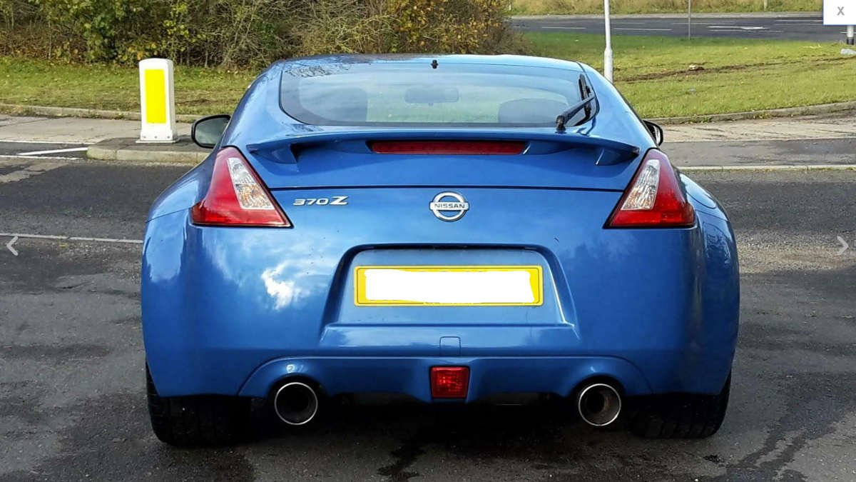

pmfinch Posted March 10, 2020 Author Posted March 10, 2020 14 hours ago, The Trooper said: I have a Nismo back box on my 2010 GT and it fits just fine, although it's a little quieter than expected. Unfortunately, I can't tell you anything about how it was fitted as it was on the car when I bought it, and I only picked the car up from the dealer two weeks ago Thanks for the update. If it is possible could you post a picture of the bumper/valance and the exhaust tips so I could get an idea of how the tips sit with the shallower rear of the GT? Cheers! Quote
pmfinch Posted March 10, 2020 Author Posted March 10, 2020 Thanks for the pictures - the exhaust looks good and I love that blue! Quote
The Trooper Posted March 10, 2020 Posted March 10, 2020 Thanks, it's LeMans Blue apparently, and I love it. Don't see many Quote
Lee370Z Posted March 10, 2020 Posted March 10, 2020 I love that colour blue for sure(super rare) and your car looks lovely. The exhaust tips look nice and meaty too with them being bigger than the standard tips. I will keep an eye out for you because I'm not that far from Lincoln. Quote
