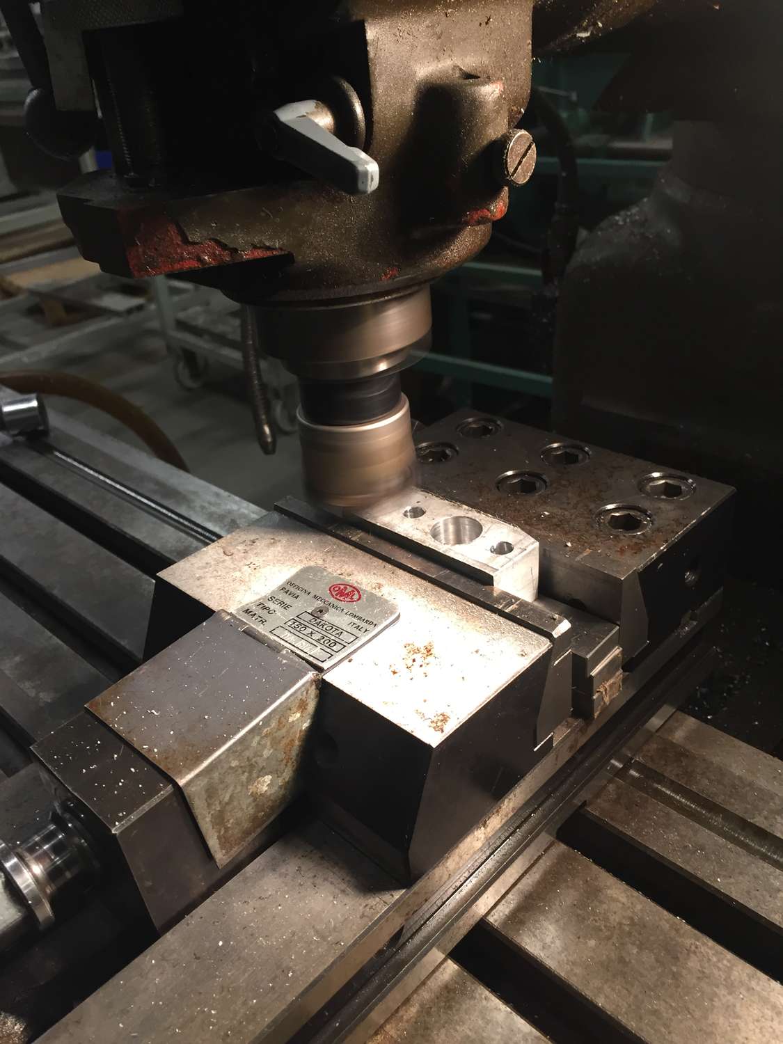

Ortega_9 Posted January 24, 2018 Author Posted January 24, 2018 I can see that the aam spacer comes with an oil pick spacer. So i'm gonna go ahead and make one. 1 Quote
.:Bullen:. Posted January 24, 2018 Posted January 24, 2018 12 hours ago, Ortega_9 said: I can see that the aam spacer comes with an oil pick spacer. So i'm gonna go ahead and make one. I have the jwt oil pan spacer on my twin turbo & you need an oil pickup spacer in between the pickup as it then puts it further down into the oil. It can pickup from the bottom & not get starved going round corners etc 1 Quote
Keyser Posted January 25, 2018 Posted January 25, 2018 If you wanted to be really on it you could weld a baffle plate in as well, and yes to the spacer they usually have one with the kit. 1 Quote
Ortega_9 Posted January 25, 2018 Author Posted January 25, 2018 10 hours ago, Keyser said: If you wanted to be really on it you could weld a baffle plate in as well, and yes to the spacer they usually have one with the kit. Is the vq known for Oil starvation? And with the Oil pan spacer the pickup gets another inch lover than the surface of the Oil in the sump. And it beeing such a "narrow" sump i Would Think it will be covered all the time. And i just painted the Oil pan... ;-) i might get the greddy sump at some point. But that will be baffled, i guess it already is.. i Think I'll "just" get the spacer machined and be done with it for now. Quote
Keyser Posted January 25, 2018 Posted January 25, 2018 It should be fine with the spacer as it sits in more oil, not known for oil starvation if they have plenty in, I had the greedy and as you say it is baffled, a baffle is more for long hard corners where the oil climbs the side. I think you will be fine Quote
Ortega_9 Posted January 26, 2018 Author Posted January 26, 2018 Using my spare time at work right, getting my oil pickup spacer knocked out. 1 Quote

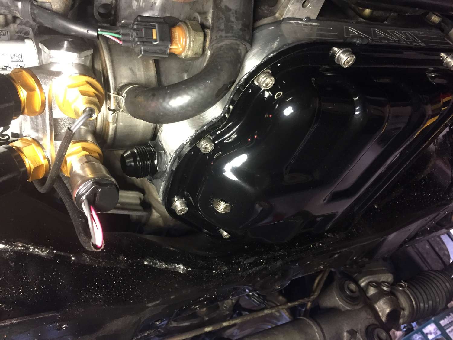

Ortega_9 Posted January 27, 2018 Author Posted January 27, 2018 Just done the Oil pan and spacer, and trying to fit everything Else... to much going on here, so i might have to get an Oil filter relocation sandwich to get the gauge sensors and filter away from this mess 2 Quote

Ortega_9 Posted January 28, 2018 Author Posted January 28, 2018 (edited) Ok, i Think i solved the issue with having to much traffic in one place. I took the sensor/oil cooler sandwich plate and turned it 180* then the gauge sensors is on top. I Can reach and service the thermostat. And with a pair of 90* an10 fitting i Can reroute the Oil cooler Lines around everything and still have room for Oil pressure sensor, Oil feed for the turbos and Oil filter.... still alot going on. But i Would hate to also have an Remote Oil filter sandwich and Lines added to the mix, so this is the Best option i Think..... And it gets easier to change the filter becouse of not having the gauge sensors at the bottom... Edited January 28, 2018 by Ortega_9 Spelling like a **** Quote

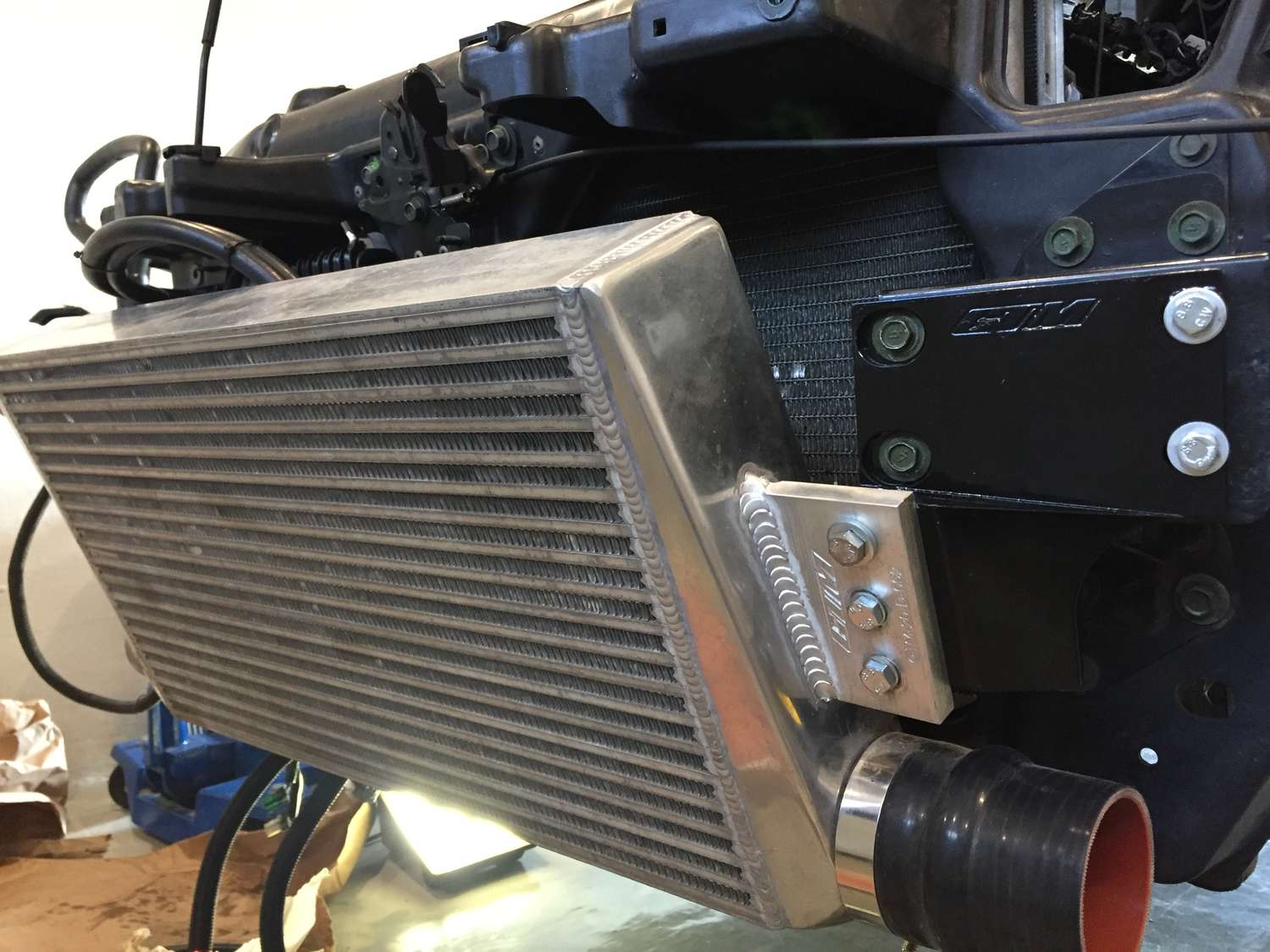

Ortega_9 Posted January 28, 2018 Author Posted January 28, 2018 (edited) Test fitting the IC. making sure all pipes, Lines etc. Can go where they need to be before i cut any hoses to lenght.... Edited February 2, 2018 by Ortega_9 Quote

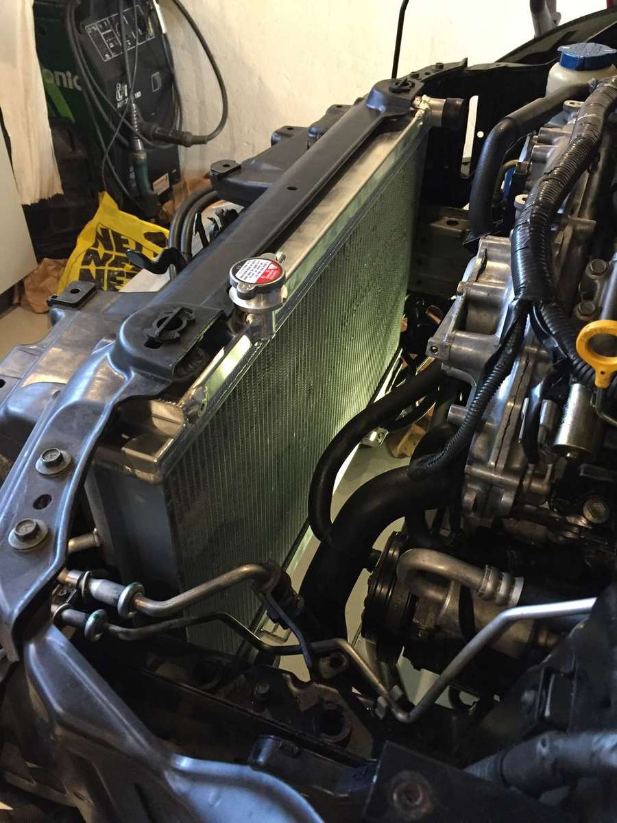

Ortega_9 Posted January 28, 2018 Author Posted January 28, 2018 Just pulled the old radiator. the new one is about Double the size. Quote

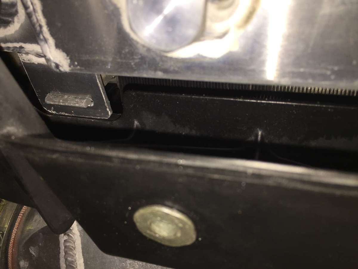

Ortega_9 Posted January 28, 2018 Author Posted January 28, 2018 And almost in. i Can see that i have to trim the front member to get the radiator to sit like the stock one. i need about an inch more to get it to fit. Quote
Ortega_9 Posted January 28, 2018 Author Posted January 28, 2018 Fitted. took 8mm off the brackets for the a/c cooler both top and bottom on the radiator, and cut new holes for the AC brackets. now everything sits like it should. 1 Quote

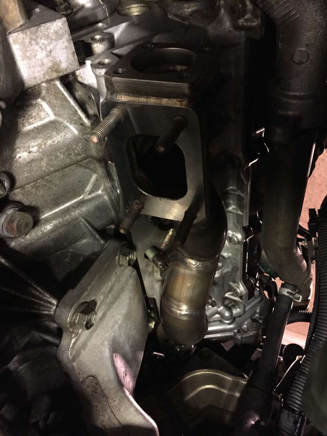

Ortega_9 Posted January 31, 2018 Author Posted January 31, 2018 (edited) the new bolt patern of the new manifold calls for all pinbolts to be moved. So cleaning a bit to get the best seal when the new manifolds go on. Edited January 31, 2018 by Ortega_9 Quote

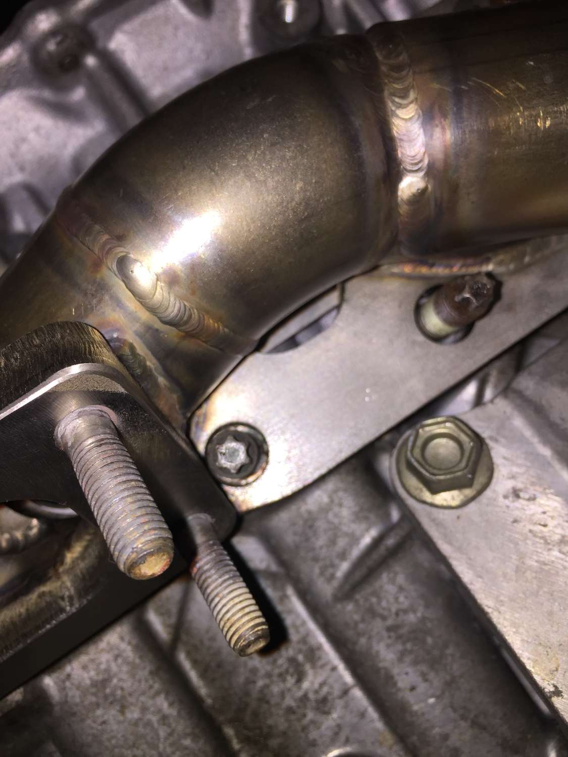

Ortega_9 Posted January 31, 2018 Author Posted January 31, 2018 (edited) And trying to get the new manifold on presents some issues, i might need to machine a bit off the turbo flange in order to get room for the bolt. But this is the biggest and Highest flowing design possible for the manifold, so i knew there would be issues. otherwise it looks fine... so not all bad. But needs more work Edited January 31, 2018 by Ortega_9 Quote
Ortega_9 Posted January 31, 2018 Author Posted January 31, 2018 (edited) Having taken the manifold off and put it back on the "mockup" engine, i have found a solution... i Think.... if i put the most forward nut on first, and have the manifold at an angle, tilting out at the rear, i can fit a locknut in a small dent i grinded out of the flange, and this will stay in the indentation as i tighten it. i hope this works. Edited January 31, 2018 by Ortega_9 Quote
Ortega_9 Posted February 1, 2018 Author Posted February 1, 2018 I have just finnished fitting the right side manifold. it worked... and actually wasen't so bad. i had to hacksaw a few wrenches to get the two locknuts on, but otherwise no problem. Quote
