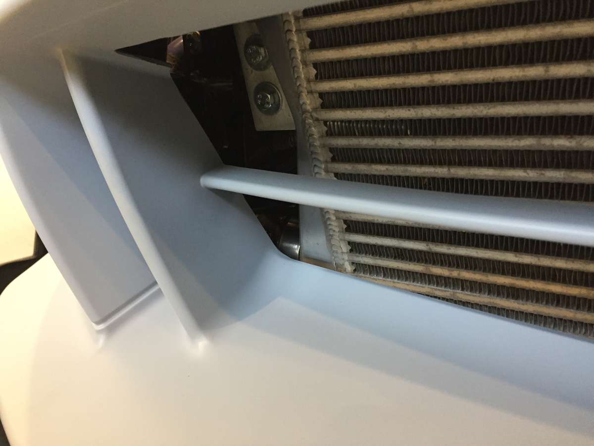

Ortega_9 Posted April 2, 2019 Author Posted April 2, 2019 There is just nothing compared to oem... everything just Lines up. nothing has to be cut to fit it. even the side intakes direct air straight into the intake filters of the Gtm tt kit.... 2 Quote

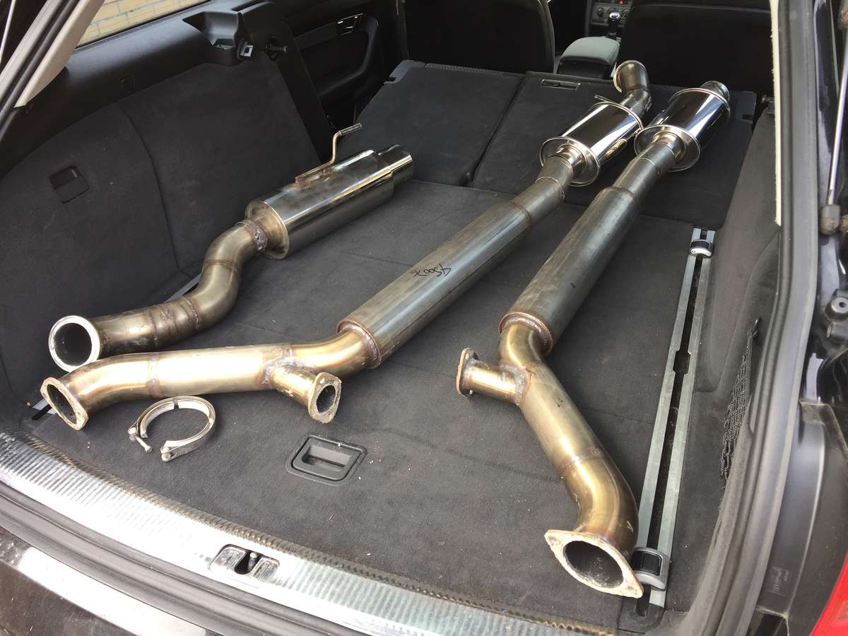

Ortega_9 Posted April 4, 2019 Author Posted April 4, 2019 The new exhaust setup is tacked up and ready for some torch time tomorrow at work.... 1 Quote
Ortega_9 Posted April 6, 2019 Author Posted April 6, 2019 Just finished the exhaust with the two Vibrant resonators... first impressions are that there is no noticeable difference when idleing. It's not suppose to supress Sound level, but i guess I was expecting some change in exhaust note. I still need to fit some pipework to the intake before I Can drive it, and see if it has done away with the droneing. now I need to get all the parts back from paint, and put it all together, then I'm about done and ready to get it back on the Road. Quote

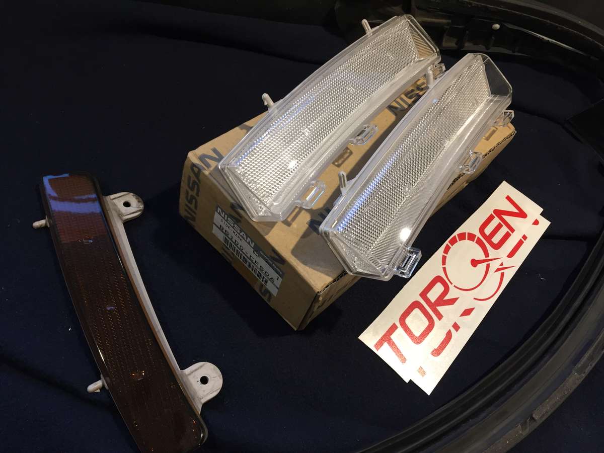

Ortega_9 Posted April 8, 2019 Author Posted April 8, 2019 (edited) Prepping the nismo v3 front bumper, putting some JDM Nissan clear reflectors in instead of the old amber non-facelift. VERY fast delevery, even here in mainland EU, from Torqen, and with stickers and chokolade even with such a "trivial" thing... great service Edited April 8, 2019 by Ortega_9 Quote
