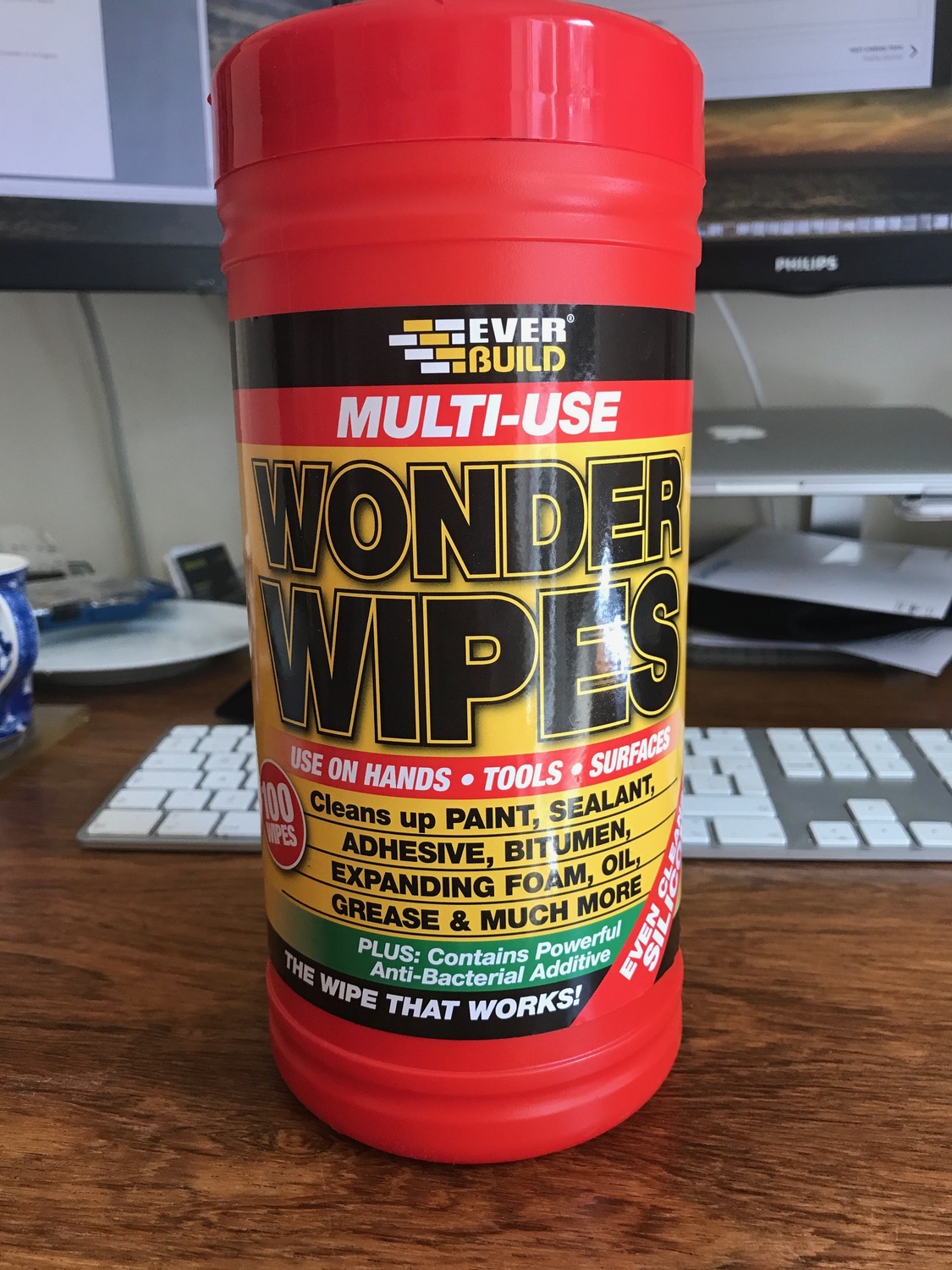

Jester Posted July 17, 2017 Posted July 17, 2017 I used these for the cleaning bit at least - came up a treat. The car had been treated when new with some sort of coating which has helped keep it looking mint all these years but the lights were almost yellow - now crystal clear after a couple of wipes. Label sounds like they would strip anything off anything, but they are not that powerful so happy to use on the car (alloys, lights, plastics) Will have a look at re-coating them now I have seen this Quote
