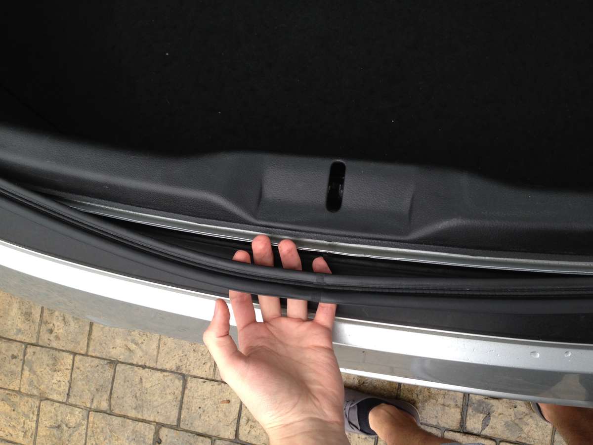

2. Pull the rubber seal strip up out of the way
This just makes it easier to get the trim off and on.
