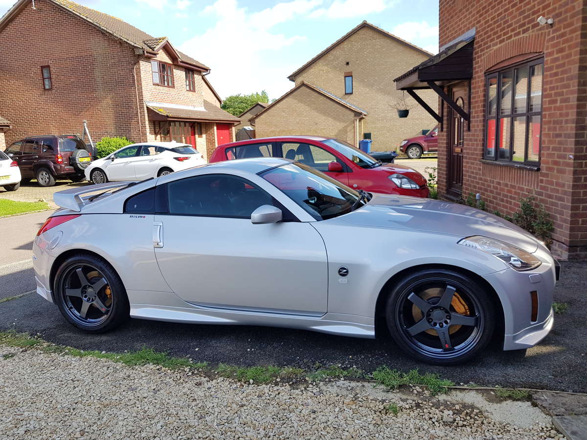

I had my LMGT4s powdercoated in gunmetal grey just over 2 years ago, the car is silver and I wanted some contrast.
The finish is great and they look just as good now as the day I had them done.
Like Jack94 I opted for a single colour powder-coat finish instead of getting them re-diamond cut on my 18s:
(this was when i collected the car from the refurb before re-applying the decals)
You can see the centre caps are still the original finish for comparison.

Those look to be an excellent job must say! I just assumed I'd diamond cut again as I want them to look 'stock', but it seems like the difference might be relatively minor. I'll certainly keep that as an option.
