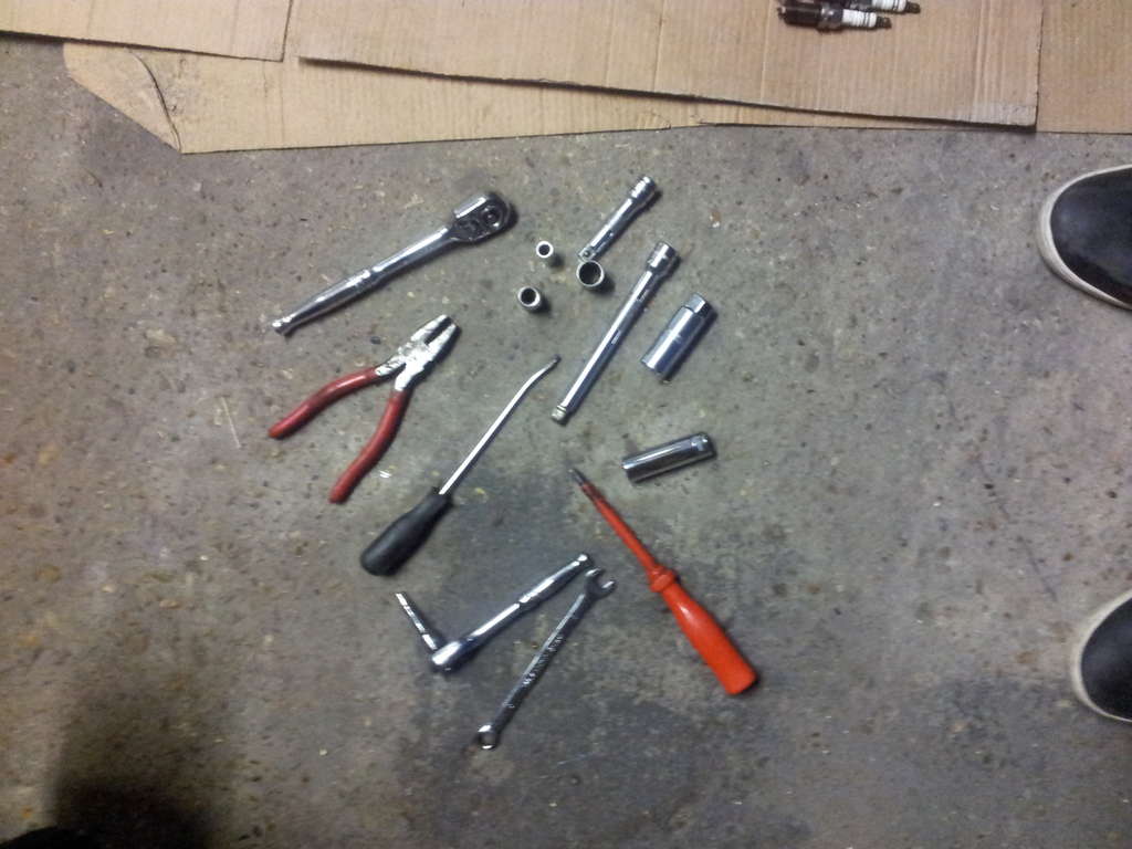

So first things first heres what i used:
ratchet x 2
2 x extension bars
8mm socket
10mm socket
14mm socket x 2 normal and long
Phillips head screw driver
flat head screwdriver
spark plug 14mm socket
Pliers
10mm spanner but dont need it, missed a bolt and used it to get to where the socket couldnt!
This is purely everything i used feel free to add anything you think i may have used to make life easier.

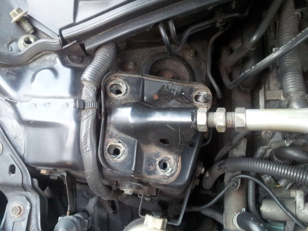

First things first: Remove the strut brace, 6 x 14mm bolts 2 x 14mm nuts:
The black plastic you can see here holds the cables to the strut, this need to be slid off towards the engine:
this is the underneath once removed:

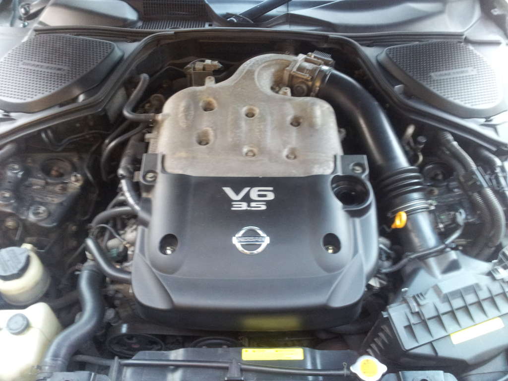

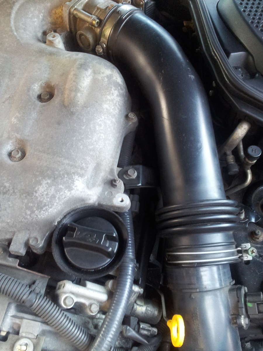

you then need to remove the engine cover, remove the oil cap first:
you can see from the above picture 2 x 10mm bolts and 2 x 10mm nuts on the black cover remove those:
Then you need to remove the air intake pipe, pretty easy, 2 jubilee style clips at each end, for the airbox end, i used a 10mm socket but you can use the phillips too:
the other end, either a flat head or an 8mm socket:
slide the end off closest to the air box, i assume that why it has the softer plastic end:

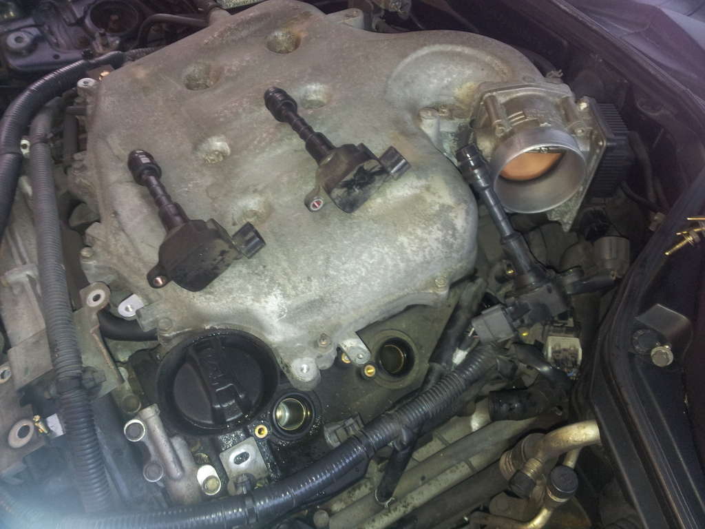

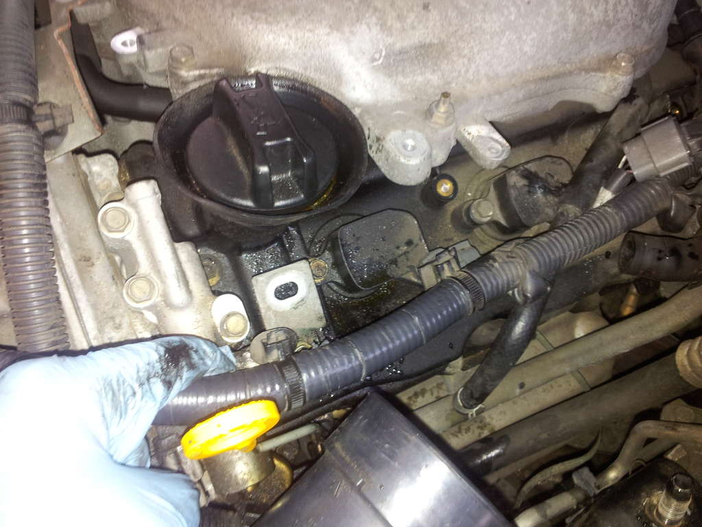

your ready and set now to start removing the coils/cables in the way! firstly i unplugged the coil main plug, underneath it, directly next to the first coil is a 10mm bolt, remove it it holds a bracket, this gives you some space to get to the coil:
There is a bracket on the front of the engine, 2 x 10mm bolts and 1 x 10mm nut, remove this too:

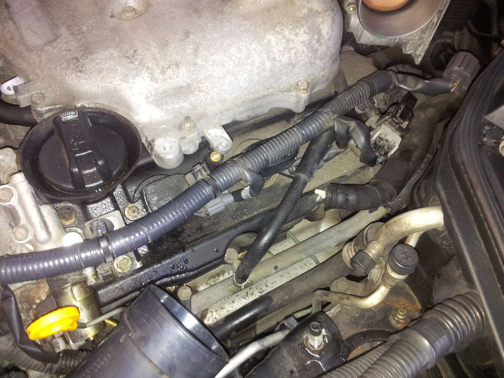

If you have the patience, you need to get the pliers or if you have any, some long curved thin nose pliers to the bottom of these clips, they are the same clips that hold the cables to the strut bar, they need pinching underneath, thankfully, the previous owner has obviously taken it somewhere local that are useless or done it themselves before as several of mine are broken, as you can see you will now have easier access to the coils for removal (ignore the water spill):
easier access:
Looking at the picture above, unplug all the coils 3 x push in and pull plugs, easy to do by hand. and remove the 10mm bolt you can see holding the coils in
i left the far right plug still plugged in as it was easier to get out, and didnt make much difference:

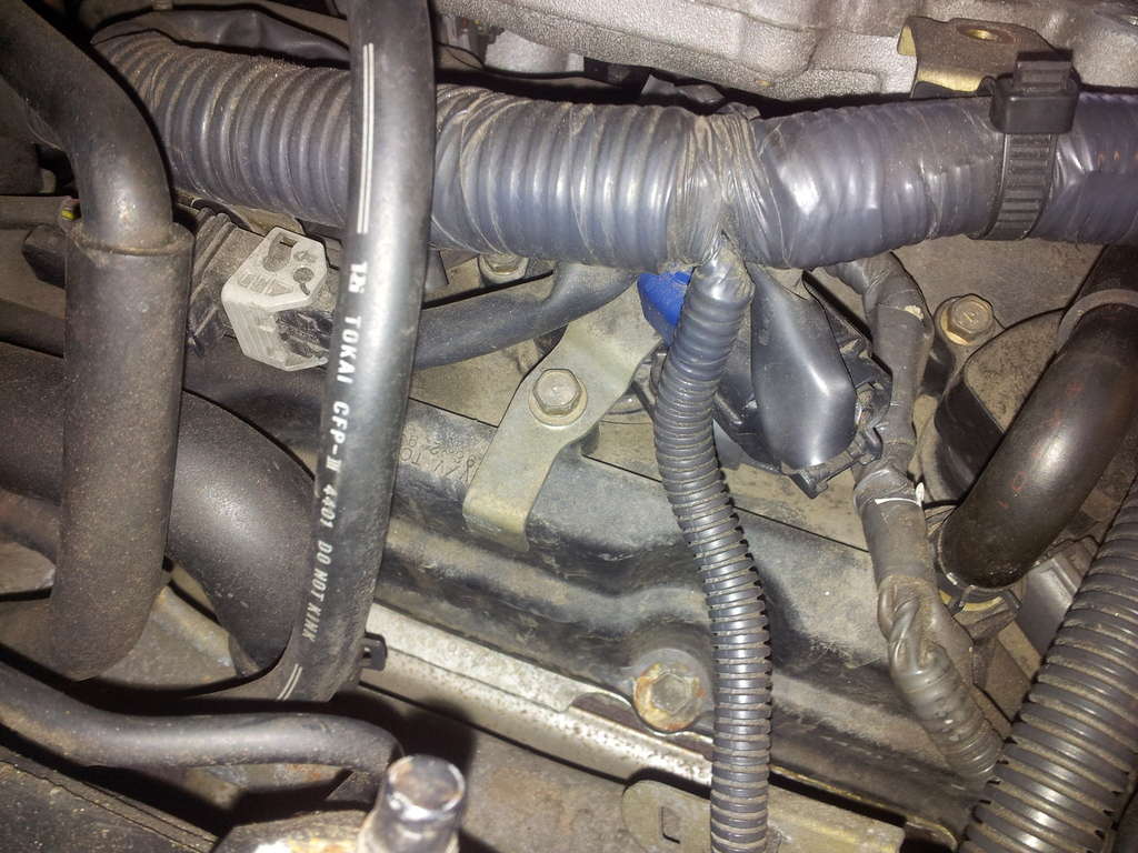

Other side the trickier one, starting with another bracket located at the front left of the plenum 10mm bolt, remove:
There is another 10mm bolt holding another bracket as you can see here marked M2 remove this bolt:
The bolt here another 10mm you can see dead in the middle of the photo, remove this as its another bracket:

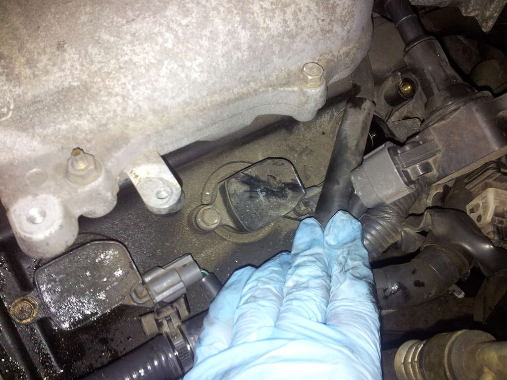

unplug the first coil, one closest to the front of the car:
If you can, get your hands in and remove the other plugs, the cables have some slack now all the brackets are removed so its easier to hold them out the way with one hand, undo the clip with the other, please note its still pretty tight working space!:
