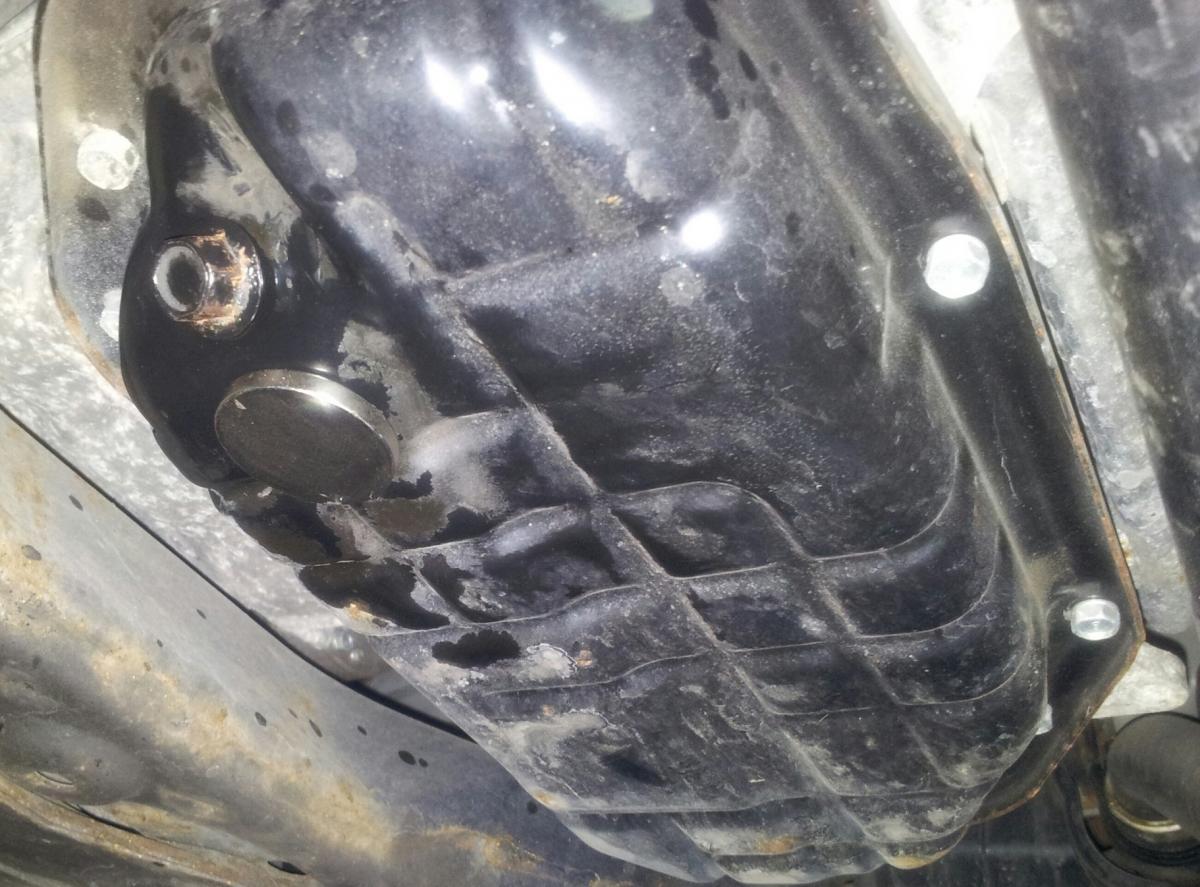

Oz Striker Posted December 25, 2014 Posted December 25, 2014 (edited) I wouldn't use one of those aftermarket magnetic drain plugs, they are known for shearing. You can achieve the same effect by sticking a neodymium magnet close to the drain plug, just remove before draining oil. Edited December 25, 2014 by Oz Striker 1 Quote
Chromatic Posted December 28, 2014 Author Posted December 28, 2014 I wouldn't use one of those aftermarket magnetic drain plugs, they are known for shearing. You can achieve the same effect by sticking a neodymium magnet close to the drain plug, just remove before draining oil. Interesting. I loved the one I ordered (which is above) -- Threads great,.. I don't use power tools on the drain plug,.. don't over tighten/torque. And with the synthetics I go 10,000 between changes. If you really think I should change it out for a non magnetic drain plug,.. would you mind linking me a drain plug that is preferable? I'm due to change it out as I've put 9800 miles since last change .. Thanks Quote
Oz Striker Posted December 30, 2014 Posted December 30, 2014 I wouldn't use one of those aftermarket magnetic drain plugs, they are known for shearing. You can achieve the same effect by sticking a neodymium magnet close to the drain plug, just remove before draining oil. Interesting. I loved the one I ordered (which is above) -- Threads great,.. I don't use power tools on the drain plug,.. don't over tighten/torque. And with the synthetics I go 10,000 between changes. If you really think I should change it out for a non magnetic drain plug,.. would you mind linking me a drain plug that is preferable? I'm due to change it out as I've put 9800 miles since last change .. Thanks Theres a seller on ebay that sells plugs and washers: http://www.ebay.co.u...=STRK:MEBIDX:IT I guess I exaggerated when i said they are "known for shearing", I think it is unlikely for even an aftermarket drain plug to shear, but you do hear of it happening on the odd occasion on various forums. Another reason why at least on my BMW i avoid aftermarket plugs is that OEM plugs have a hollow centre, supposedly makes them easier to remove should it shear, but i dont think thats the case with the 350z plug. Also the BMW has an aluminium pan, so if the magnetic piece at the end of the plug was to come loose and dislodge, it could interfere with the oil pick up, but that's not a worry on the 350Z with its steel oil pan. So with a steel pan, it means you can just stick the magnet close to the plug on the underside of the pan itself. I wondered how affective it would actually be, so i checked with an oven tray, seems like it would do the job. Btw Chromatic, i like the Rhino ramps, where did you get them the US? I have a steel ramps i got from Germany, wide enough for 260 tyres and shallow enough incline for the Z, which makes life a bit easier, but they sure are heavy! 1 Quote
Chromatic Posted January 1, 2015 Author Posted January 1, 2015 I wouldn't use one of those aftermarket magnetic drain plugs, they are known for shearing. You can achieve the same effect by sticking a neodymium magnet close to the drain plug, just remove before draining oil. Interesting. I loved the one I ordered (which is above) -- Threads great,.. I don't use power tools on the drain plug,.. don't over tighten/torque. And with the synthetics I go 10,000 between changes. If you really think I should change it out for a non magnetic drain plug,.. would you mind linking me a drain plug that is preferable? I'm due to change it out as I've put 9800 miles since last change .. Thanks Theres a seller on ebay that sells plugs and washers: http://www.ebay.co.u...=STRK:MEBIDX:IT Yeah.. I searched around and found a box of 10 crush washers of proper size for 350Z for $4 on Amazon.. just takes a while to locate. I guess I exaggerated when i said they are "known for shearing", I think it is unlikely for even an aftermarket drain plug to shear, but you do hear of it happening on the odd occasion on various forums. Another reason why at least on my BMW i avoid aftermarket plugs is that OEM plugs have a hollow centre, supposedly makes them easier to remove should it shear, but i dont think thats the case with the 350z plug. Also the BMW has an aluminium pan, so if the magnetic piece at the end of the plug was to come loose and dislodge, it could interfere with the oil pick up, but that's not a worry on the 350Z with its steel oil pan. So with a steel pan, it means you can just stick the magnet close to the plug on the underside of the pan itself. I wondered how affective it would actually be, so i checked with an oven tray, seems like it would do the job. The magnetic plug I got just to get.. it's cheap,.. looks nice (even though you don't see it).. and a little magnetic bit won't hurt (certainly won't make a difference in the engine..) -- But will be interesting if any metal bits are even on it. It's solidly built/molded/cut.. I don't see any reason it would be weaker, cross thread , warp or otherwise get damaged with any more likelihood than the stocker bolt. I don't over torque the bolt down anyhow.. most people (or many) people just put that oil pan bolt on as tight as they can with their hands..(ratchet) -- not knowing any better. When it doesn't need a ton of force, and more force can be damaging and can not seal properly. There is a reason it uses a crush washer.. it's not just for looks, or hassle of replacing (although many don't replace it) Btw Chromatic, i like the Rhino ramps, where did you get them the US? I have a steel ramps i got from Germany, wide enough for 260 tyres and shallow enough incline for the Z, which makes life a bit easier, but they sure are heavy! Thanks. I bought them on Amazon as well. Yes, I use Amazon a lot. It has everything,.. and with Prime shipping it really saves money vs. local (no tax so far). But I've seen them locally here in autopart stores. The ones I bought are particularly useful for cars like the 350Z where they are naturally a bit lower than other vehicles and you need that gradual ramp up to not damage your bumper. They are light.. absolutely! I have a set of steel ramps I had for my mustangs years ago.. and I hate lugging those things around. The ramps are not only stronger than the steel (due to design) .. but a great deal lighter. Definite good investment for anyone who is planning on doing oil changes. I'm actually due for one right now. I just ordered the Mobil 1 5w30 synthetic,.. (I found with a discount 6 Quarts (350Z takes 5).. for $36 (shipped)) -- Can't beat that , as it's $8+ locally per quart. Then I already had an extra K&N Hi-Perf filter as I was sent two by accident last time I changed. I'm changing at 10,000 Miles (or 12 months.. whichever comes sooner). The mileage has hit much sooner lol. Quote
