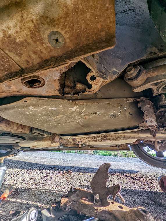

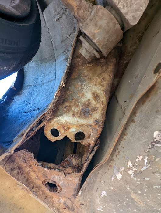

Well after a full engine rebuild and a trip for the MOT. looks like my zed is done, The mechanic spotted corrosion behind the kidney braces on the sub frame.
I have removed the W brace and Rear Stays and found it to be rotten. I could make a plate and weld it? first though the fuel tank is right there, and even if i remove it I'm worried about the inside catching fire. The only solution I can think of would be to bolt a plate on. the other side is the same.

I'm just looking up how much work it is to take the tank out and the carpets and scrape all the Factory rust coating that can catch fire also..
I'm paranoid about fire after seeing some one on YouTube attempt the same sort of repair and set fire to the car.
I would much prefer to us an original section and replace. What price can you do the parts for?

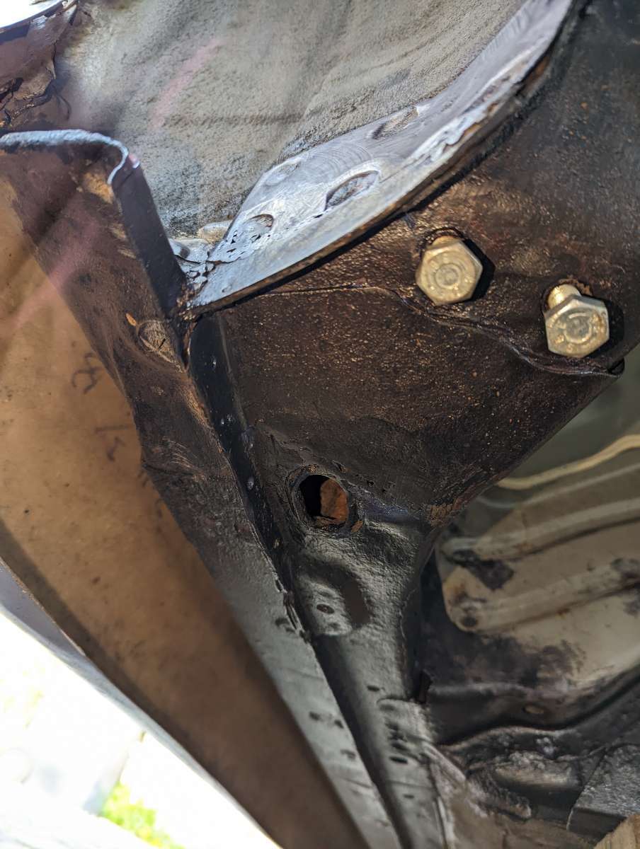

Absolutely no need to remove the tank etc.
A competent welder with the right equipment will weld in the repair sections without the risk of fire.
Oxygen/Acetylene welding techniques are  no longer used for this type of welding, so no naked flames, which would be a fire hazard.
I have done this job over half a dozen times in the shop over the years and as a guide it takes around 1.5 hours per side to carry out the welding, using an OEM repair section.
