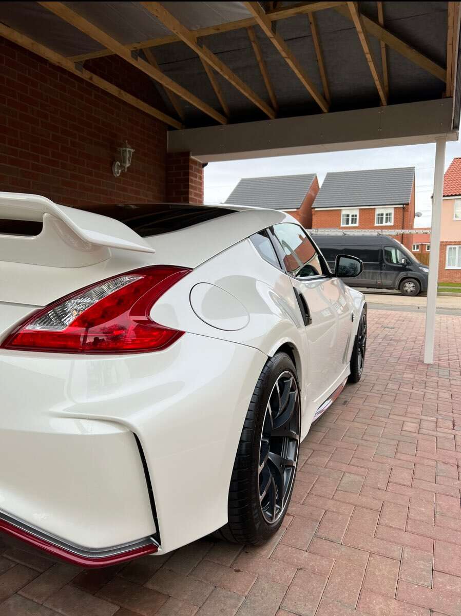

Willsy1980 Posted August 9, 2022 Posted August 9, 2022 (edited) Im not sure if it was a placebo effect, but I found it felt sharper and better grip all round. Less tramlining too ? When I removed the 15s from the rear and only had them on the front it was really tail happy due to the narrower track, the 5s fixed that. For note: Previous set up: Rear 285x40x19 with 15mm Spacer - Front 245x45x19 15mm Spacer Current set up: Rear 305x30x19 5mm Spacer (some edge rubbing under compression) - Front 265x40x19 15mm Spacer Previous set up was on the factory tyres. Current set up, the grip is superb. You really have to send it if you want to break loose. Running on MP4S Image to show current set up arch filling etc Edit: Should add, I have a set of 15s was going to keep hold of the in case I went back to narrower tyres, that probably wont happen. So if you want them can do £45 posted, as long as its not Washington USA Edited August 9, 2022 by Willsy1980 Quote
