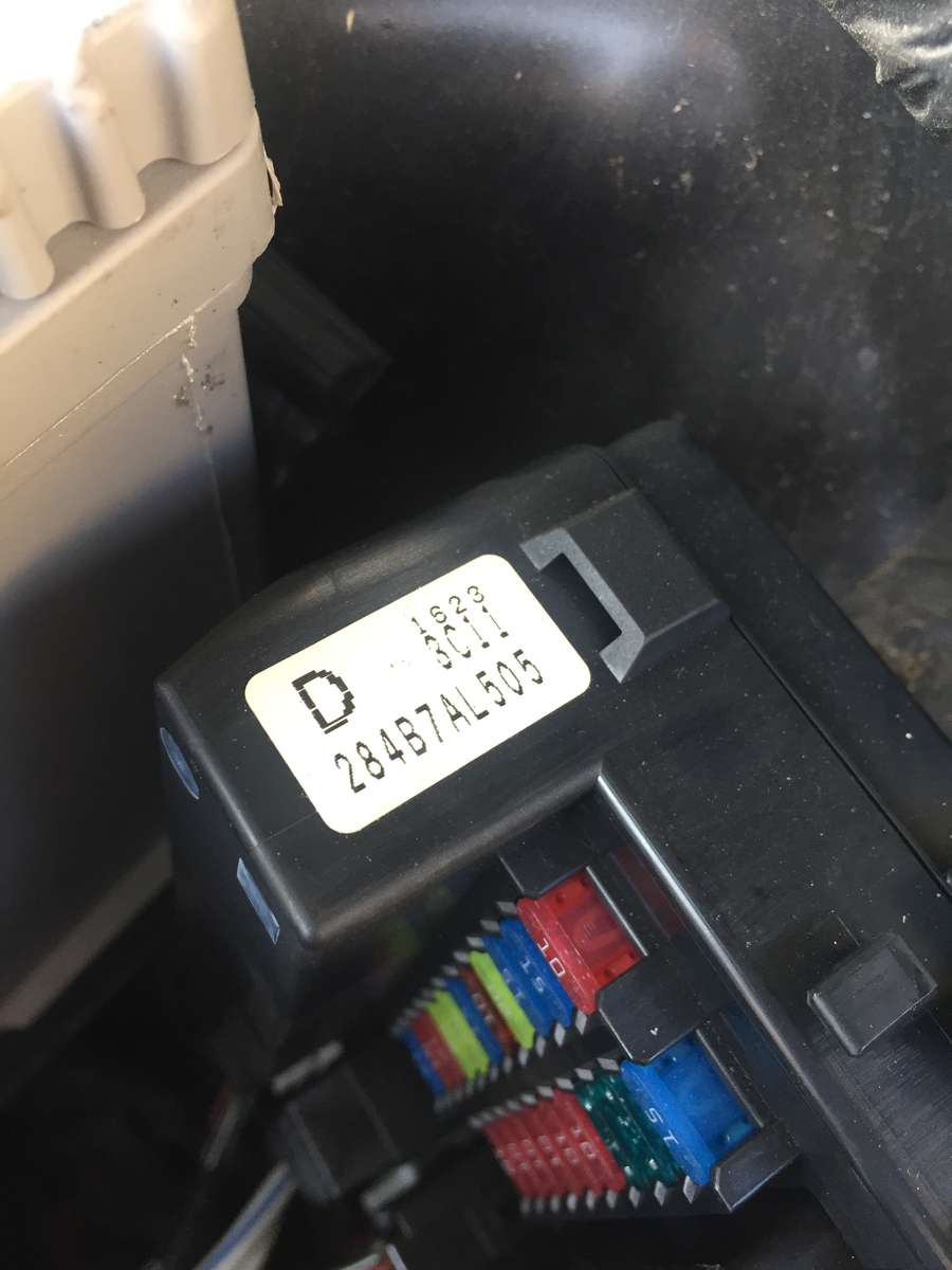

Forrest Posted April 12, 2020 Author Posted April 12, 2020 Hi Alex, further pictures attached? Pm me if you would rather, just couldn’t add photos there! The black and and white diagram I found online seems correct? Quote

Forrest Posted April 12, 2021 Author Posted April 12, 2021 Hi guys, Apologies, yes I did. £80 ECU off eBay, plug and play. Big thanks to Mark at Abbey motorsport who was very helpful. Turns out if you know the specific part number (important) of the ECU they can be found quite readily for sale on the web. Mark supplied me with that and there were a few available online. I had probably fried the previous ECU by tampering with the battery too much. A lesson learned to get to the bottom of smaller problems before you create bigger ones! Thanks Adam 1 Quote
