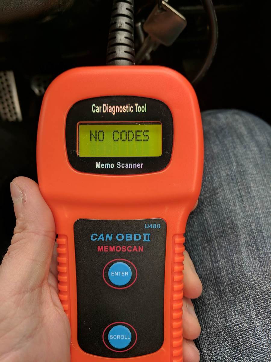

BigJames Posted September 12, 2017 Author Posted September 12, 2017 Ordered one of the code readers that @ZMANALEX recommended and No codes were found... Seems to have been an intermittent glitch since it hasn't happened again Quote
