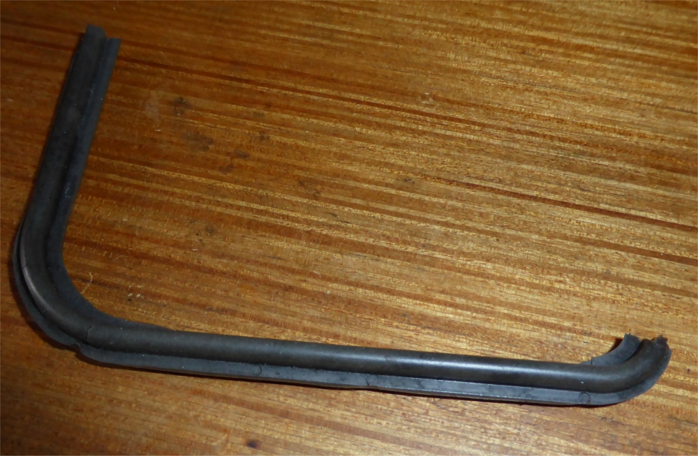

neo Posted December 14, 2015 Posted December 14, 2015 The other morning i noticed a small piece of what looks like a foam seal dangling from the underneath the rear bumper near the left exhaust tip, without thinking i snapped it off , had a look under the bumper, both sides but cant see where it might have come from, have attached some pictures it was in one long length, dried it out with a cloth and it broke, no idea how long it had been hanging down tho. it's about 1cm across and 17 cm long, anyone know what it's for and is it important ?? Quote
bigjackb Posted December 15, 2015 Posted December 15, 2015 There is a small vent in each corner of the boot behind the foam stuff. That is the seal from the vent. If you have a look at your boot floor you may find you have a little puddle forming. Quote

neo Posted December 20, 2015 Author Posted December 20, 2015 Just checked, dry as a bone in the boot, are the vents in the boot or under the false floor as i couldn't remove the corner polystyrene unit but got my hand under and no damp at all, hopefully it will stay that way there is large vent tucked up on the left side and a smaller one on the right, surely the seal couldn't be from there ? *edit* http://www.courtesyp...components-scat guess its part number 14 - http://www.courtesyp...e&position=left or is that for outside the car behind the rear bumper Quote
bigjackb Posted December 20, 2015 Posted December 20, 2015 The vents are under the polystyrene stuff under the false floor. It certainly looks like it would be the seal however if there isn't any water in your boot I probably wouldn't worry about it! Quote
