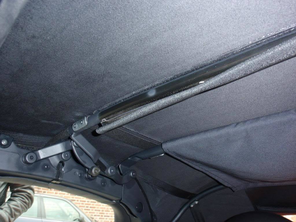

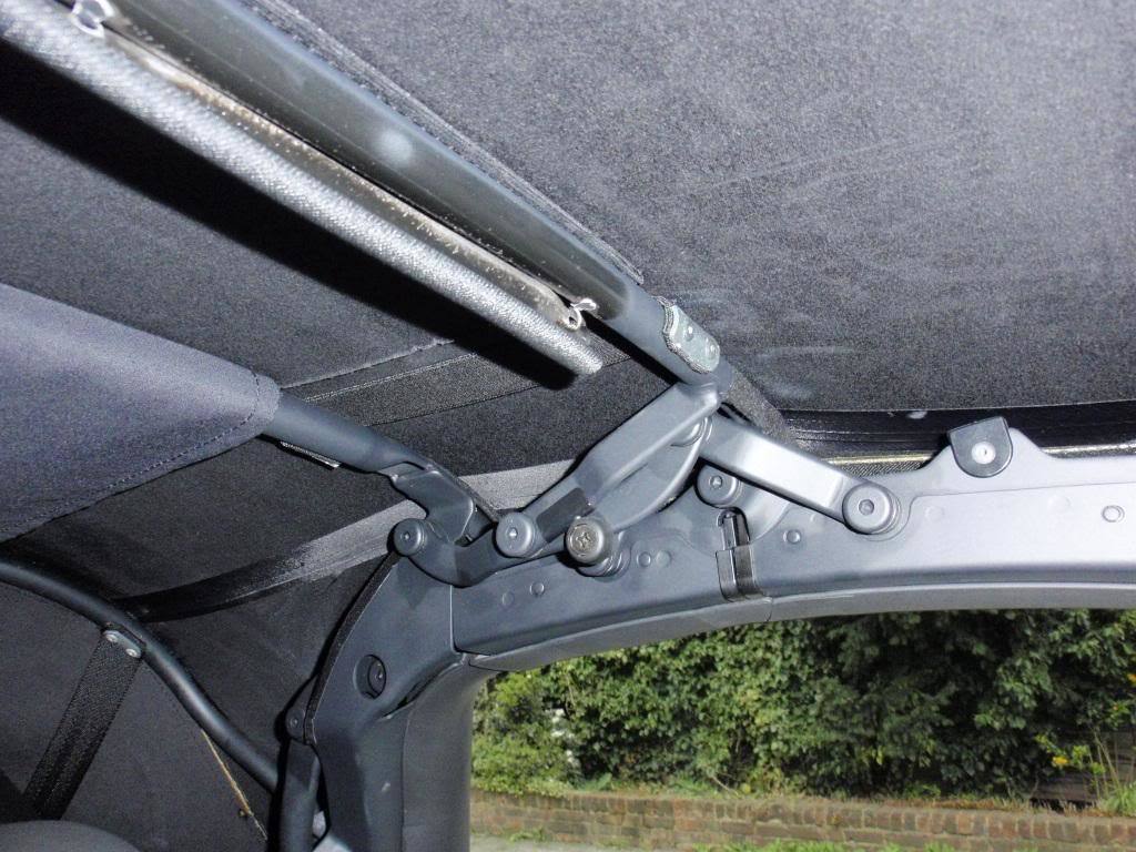

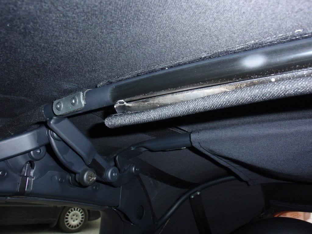

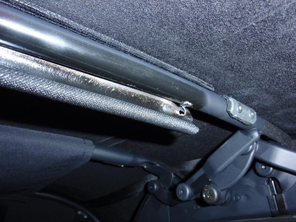

leebottrill Posted November 17, 2014 Posted November 17, 2014 Hey guys. I'm starting to get worried. These photos are not mine, but this is precisely what is happening to my roof right now! Has anyone roadster owners had this problem? I've got it booked in to Nissan exeter next weekend! I believe this has happened when i have tried to put the roof down in the colder weather. Any advise or help would be much appreciated Quote
zebedy Posted November 17, 2014 Posted November 17, 2014 Seriously, if your car is not under warranty dont take it to a dealership. They know nothing about these roofs. I can see properly from the pics whether these are riveter or bonded on. If this section is rivited on, just drill em out and re-rivet them with a small 10mm Washer to prevent them from pulling through again. Use some glue too like contact adhessive. Dealer will only do the same and charge you a fortune. You can pick up a rivet gun for 8 quit in machine mart. The roof should not be opperated under a certain cold temp. Not shure what at hand, as the roof material does indeed get stiff. If you need it down over winter make sure you have heating on in your garage or if not, put the heater on full blast in ya car for 20 mins which will soften the material. This is one of the main causes of the fith bow motor failure. Its weak as it is. Putting undue and extra loading on it from stiff material eventually leads to failure. Ill take a look at mine tonight and compare the same section and will get back to you Zeb Quote

leebottrill Posted November 17, 2014 Author Posted November 17, 2014 Mine aren't as bad as the photos, but they are getting worse. Its the rivets that have bent not the bar. I could just bend them back. But I wouldn't want to snap them off completely. I chatted to a guy in Exeter dealership and he sounded like he know what he was talking about. He's had a zed himself. I've emailed him this too. The roof still works and is lubricated regularly. If the dealership can't help, who can? :/ Quote

leebottrill Posted November 18, 2014 Author Posted November 18, 2014 Hi zzzebady. my roof works completely fine until the last 6 inches or so. This has happened in the past when the temp has been cold. but not its happening in the hot now! I am able to put the roof back up so i am not completely stuck! If you look at my photos above, you will see the bent metal where the material is held. I believe this is what is causing the problem. I think this is obstructing it at the last bit of the closing. I have found someone with this problem, and he just bend the bits back and it worked fine, but im a bit anxious to just start bending bits back. I am going to take it to this specialist and let them have a good look at it. They will give it a good lubrication at the same time, and hopefully fix the bent metal. Nissan said that piece couldnt be replaced, i would need to replace the whole fabric roof if they couldnt fix it, which seem silly, as the roof is spotless. Quote
leebottrill Posted November 19, 2014 Author Posted November 19, 2014 UPDATE. Had a chat with this guy in Plymouth. He runs Auto trim and has seen loads of 350z's in with roof problems. He couldn't say what it was without seeing it, but did say that the elastic straps above our heads need changing every 5 years, and when they weaken the roof may not retract property. Hence the material not folding correctly, hence the stressed metal. He thinks he can rivet the bent bar back into place (as mentioned above) Fingers crossed. I'll keep you all updated Quote
zebedy Posted November 19, 2014 Posted November 19, 2014 YE Hes correct regarding the elastic bands. Get them from nissan or cheaper from a habodashory's (sewing shop) but you will need a rivet gun to re-do these bands. its an easy job. If I was closer Id do it for you. Keep us posted Quote

leebottrill Posted November 26, 2014 Author Posted November 26, 2014 UPDATE. Roof fixed replaced the straps between second and third bar. Reattached the bent bit that holds the fabric down. Now works perfectly. £140. The rubber straps were £40 of that though. There called autotrim, located in ivybridge. Highly recommended. 1 Quote
