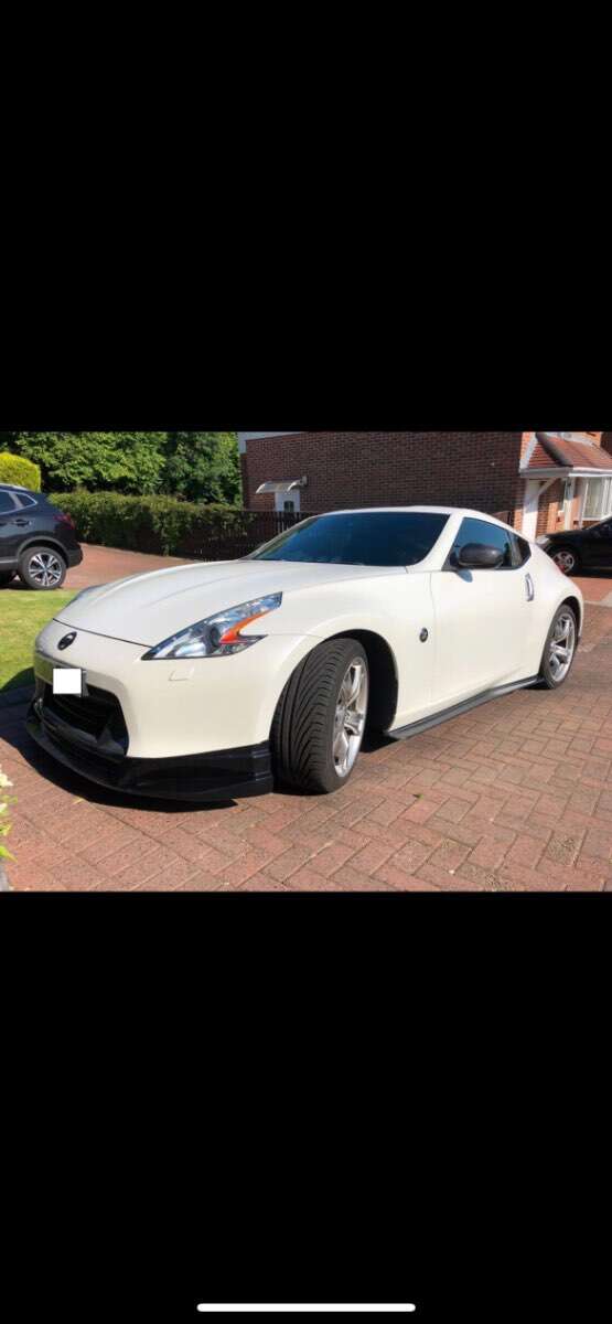

Hodgson Posted April 19, 2022 Posted April 19, 2022 Hey everyone. Had my 370z for almost 2 weeks now and wanted to document its mods and changes and problems I have along the way. many support and advice you csn all give me would be great. Here’s a few pics of how she looked when I bought her. GT model, pearl white and 60k on the clock. 1 Quote

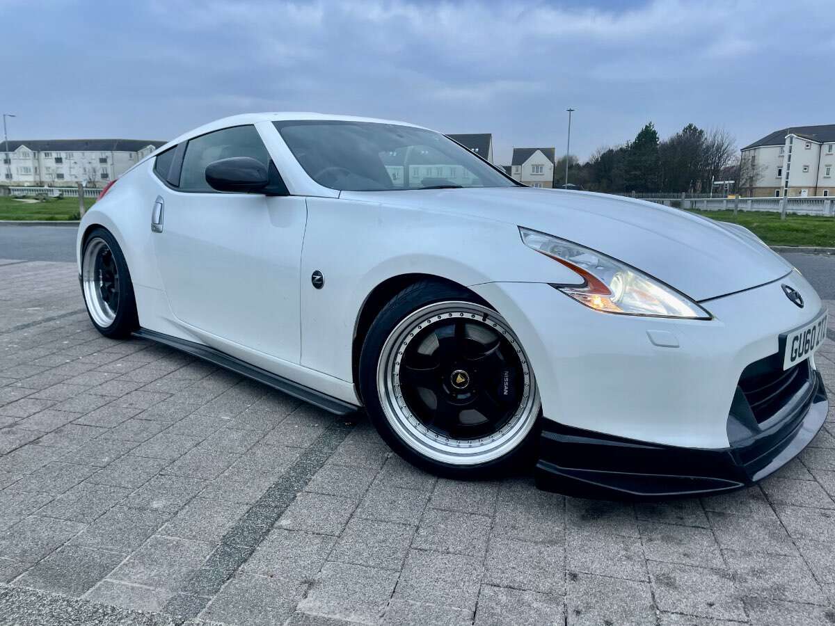

Hodgson Posted April 19, 2022 Author Posted April 19, 2022 Apologies the pics are upside down. Doing this on my phone 🙈 wheels fitted and then lowered it on H&R springs. I didn’t want to go full coil overs as I found the H&R springs really comfortable. 5 Quote

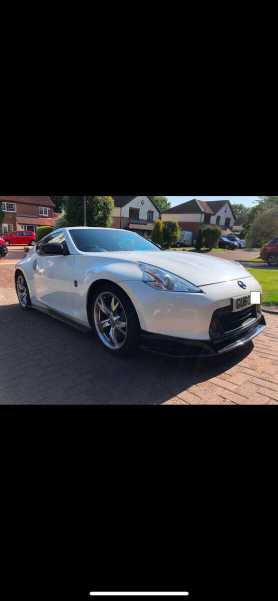

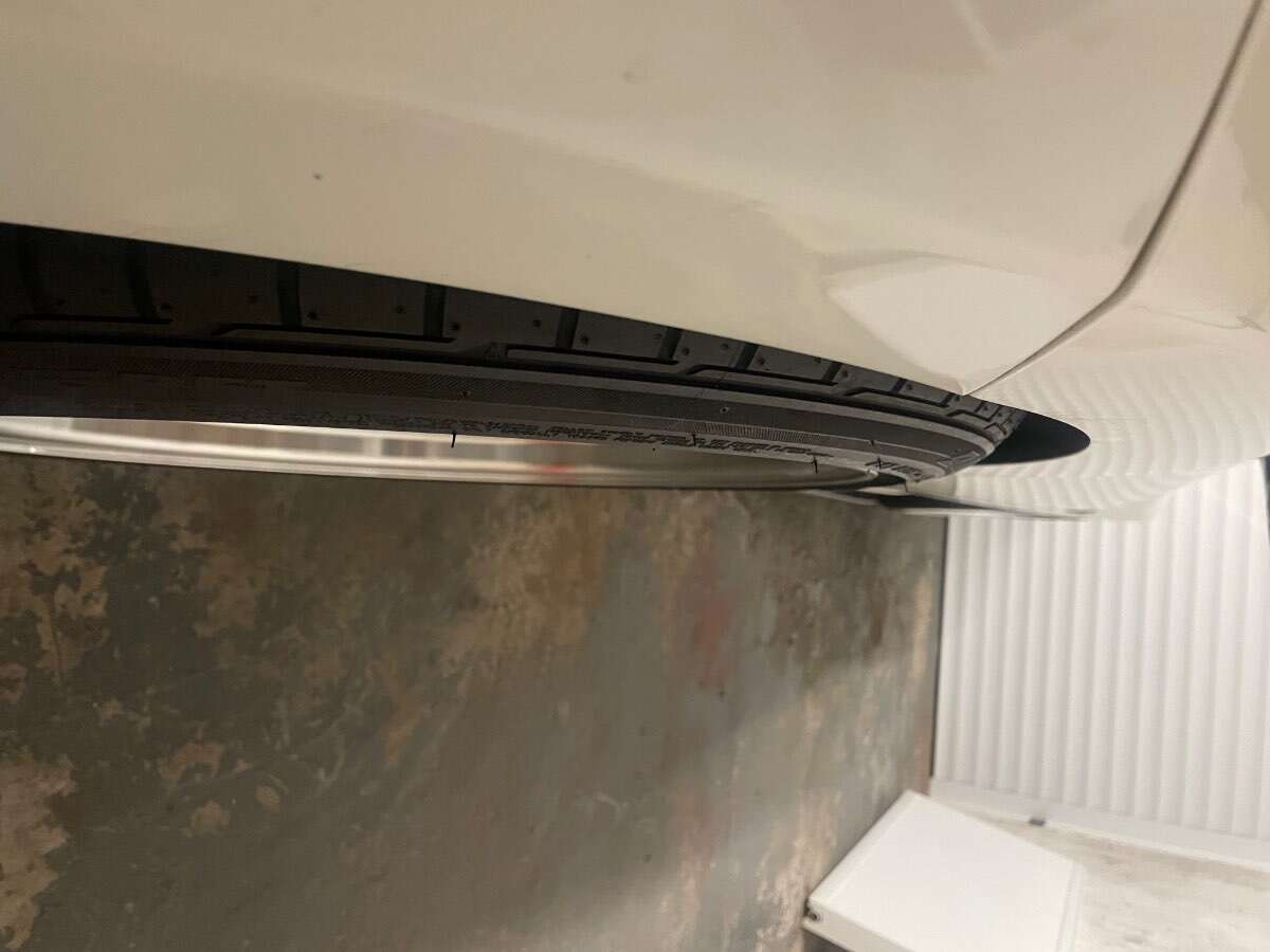

Hodgson Posted April 19, 2022 Author Posted April 19, 2022 Rear wheels are 10.5” but didn’t poke enough, so I added some 25mm spacers to the rear. 3 Quote

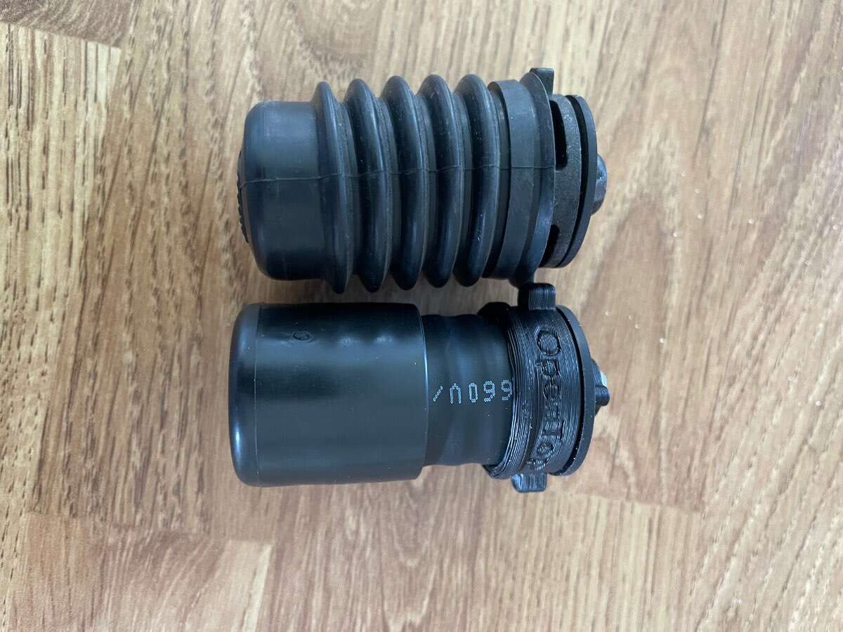

Hodgson Posted April 20, 2022 Author Posted April 20, 2022 Had an issue with the boot popping correctly. Not wanting to do the penny trick, I ordered a new set of updated springs and removed the weight from the boot. Pops nice now and don’t have to lift it to get the lock to disengage. next step is updated boot struts. I’d like the kid to open itself without lifting it. Quote

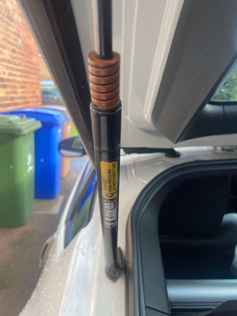

Hodgson Posted April 24, 2022 Author Posted April 24, 2022 Replaced the boot popper springs today. Nice easy job. Got the new items from openTop. You can see by the pictures they are a little longer and the springs are stiffer than the worn OEM units. It’s now quite a definite aggressive pop which I like Quote

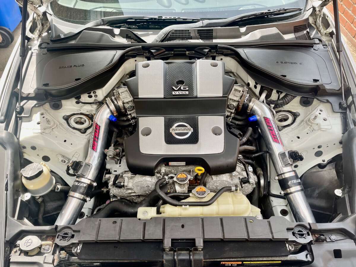

Hodgson Posted May 8, 2022 Author Posted May 8, 2022 (edited) There’s a few things gone on recently. After finding a weeping brake line I decided to change all of them for braided lines. I flushed the system and filled it with 5.1 fluid. Front discs and pads changed and also new caliper pins and clips. replaced both front drop links. fitted some Kanju bonnet and boot struts. I must admit, I’m impressed with the rear as the assisting springs open the boot from pressing the button with out lifting it. the bonnet dampers were a little big of a pain. Due to the pedestrian popper hinges I had to dress back the plug welds on the hinge to get the dampers to fit. After that, it was a straight install and they work great. next came the mess in the engine bay. The previous owner clearly never cleaned bothered cleaning it. I ended up using G3 to take all the grime off. Once that was done, I did a bit of a wire tuck on the ugly cabling that came across the strut towers. It looks a world better now. Twken the strut brace off and a couple of other brackets to go into work for a fresh powder coat in white and I’ll reassemble it all. I’ll post some pics in a bit 😁 Edited May 8, 2022 by shiney bits Quote
Hodgson Posted May 8, 2022 Author Posted May 8, 2022 This is how it looked after I removed the brace. Inner wings are filthy. Quote
Hodgson Posted May 8, 2022 Author Posted May 8, 2022 And after a few hours cleaning and I bit of a rewrite. 1 Quote
Hodgson Posted May 9, 2022 Author Posted May 9, 2022 Brace, wiring covers a PAS res bracket all refitted after a fresh coat of white powder. 2 Quote

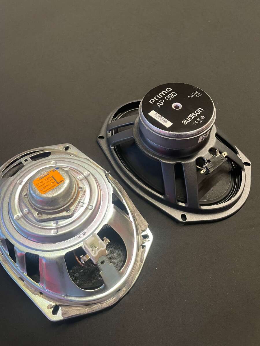

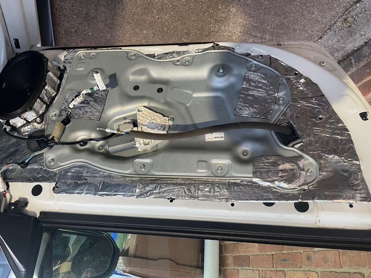

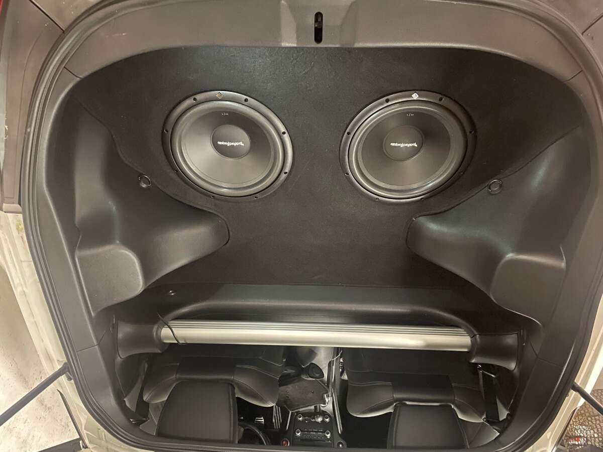

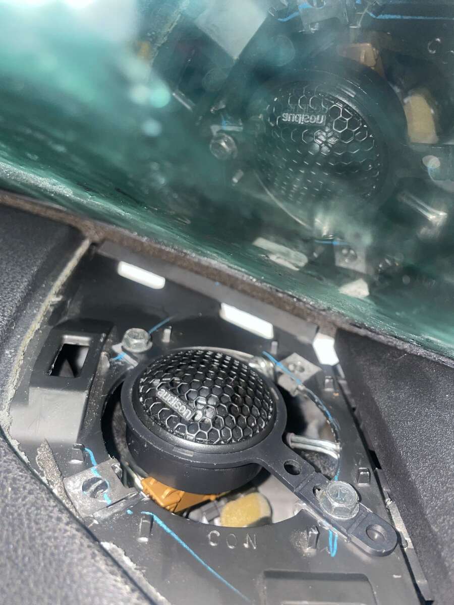

Hodgson Posted June 29, 2024 Author Posted June 29, 2024 Been a while since I updated this. The work hasn’t really stopped. I’m a lover of good music so fitted a full new sound system. Gone for a full sound deaden of the boot and doors. That made a huge difference on its own. I then fitted audison components in the front, 2x Rockford Fosgate 12” subs in the boot all powered by an Audison Forza digital amplifier. 1 Quote
Hodgson Posted June 29, 2024 Author Posted June 29, 2024 For some reason the pics have landed upside down. If an admin could sort that I’d be greatful 😁 Quote

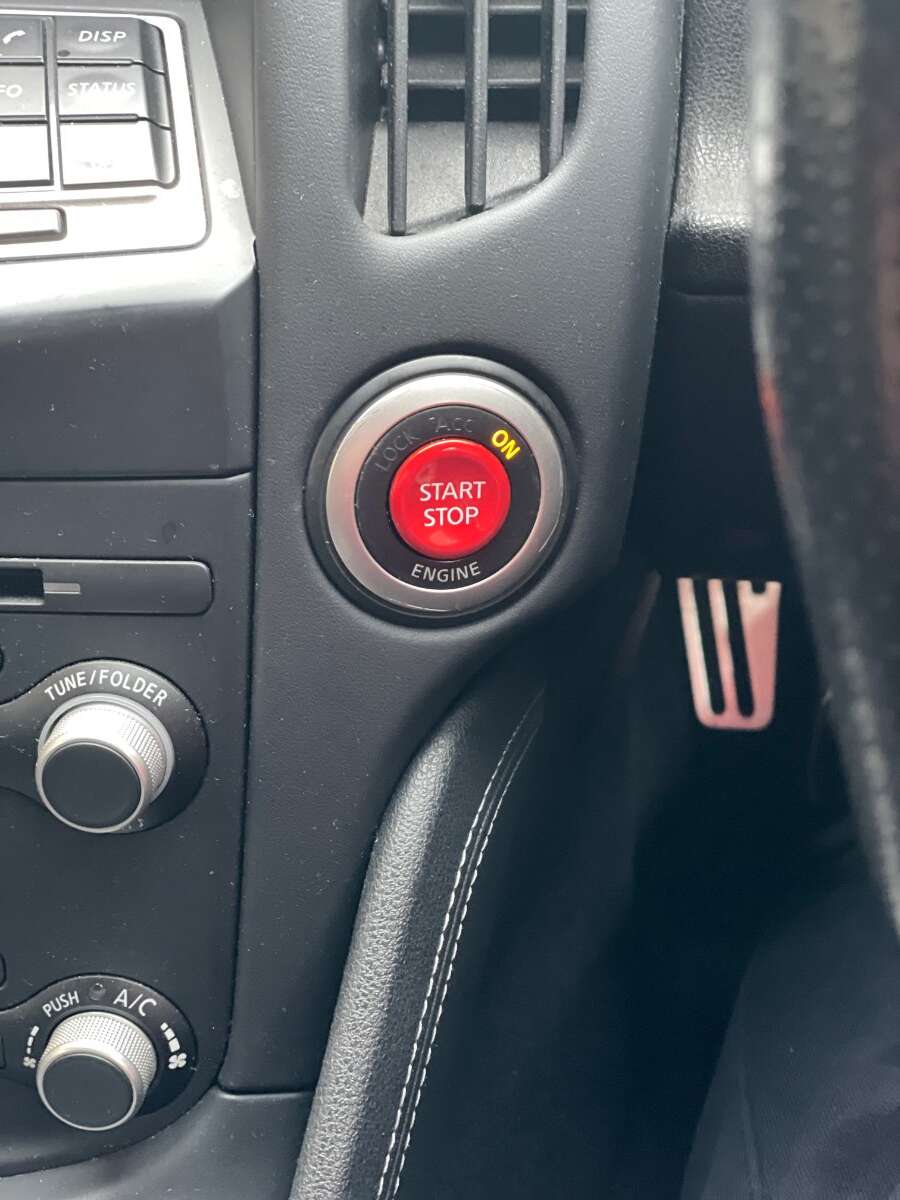

Hodgson Posted June 29, 2024 Author Posted June 29, 2024 Bonnet and boot dampers fitted and a GTR start button. 😁 Quote
Hodgson Posted June 29, 2024 Author Posted June 29, 2024 Engine wise, I want to supercharge the car next year, however, I want all the necessary stuff done before I do it. So first things first, the infamous oil gallery gaskets. I stripped all the front off the car but found a lot of bolts were seized and snapped off. Luckily, I cot them all out with Mole grips once everything was stripped. The only pain was one of the AC bolts wouldn’t budge and the bolt head rounded so had to be cut off. What made it worse is the pump then wouldn’t slide over the stud so I had to cut the pump off then weld a bit onto the stud and get it out that way. I’m really not impressed with the bolt quality so I’ll be replacing everything with stainless bolts. made some decent progress over the last week. Gaskets are done, although there was nothing wrong with the ones I took out but I’m sure they’d need changing at some point so I guess it’s future proofing. im going to fit an external oil cooler so I’ve removed the OEM modine and also the water lines together with the throttle body water lines as there just not needed. Which I was on tidying up the bay, I’ve also removed evap lines for the fuel tank vent on the back of the engine too. It’s the same system as my GTR and most people remove them on there so can’t hurt. Finally I’ve started a full PCV delete. I’ve stripped it all out and ordered all the parts to make my own kit. all the covers and pipes I’ve removed have gone to the powder coasters to be coated white. 2 Quote

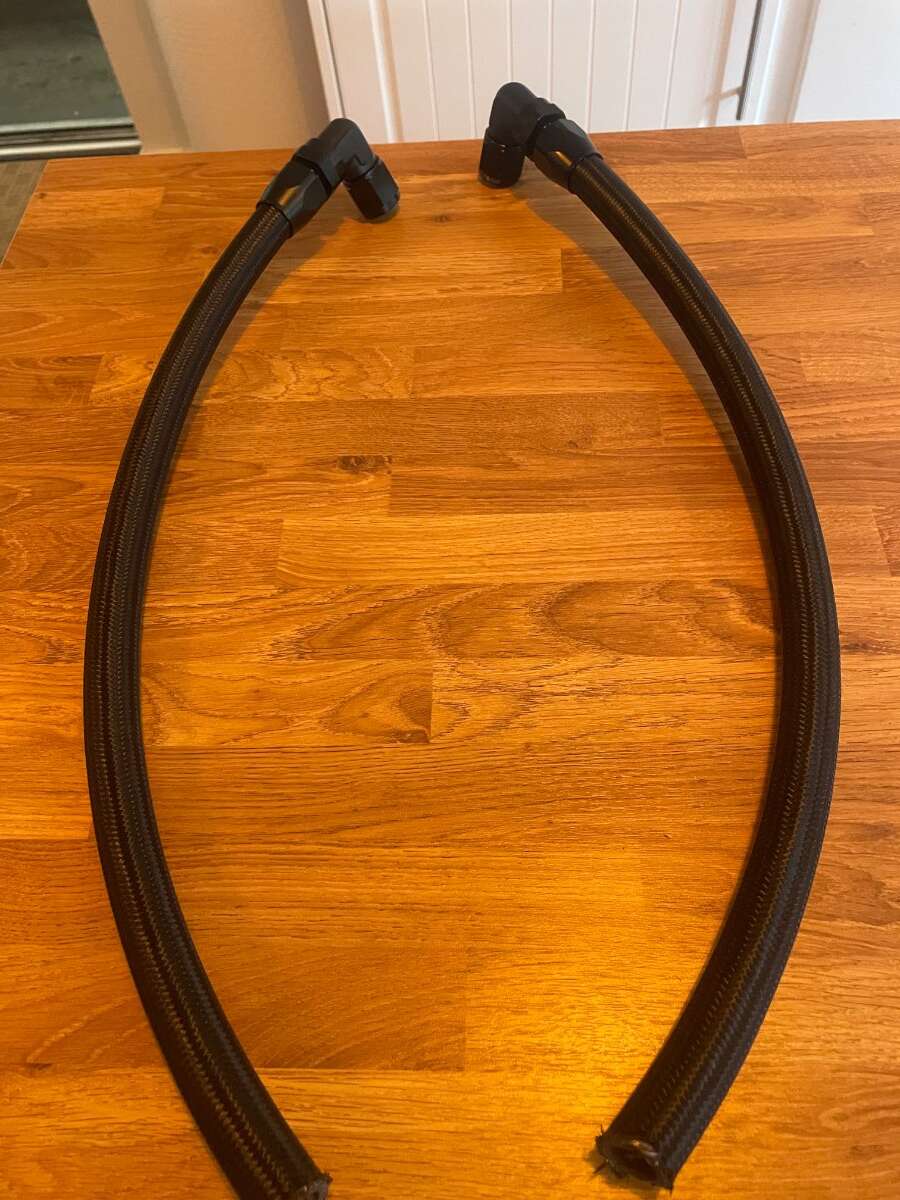

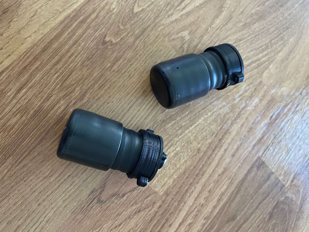

Hodgson Posted July 2, 2024 Author Posted July 2, 2024 Made up some breather lines for the PCV Delete today. Just waiting on some AN10 fitting for the cam covers and I’ll get all of this put together. Quote
