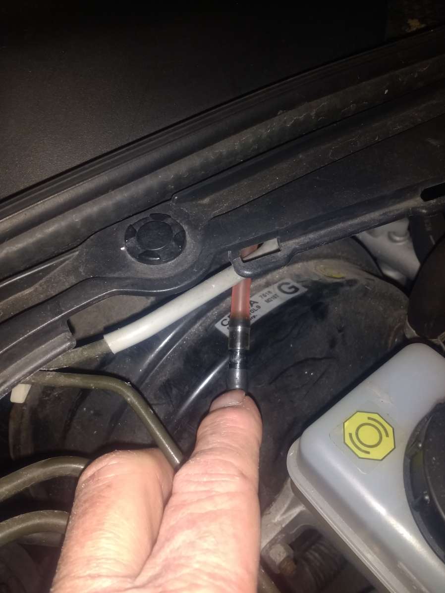

Lynchyy Posted April 3, 2021 Author Posted April 3, 2021 Ahh ok. Thanks for the info. Where about a is the 1 way valve situated? Quote
bluethermal Posted April 3, 2021 Posted April 3, 2021 Open the cover over the brake fluid reservoir/servo and et voila. 1 Quote
