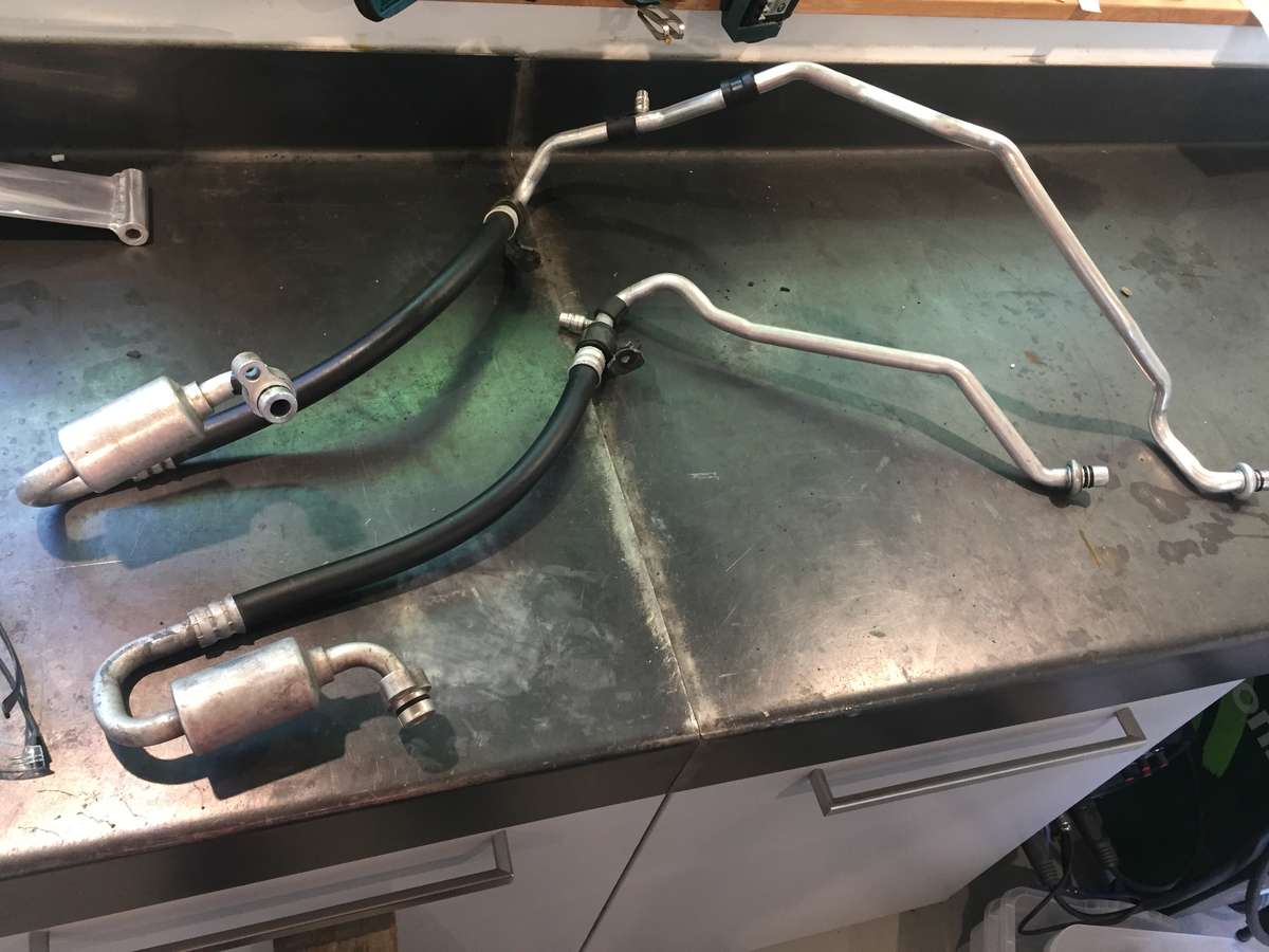

Ortega_9 Posted June 7, 2019 Author Posted June 7, 2019 Been doing some minor things lately, Got a new low pressure pipe for my A/C and I didn't think of the difference between rhd and lhd... so I now have a rhd pipe that dosen't fit, and a lhd pipe with a hole in it... so I'll have to try and source a lhd pipe. and also trimmed and painted my aftermarket boot struts. They always rubbed. After fitting I Can see that it's the gas cylinder thats hitting.... so need to redo the hinges, or get a original Nissan set of struts.... So not much succes... Quote
Ortega_9 Posted June 18, 2019 Author Posted June 18, 2019 Not having had the time to get anything done in a few weeks, I finally had some spare time to dig out the busted a/c Line.... Had to take alot apart to get to it, and I can't get the dame thing off, I have to make a tool of sorts to get the spring loaded fitting to part. Quote

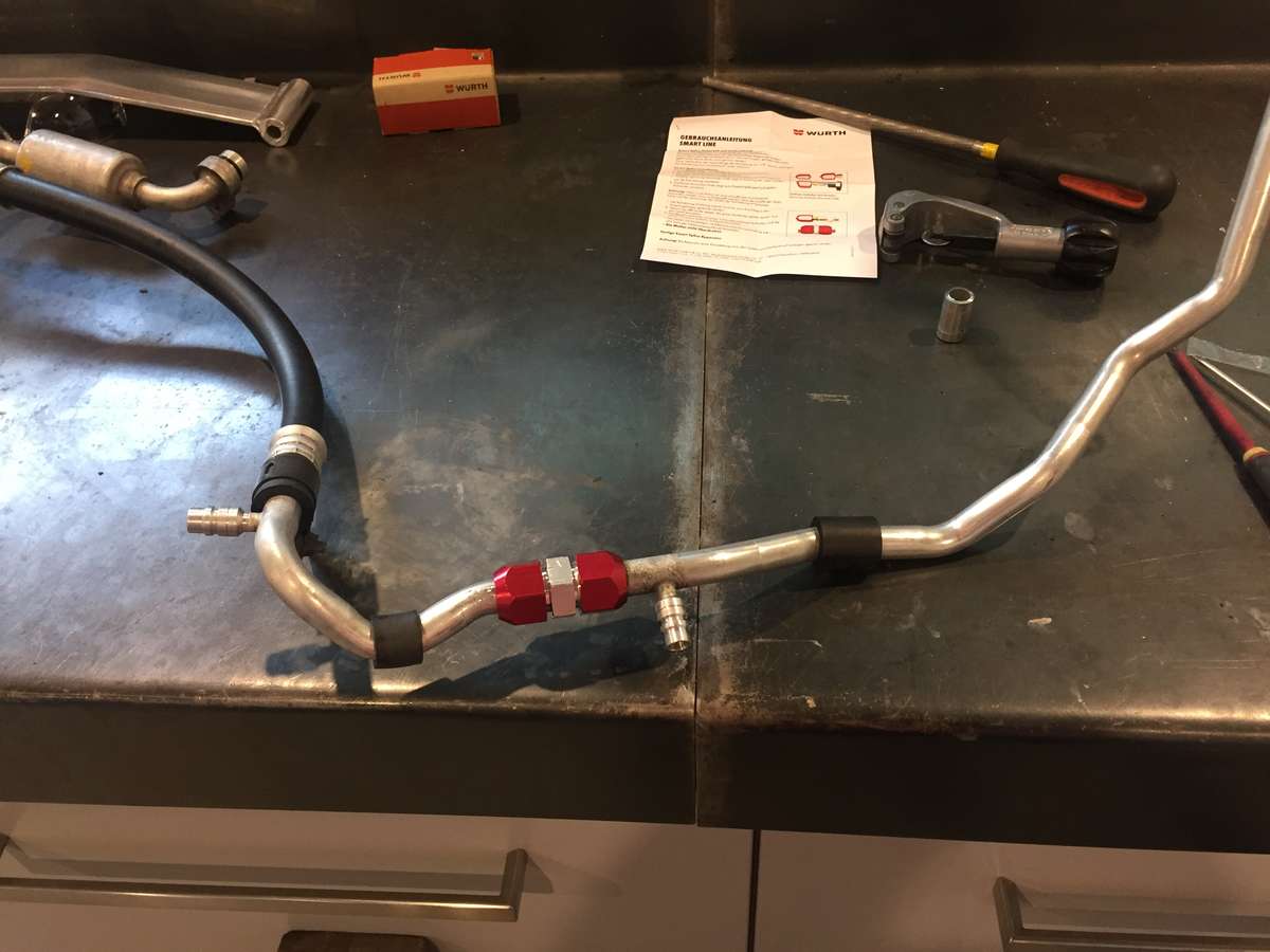

Ortega_9 Posted June 25, 2019 Author Posted June 25, 2019 back at it. I'm giving a wuerth a/c coupler a go, and trying to make one good pipe out of the two I have thats broken, and dosen't fit. so far I'we cut the low pressure rhd pipe i Got, put the coupler onto the piece with the hose, and now i'm trying to messure up the pipework from my lhd pipe that works, and fits... theese things are suppose to hold up to 150psi and so far it's been easy sailing. Quote
Ortega_9 Posted June 25, 2019 Author Posted June 25, 2019 And done. and I also did what I should have done the first time. Put some heat shield around the hose part that goes next to the bleeping hot turbo manifold.. Quote

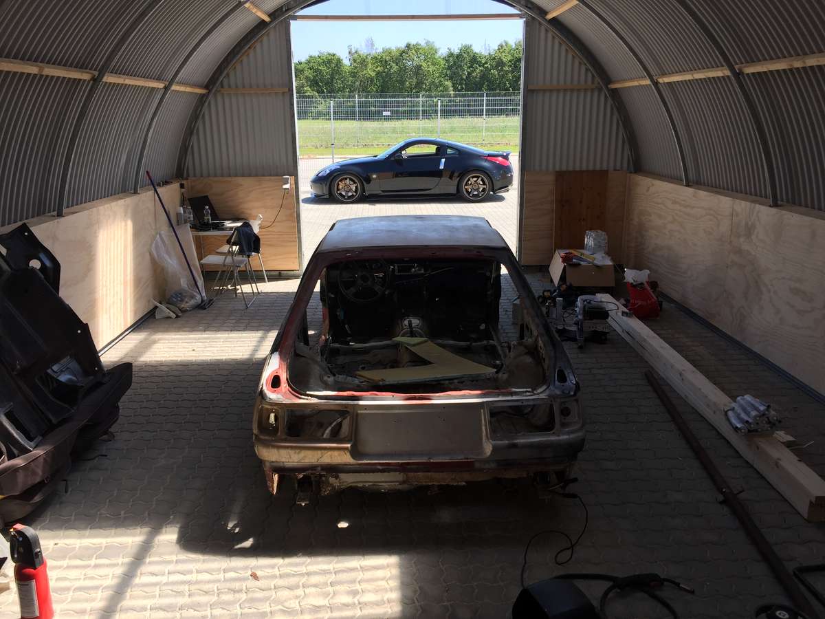

Ortega_9 Posted June 29, 2019 Author Posted June 29, 2019 (edited) Well not the most 350z post... but i'we bought a ae86 in need of some tlc and placed it in my spare parts unit to get rust and paint and all the dirty work sorted... But what a treat to get to drive the 350z dayli and woshing around and getting parts and so on when working on cars, no matter what they might be.... Edited June 29, 2019 by Ortega_9 3 Quote

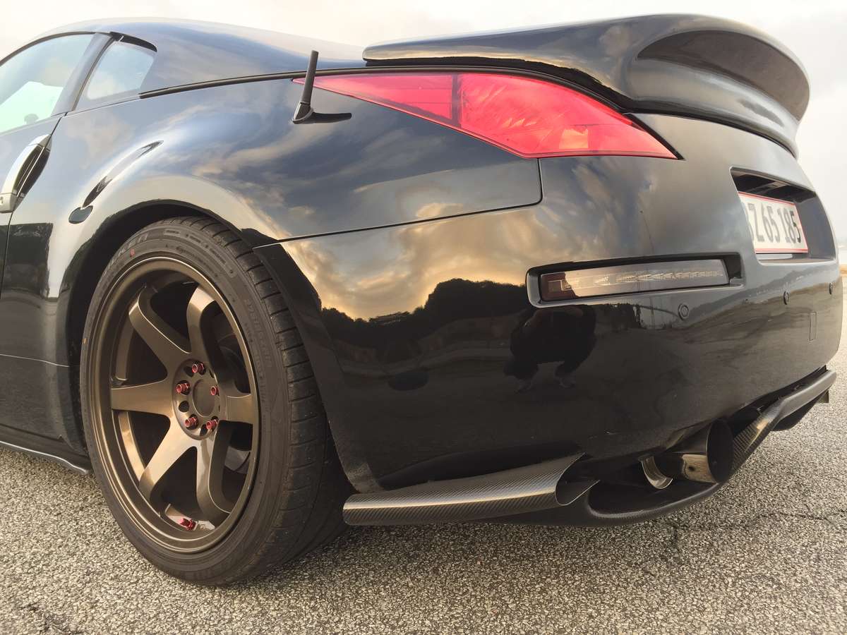

Ortega_9 Posted September 24, 2019 Author Posted September 24, 2019 Well it’s been a few month since last... but have been busy pounding the @*!# out of the Z.... 3 more steeetrace events done, and now having the launches dialed in, i’m doing roughly the same 1/8 times on my street tyres as on my MH Slicks. everything is running great. It’s been my dayli for everyday (when not having to Pick up the kids) Now there is a Danish MOT comming up shortly, and that might meen I have to build it back to Stock as you can’t run FI on a n/a car in Denmark.... other than that, the car is flawless... just went out tonight on the Way to the unit to work on the ae86 and stopped and toke Theese 4 Quote

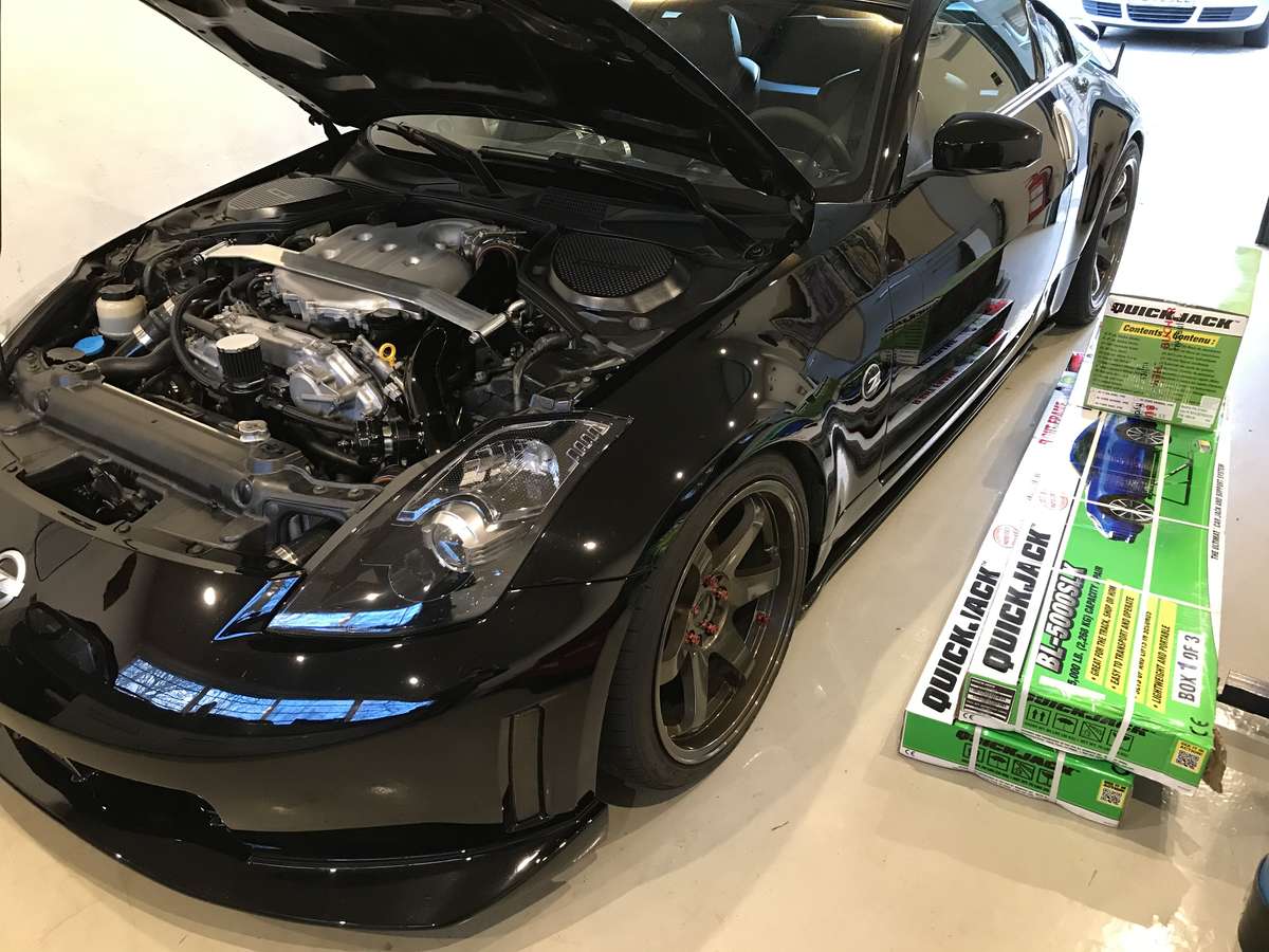

Ortega_9 Posted December 25, 2019 Author Posted December 25, 2019 Not much going on right now. I want to wait for my Quick Jack to get here before getting the car up in the air and starting ripping into it. but decided to do some more video of the work, please have a look. 2 Quote
Ortega_9 Posted December 29, 2019 Author Posted December 29, 2019 Merry Christmas Nissan. but the car was too low with the Carbon sidesteps on.... video comming 1 Quote

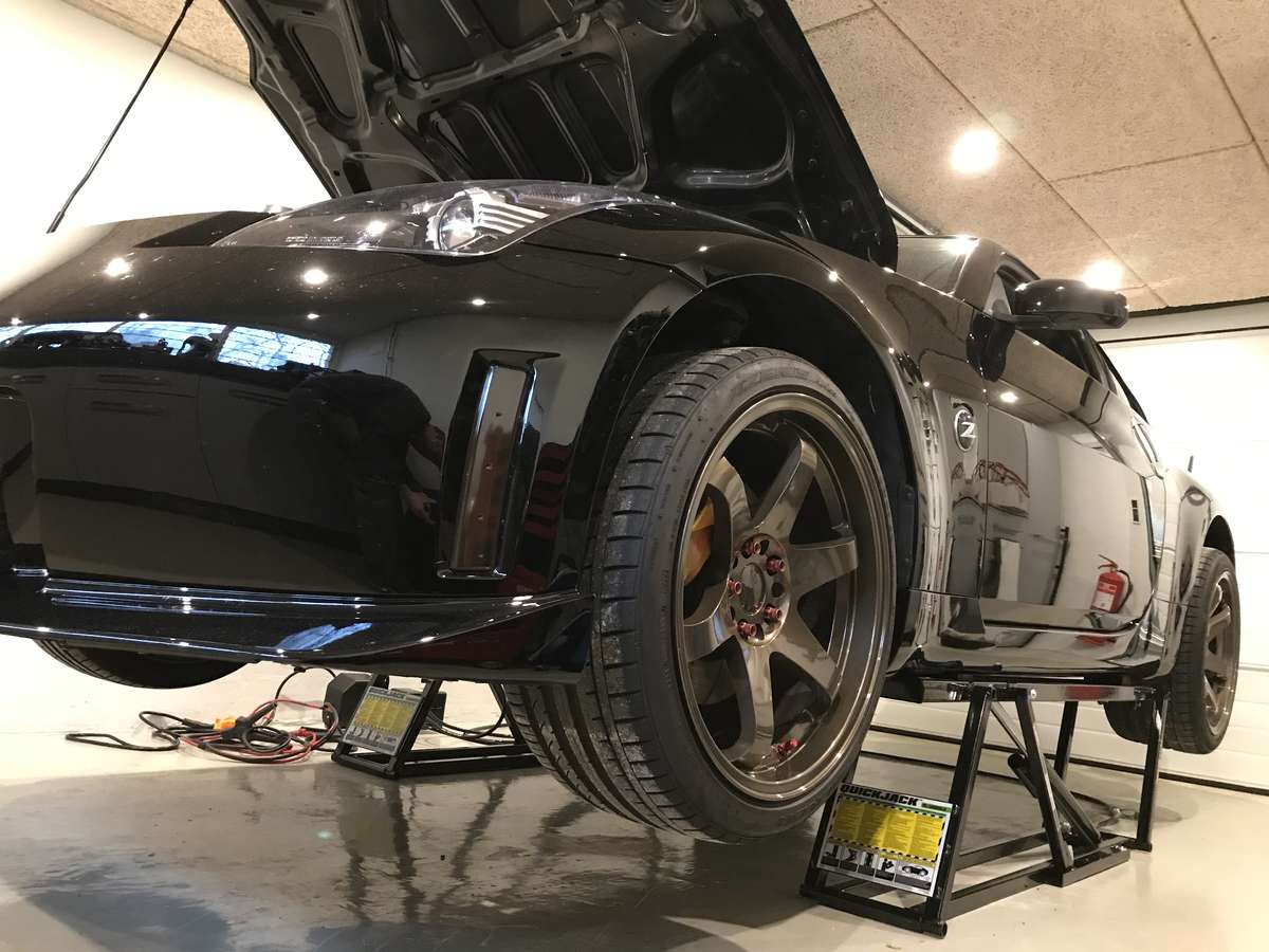

nissanman312 Posted December 29, 2019 Posted December 29, 2019 28 minutes ago, Ortega_9 said: Merry Christmas Nissan. but the car was too low with the Carbon sidesteps on.... video comming Ohhh nice I'd love a set of these quick jacks They look a great halfway house between an axle stand and a full ramp Quote
Ortega_9 Posted December 29, 2019 Author Posted December 29, 2019 They are. and with a low car it does take some time to get it onto jackstands. So this is soooo much faster and easy. If i had the headroom in the garage, I Would have gone the two post lift Way, but this is the best i Can do with the space I have. it actually lifts pretty “High” compared to the height I normally do on jackstands, so it’s gonna be kinda fun to get the transmission of. it does have two heights to lock onto, I Think the lower setting is better for reaching up top of the transmission. 1 Quote
