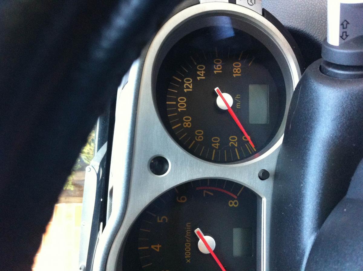

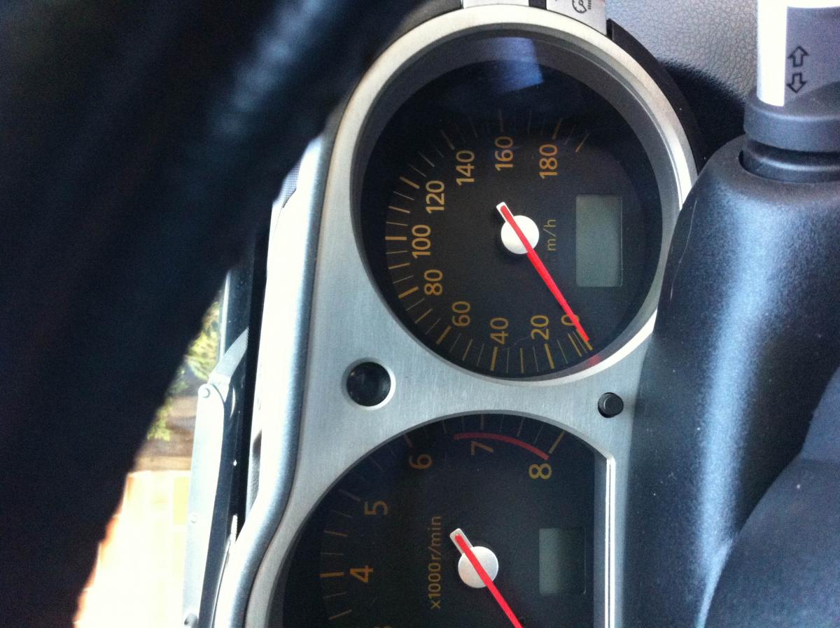

The car I drive is a JDM. When I purchased it from a UK trader, the speedo guage was in MPH (see below). At this time, the car was equipped with a Km/h to MPH speedo converter. This did not give me an accurate MPH indication so I had the old converter removed (thinking it was faulty) and replaced with another converter. MPH indication is still indicating about 8MPH too fast.
My objective is to get an accurate MPH reading from my speedo.
It may be a stupid question but if I were to remove the Speedo converter currently fitted, could anyone tell me if I will get an accurate MPH reading on my MPH Speedo despite the car being an import & calibrated for Km/h?
Would a good alternative be to remove my speedo and replace with one calibrated in Km/h with an additional MPH indication?
Thanks in anticipation for any help as this is driving me potty .
James forgive if me if I'm teaching you to suck eggs but you are aware there is a around a 10% tolerance on most speedos. For example on my 2014 Honda Civic when my Satnav reads 70mph the speedo is reading 77mph. My 350z is about the same so things is you will never get a speedo 100% accurate
I agree and understand this, but following my wife in her Ka at a fixed speed, the digital readout (indicating roughly the correct MPH but with Km/h indication) is a good 7-10mph slower than the analogue speedo indication. I have tried following this main speedo but i'm getting peoples headlights burning into the back of my head. There is an error and I need to somehow get it sorted. Thanks for your reply
