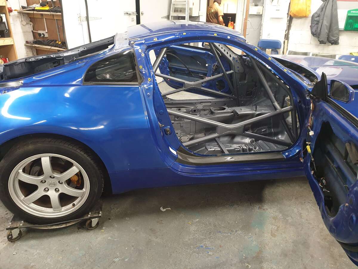

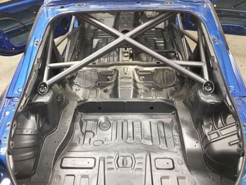

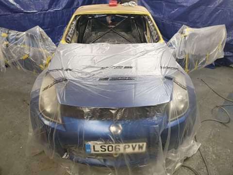

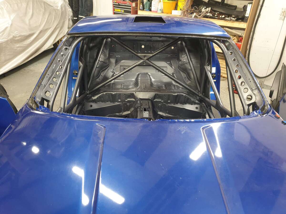

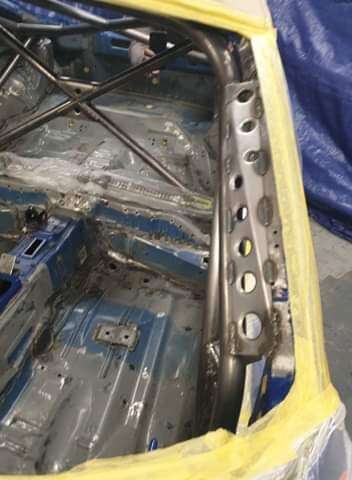

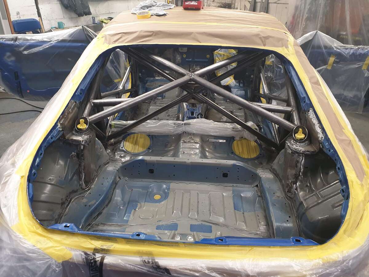

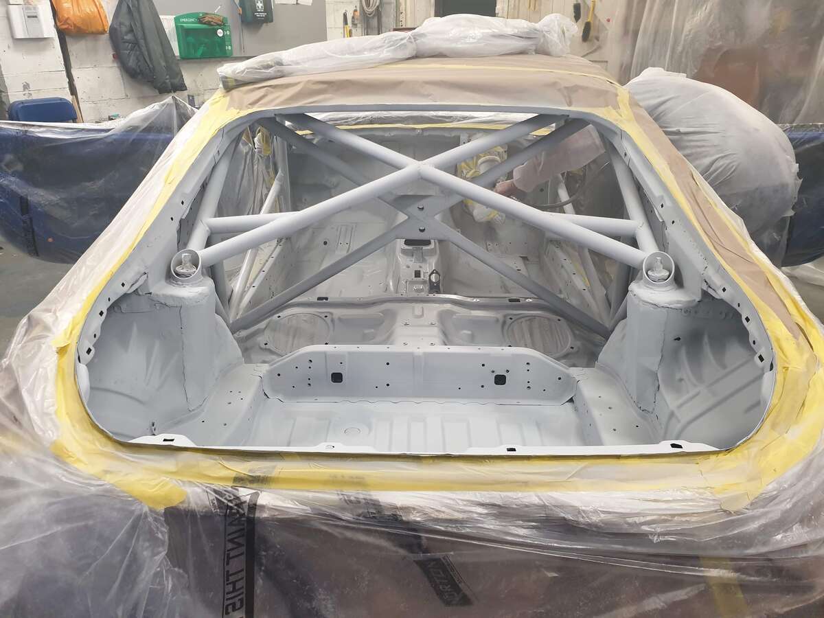

So this weekend was set as the big push on the interior, final welding, masking up, primer, flat off and shot the colour.....and we managed to get it all done! The car can now sit and harden this week before the reinstall starts finally.
New seats and harnesses on order and dash has gone away for its flock finish.
starting to look like a rally car and not a half baked project.

Looks good, impressed with the cage and its fitting.

Hi Woodzman,
Thank you for the post, I am really happy with the cage install. My friend owns a metal fabrication business and did a superb job for me.
My brother runs a BMW E36 328i stage car and we’ve run a few other cars previously, we often do Bovington etc but auK rallies are getting harder and harder to find. We have serviced a fair few times out in Belgium and run on the Monte Berg rally in 2019. We had planned a few Belgium events this year but as we know they all got canned! We did manage a run on the Cotswold Stages but it would have been better in a submarine!
The 350z is being built to FIA Regs even if it does get an MSUK log book and is intended for Belgium tarmac events. To be fair I have always wanted to build a 350z after seeing them run in the 350z abroad but it’s only this year that has seen the MSUK create a category for production cars with engines larger than 3000cc multivalve. Unfortunately the Cat 3 rules to limit the amount of mods but that’s also good for the bank account lol.
As for final drive, I am looking at a 4.3 with a plated slipper, want to get it into the 115-120mph max territory plus lighten the flywheel etc.
