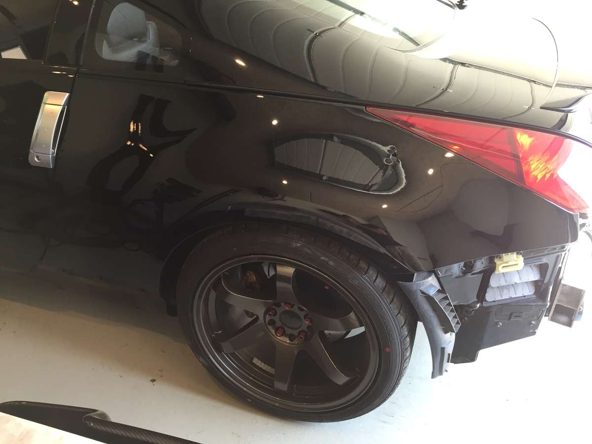

Ortega_9 Posted July 11, 2018 Posted July 11, 2018 Just took my freshly build car and decided that i wanted the rust in the rear arch gone. So put a grinder to it to see how bad it was.... and it was a bit worse than i had hoped for. It seems that the 2 layers of metal had opened between the spotwelds and held water. So it had corroded from the inside, and ran down between the metal, so bad that the outside was only the tip of the iceberg, and we ended up cutting a 10-12 inch piece out and had to make a new one from scratch. welded it in and tinned it up. Then paint is booked for monday, and getting both rear quarters painted as we also folded and rolled the arches. Originally hadn't planned on Rolling the arches as i have no clearence issues, but wanted to see if there was any rust between the spotwelds on the other side aswell. both sides had beginning rust issues. So i guess it's a problem on the 350z 1 1 Quote

Ortega_9 Posted July 15, 2018 Author Posted July 15, 2018 And all naked and ready for paint. had to get rough with the antenne to get it off. The aluminium had ceased pretty god. i'll have to get a new one. and pulled the Stock sideskirts also, and found some surface rust that i will fix before putting it back together. there's always something! Quote

Ortega_9 Posted July 19, 2018 Author Posted July 19, 2018 And in the booth, with the clear coat done. 1 Quote
Ortega_9 Posted July 21, 2018 Author Posted July 21, 2018 And back in the stable. really happy with the work. it's pretty hard making a new piece for the fender Line from scratch, but looks like it's about right. now i need to put her back together, and hopefully enjoy a few month of summer. 2 Quote
