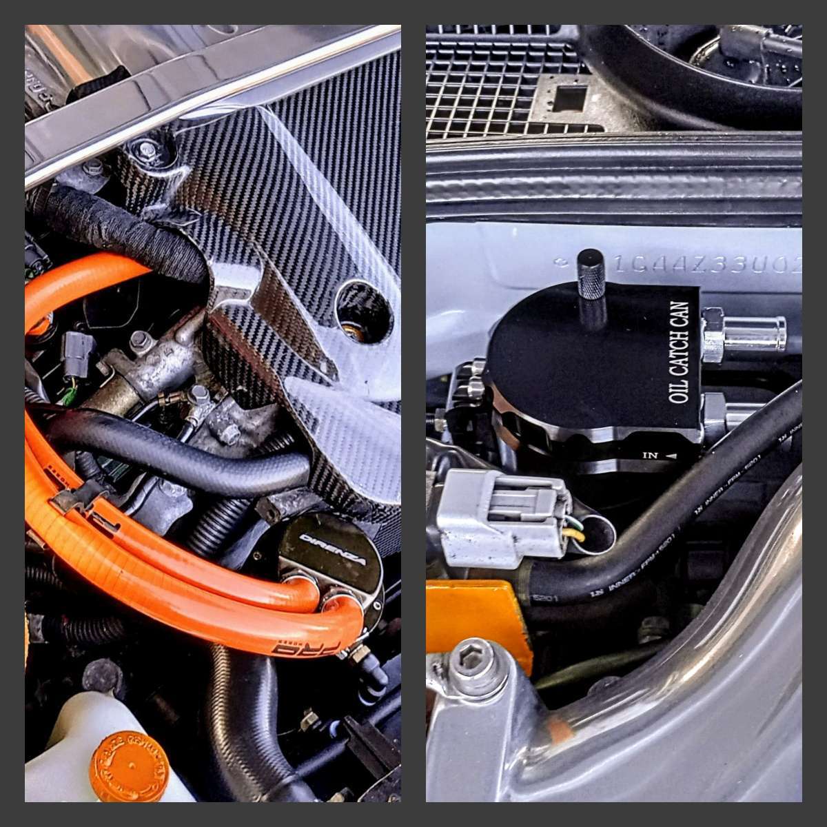

Cosmic73 Posted July 6, 2024 Posted July 6, 2024 I eventually got round to fitting my catch can this morning which was simpler then I expected. If anyone has a moment could they look at the pics below and confirm it's plumbed in right? Quote
davey_83 Posted July 6, 2024 Posted July 6, 2024 Hoses on the catch can need to go the other way round. So from the PCV valve to the IN on the catch can. There's a baffle filter on the underside of the catch can lid for the outlet port, which you want to plumb to the plenum. Quote
