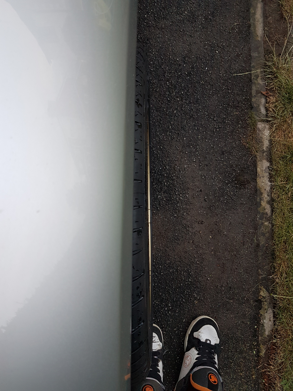

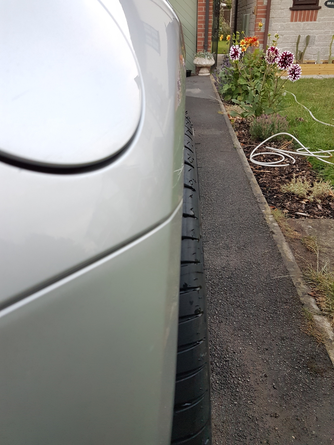

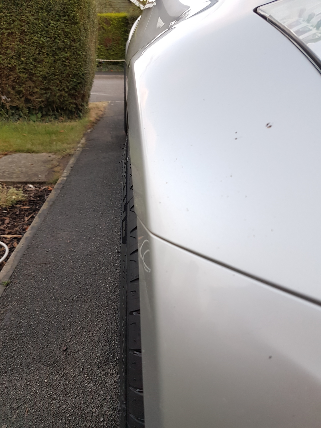

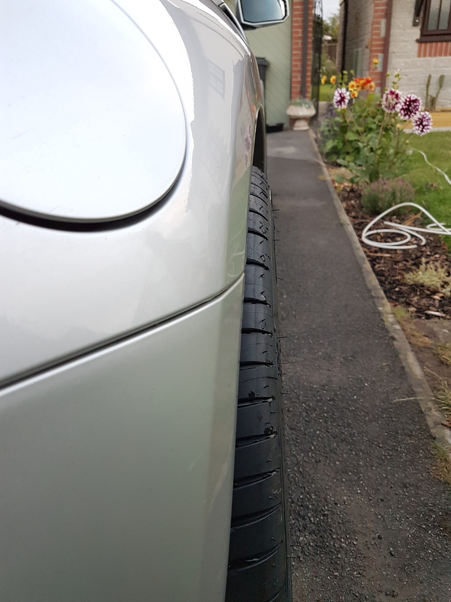

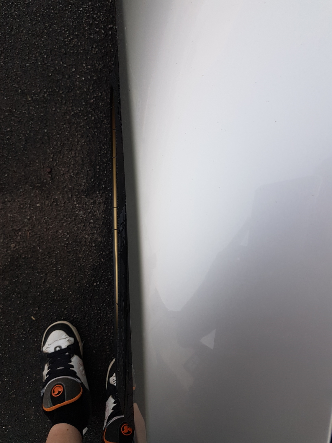

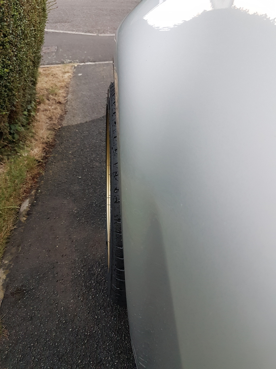

Anyway, below are some pics, hopefully it gives you a good idea of how the wheels are.
First 4 images are rears, others are fronts =)
I'd imagine given the spacer sizes that the front would sit 10 to 15mm inside the arches, and the rears maybe 10mm inside the arches. Spacers at the moment are either 20 or 25 front, and 30 rear.
I was more wondering if the wheels would still clear the brakes, at least that way you can measure exactly what spacer you'd need as the wheel would be on the car.
Ah I see, they should fit ok, they came off of a Z. I'll have a check on clearance later when it's not raining and post back my results =) Wish I knew what I did wrong when working out the offset, it's annoying me, I was almost certain I had it right or I'd not have ordered the spacers.
