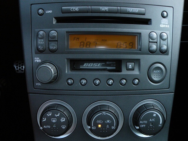

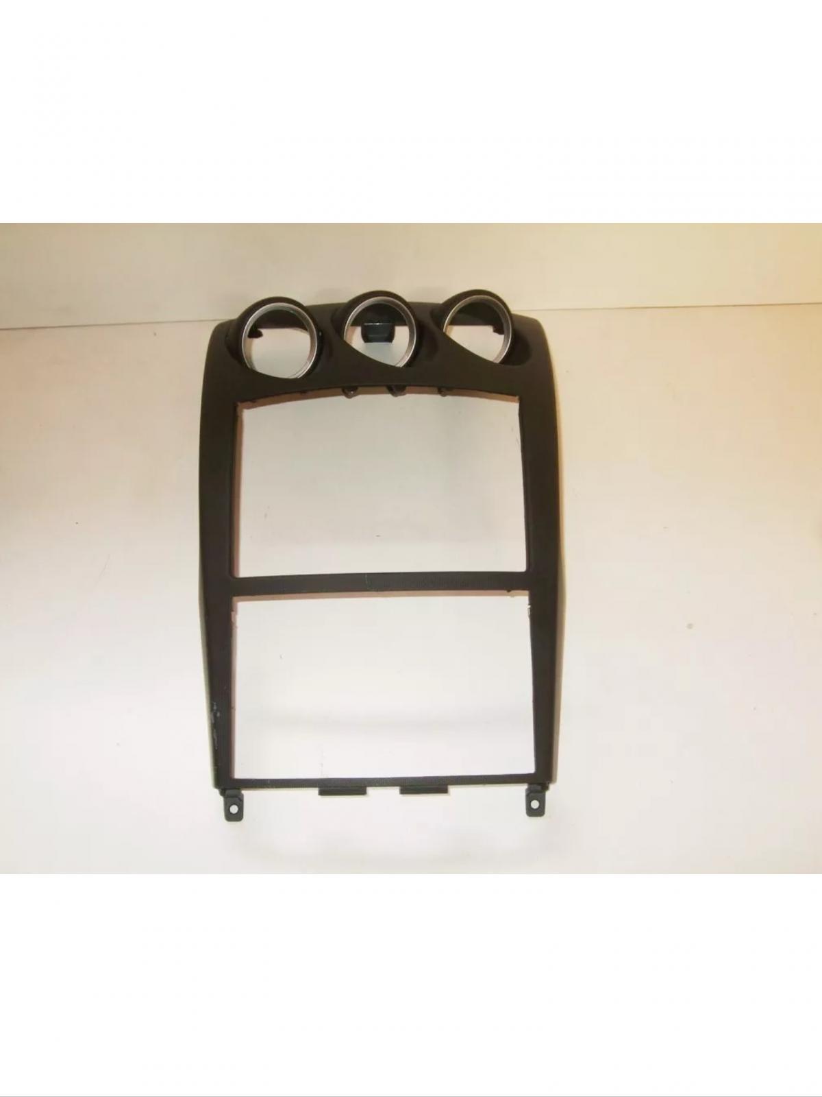

shueb.c Posted August 30, 2016 Posted August 30, 2016 Hey All, So I want to install an iPad mini myself as a complete replacement to the BOSE head unit. I want to completely remove a standard car audio head unit. Is this possible and are there any guides on here to help me with the wiring - or is there a connector/wiring that I can buy off the shelf that can hook up the iPad to the existing 350z wiring loom? Ps. I do not want to change the existing Bose Amp, and speakers - I just want to add iPad mini/iphone/ipod music connectivity - ideally an iPad mini. I know I can just buy any bluetooth stereo as a simpler solution to connect iPhone - but I prefer the clean look of an iPad screen. I did just buy the Grom audio adapter but only just discovered it isn't compatible with the Bose system. Thanks guys Quote
