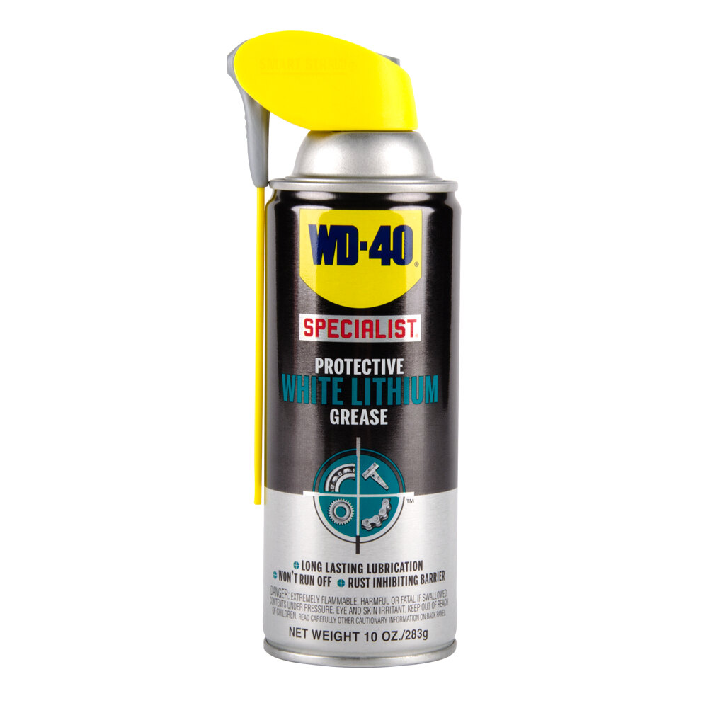

BulletMagnet Posted February 27, 2014 Posted February 27, 2014 (edited) Had the same issue a couple weeks back and sprayed the bonnet latch mechanism with WD-40 Lithium Grease spray. On initial spray you could already see the light rust oozing out from the gaps, which had effectively seized all movement. Edited February 27, 2014 by BulletMagnet Quote
