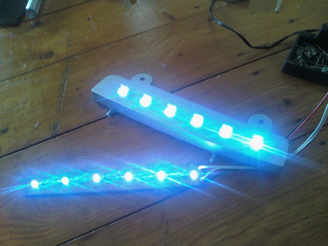

Husky Posted August 8, 2009 Posted August 8, 2009 Hey mate, for some reason i cant PM. prob my tinternet bu**ering up again. Anyhow, ive nearly finished sorting the LED sidelights for you, ive put brighter 3mm white LED's in replacing all the stock ones to keep it looking even there was alot of corrosion leading to the LED's blowing. ive also replaced one sides wires as they were completely black with corrosion aswell. due to the slightly brighter LED's installed i'll need to fetch some 1/2Watt resistors to replace the current ones which will burn out at 12V. I'll seal it up properly aswell to stop a repeat of the corrosion when im done. Yes they are defo white, its the camera. Regards, JM Quote

Husky Posted August 16, 2009 Author Posted August 16, 2009 These look awesome! would love to see a pic when fitted! I am not fitting them as I already have some LED reflectors in. Husky has just replaced the LEDs for me and sorted them so I can sell them on. indeed but with a little electrical tape we can all imagine, and no they arent blue really btw grant, i have fitted the new resistors and it all works fine now Quote

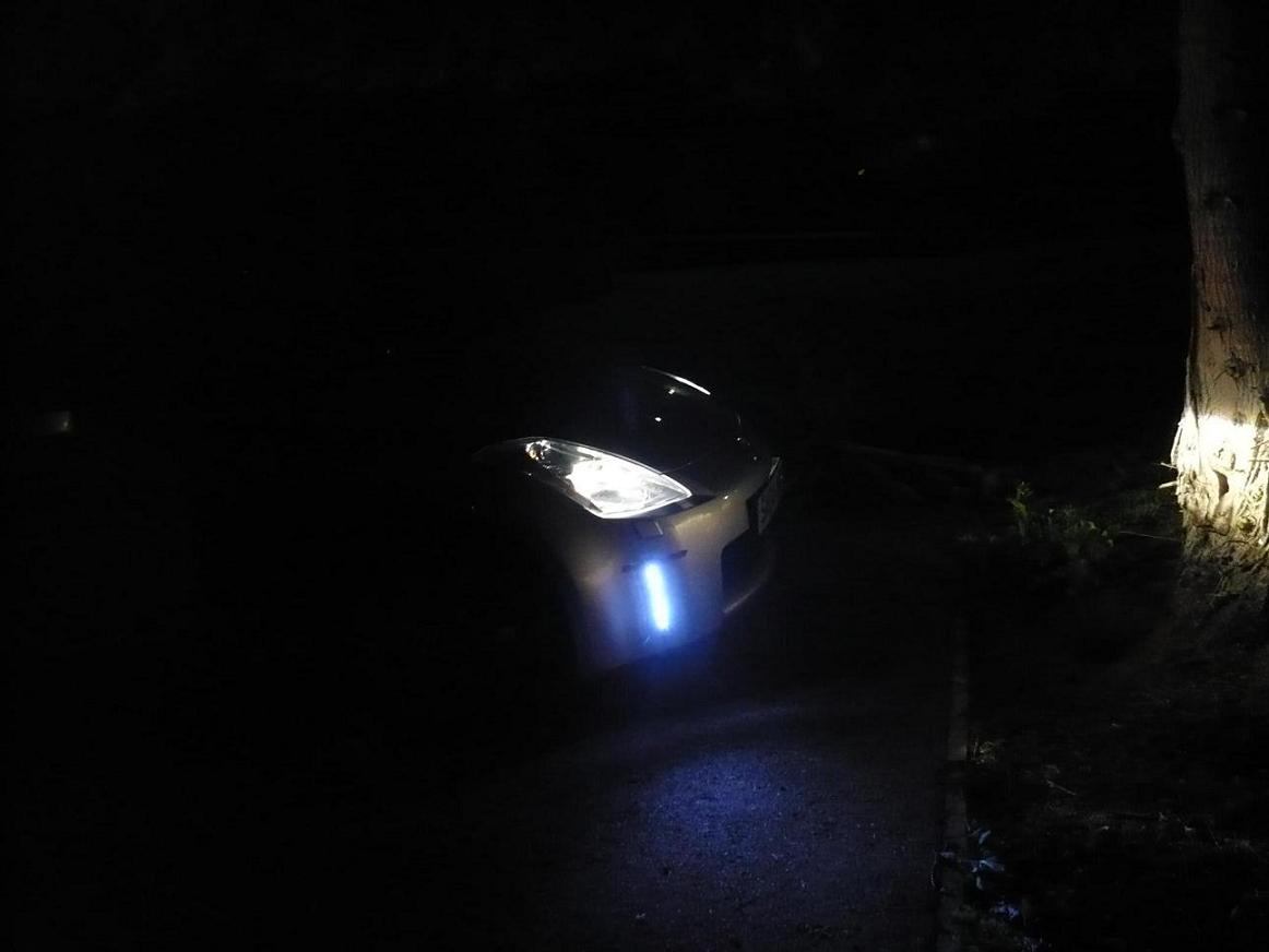

helimeddaz Posted August 18, 2009 Posted August 18, 2009 They look great m8, Did mine in orange to match the car. Mine are a bit more subdued in the flesh that the pic shows. Had to do a very slow shutter speed on the camera to get them right without flash for the pic. Technical I know. The Z badges look good too. Quote
BladesGrant Posted August 18, 2009 Posted August 18, 2009 They look great m8, Did mine in orange to match the car. Mine are a bit more subdued in the flesh that the pic shows. Had to do a very slow shutter speed on the camera to get them right without flash for the pic. Technical I know. The Z badges look good too. I have white in the reflectors and blue in the Zed badges. I think they look great. Quote
