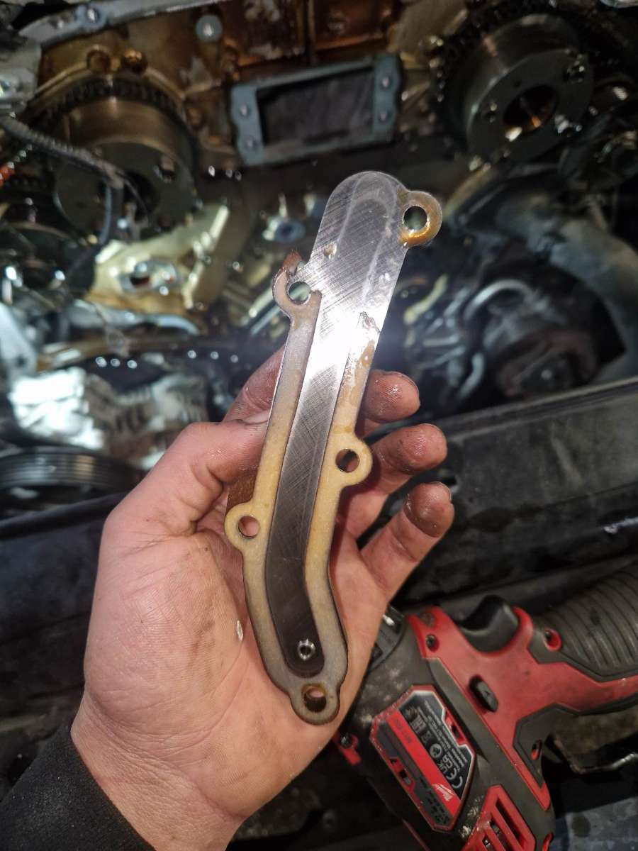

Tomato Posted May 21, 2023 Posted May 21, 2023 Looks like my time has come and the gallery gasket has decided to pack up with PSI starting to reduce, now sitting at around 22ish when hot idle from around 29 a couple of months. Couple of questions, any one had one done recently in Yorkshire region? And recommendations? What price did you pay, assuming looking at a grand, will get parts from Horsham probably with new bolts. Assuming it not likely to be anything else, no leak, oil topped up etc? Anything else worth changing while the cars is in bits? Thanks Quote

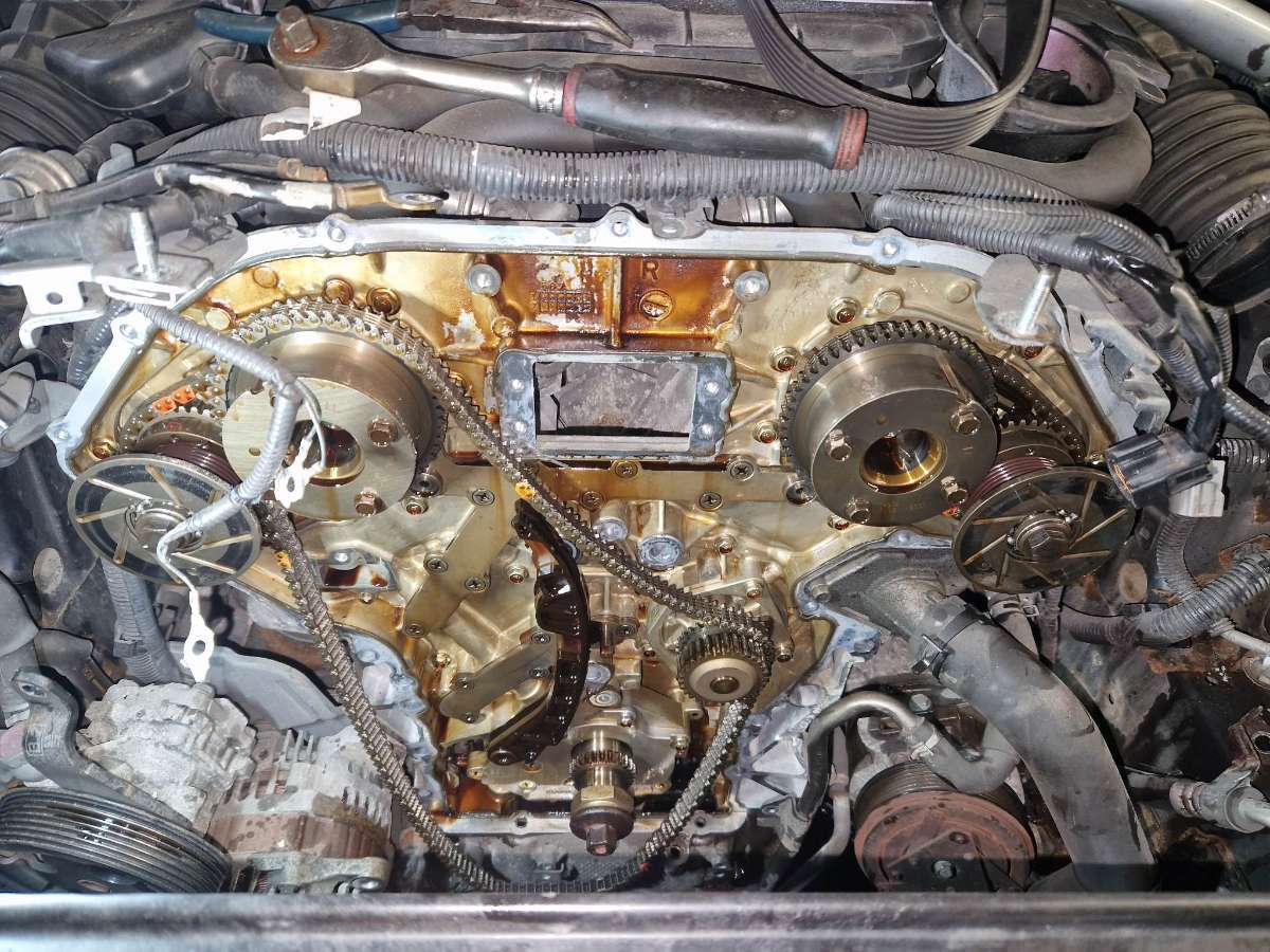

Tomato Posted May 31, 2023 Author Posted May 31, 2023 The process has started, hunch was right, not terrible and pressure was fluctuating but it now being done, hopefully her back tomorrow 👍 2 Quote
