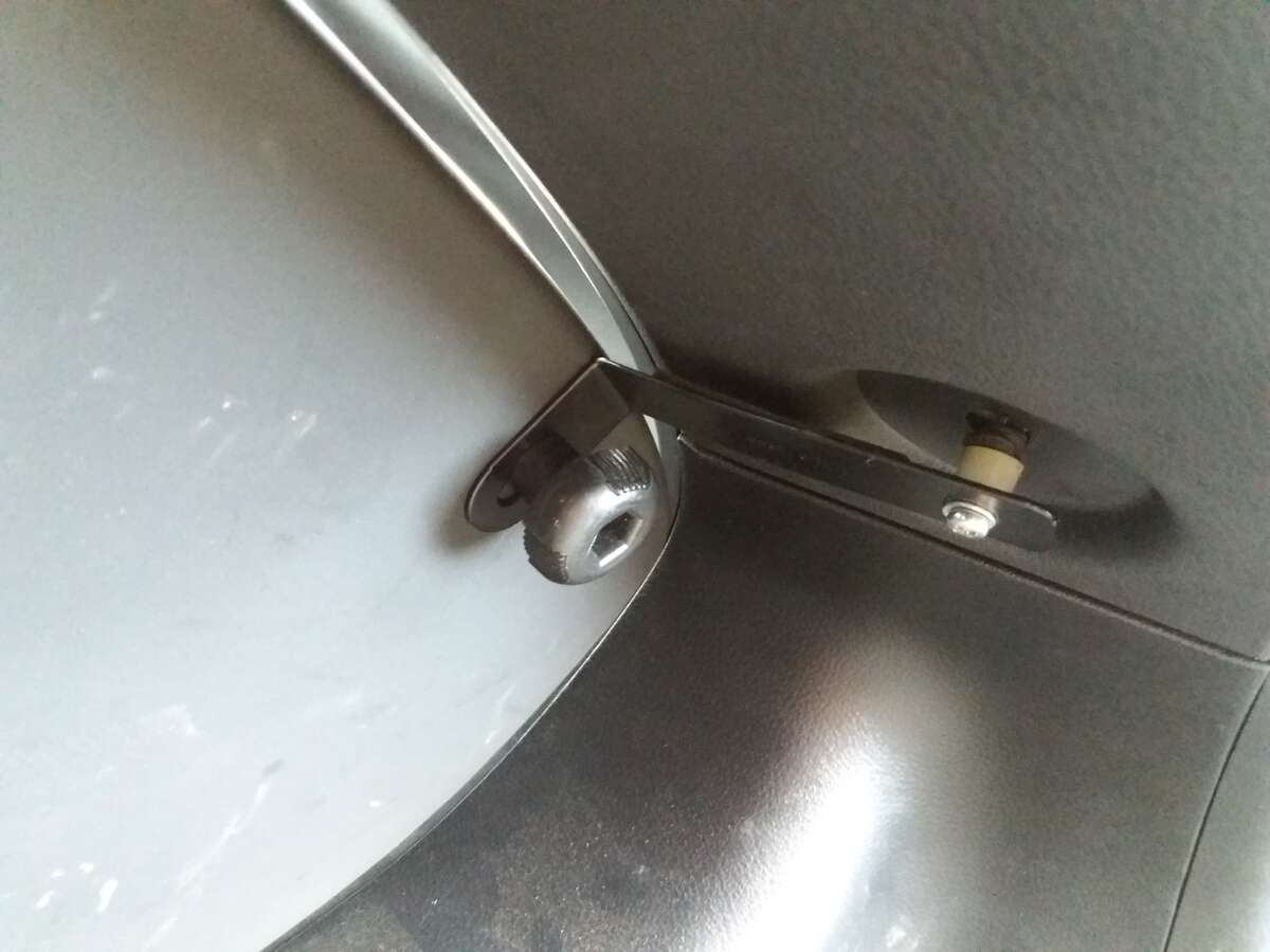

Innes Drummond Posted June 26, 2020 Posted June 26, 2020 Hello can someone help the fixings from under the brace for my boot divider have come away and I can't seem to get them to go back in any help would be great cheers Quote
Innes Drummond Posted June 26, 2020 Author Posted June 26, 2020 Think it's factory I only got my z a few weeks ago ....did you have holes under the strut to put fixings in ? Quote

Innes Drummond Posted June 27, 2020 Author Posted June 27, 2020 This would be great I ordered ones of ebay think it was m4 x11 0-2 grip Quote
Innes Drummond Posted June 27, 2020 Author Posted June 27, 2020 also do these go in with the lip inside the strut tower ? Quote
Innes Drummond Posted June 27, 2020 Author Posted June 27, 2020 6 hours ago, ZMANALEX said: These work; https://www.ebay.co.uk/itm/361830776095 Do you use these with the wee white spacer on the existing or just screw bracket straight to it ? cheers Quote
ZMANALEX Posted June 27, 2020 Posted June 27, 2020 2 hours ago, Innes Drummond said: Do you use these with the wee white spacer on the existing or just screw bracket straight to it ? cheers Use a spacer if you have a recess. Quote
Ben–350Z Posted June 28, 2020 Posted June 28, 2020 I used those rubber things on mine, too. IIRC had to use a small flat blade screwdriver to stop them spinning at first. Quote
Innes Drummond Posted June 30, 2020 Author Posted June 30, 2020 On 26/06/2020 at 22:32, ZMANALEX said: These work; https://www.ebay.co.uk/itm/361830776095 Hello one worked and one failed ....should I try to push the fixing into the spacer first ? or just place in front then thread the bolt through? thanks Quote
ZMANALEX Posted June 30, 2020 Posted June 30, 2020 This is how I fit them: https://www.google.co.uk/search?source=hp&ei=7RUCXrXTCMLkgweY176ABw&q=how+to+fit+a+rubber+well+nut&btnK=Google+Search#btnK=Google Search&kpvalbx=_Mm_7Xsi3FK2j1fAPuq-jcA32 Quote
Innes Drummond Posted June 30, 2020 Author Posted June 30, 2020 excellent m8 so smaller diameter in first thanks Quote
