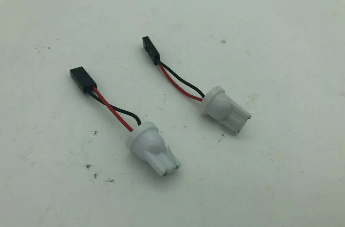

This is a picture of the sidelight adapter i used (i only used one of the drivers side sidelight). Which is pretty straight forward and should be fine to use (they are used for led halo sidelight wiring a lot).

Hi @davidv10, looking at your two adapters I notice their contact wires aren't bend in an identical fashion; might one of them simply not give electrical contact when plugged into one of your T10/168 sockets (front parking light, or rear license light? Swap over the adapters on a working light and see if the other suddenly doesn't work anymore. Can't think of any other good reason, given that the fuse is fine.

I have since removed the adapter and replaced both sidelights with normal T10 bulbs. And still nothing is working other than the passenger side taillight. So i must have blown/damaged something if back to stock there are lights still not working?
