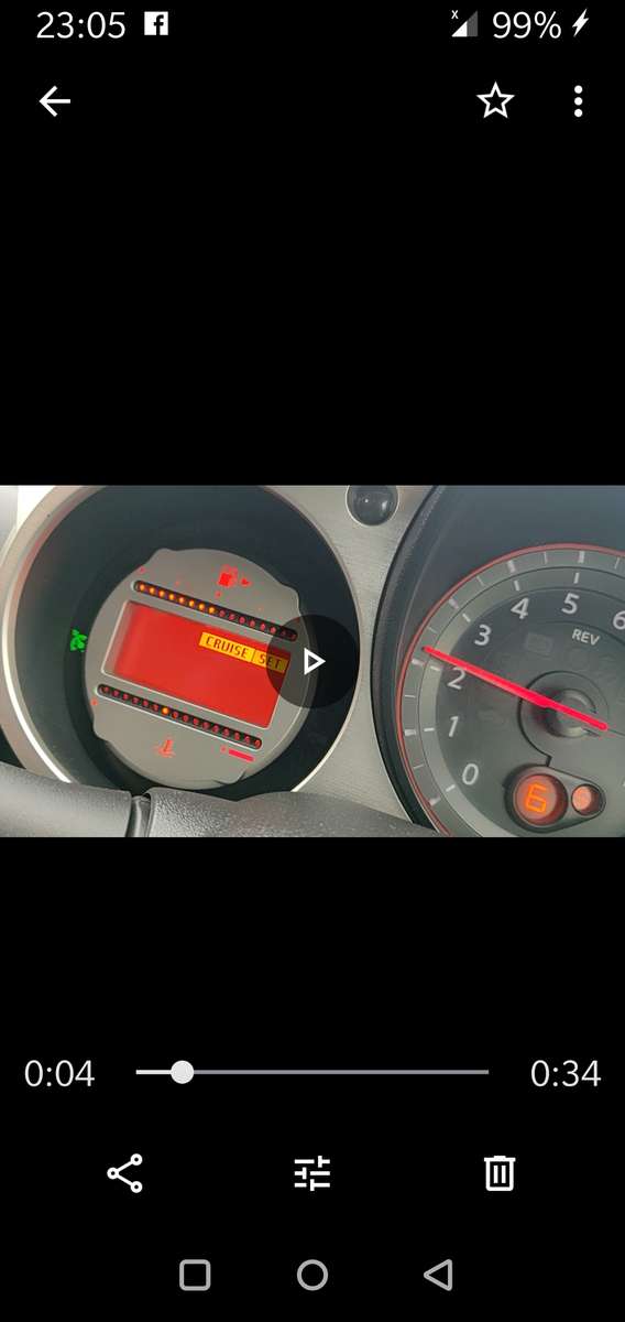

Gbxtreme 2 Posted April 24, 2019 Share Posted April 24, 2019 (edited) Ok I never had this issue before as I had never used cruise control but decided to use it the other day due to traveling so once I started to use the cruise control which was fine in operation and then disengagement, it was a little bit later this happens the cruise control icon flashes and so does the set word but cruise word does not flash, see picture! the cruise control limiter button etc will not do anything the only button that does is the one that you change to see how many miles left in your tank etc etc "top left of steering wheel" now when switching the car off for a short while and switching it back on the icon disappears but then sometimes comes back definitely in the last few days when it's been warm it's been quite often so I'm a bit lost with it, if anyone had this issue before and you know exactly what it is I would much appreciate help. Thanks Edited April 24, 2019 by Gbxtreme Quote Link to post Share on other sites
teejay 61 Posted April 26, 2019 Share Posted April 26, 2019 Might sound mad but check out your coolant levels is not to low or high Quote Link to post Share on other sites
Kev T 222 Posted April 26, 2019 Share Posted April 26, 2019 This is more likely to be the Clutch/brake microswitch either being faulty or out of adjustment assuming the same set up as the 370. Quote Link to post Share on other sites
Gbxtreme 2 Posted April 26, 2019 Author Share Posted April 26, 2019 1 hour ago, teejay said: Might sound mad but check out your coolant levels is not to low or high Fluid levels are good Quote Link to post Share on other sites
